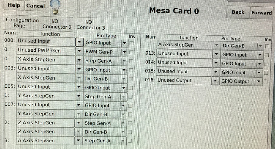

Making cautious progress with pncconf, but I do have questions...
When I loaded the firmware, I chose 7i92_G540x2D. That matches the numbers of both the Mesa and Gecko boards. I've pressed on with 5i25 + G540x2 as board and firmware choices in pncconf.
From the "x2D", I assume that the firmware will support daughter boards, but this is a basic XYZA stepper-based Taig mill, and I'm only running one parallel cable from the P1 conector on the 7i92 to the G540, no daughters.
Apart from the board and firmware choices, I've left the defaults on the Configuration tab. When I clicked the "Accept" button, tabs for I/O connector 2 and 3 appeared.
I'm not sure what to do with these tabs. The help file says many things about them, but I have not been able to parse out the bits I need, for my simple little scenario.
Looks like one of those tabs should rule (but which?), and some of those options should probably say something other than "Unused", but which? And what?
Thanks for your help!

Those are the connectors on the 5i25 or 7i92, there you can choose the stepgens for each axis and on the next pages you can also test if the motors are moving and tune the scale to fit your setup. Also chose the I/O pins as needed, i forgot how G540 pinout was, it was several years back.Apart from the board and firmware choices, I've left the defaults on the Configuration tab. When I clicked the "Accept" button, tabs for I/O connector 2 and 3 appeared.

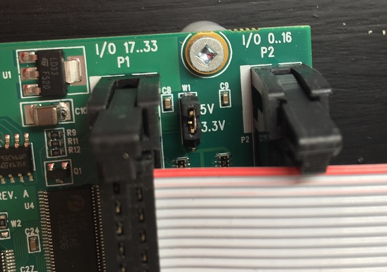

The board has connectors P1 and P2.
The tabs are Connector 2 and Connector 3, so the numbers don't match.
I assume that the connectors on the board are SUPPOSED to match 1:1 with the tabs. If that's correct, any idea which tab is the one that governs P1 on the board?

On the page where you chose 5i25 and the G540 under it, below set the PWM to 1, stepgens to 4, encoders to 0.
This way you have nothing to chose on the "IO connector 2" page and it wont complain when you try to save the config.
Then on the "IO connector 3" page you will have only 1 pwm and 4 stepgens, notice the number in front of stepgen, 0 is usually for the X axis, 1 is for the Y and so on, but it does not have to be exactly like that as you can also have 2 Y or 2 X axis. This is if you have 4 motors, if you have three, set only 3 stepgens, not 4. You can also set the inputs and/or outputs, but that can also be done later by editing the hal file.
First lets get you moving.

Pix attached - is this what you meant? The Taig is a simple machine - just one motor moving each X,Y,Z axis, plus a 4th motor for the Sherline rotary table as "A", so no multiple motors.
I do not understand what those tab numbers (000 thru 016) refer to (virtual pins maybe?), but if I look at my 7i92 board, I'm wondering if I should move my cable from P1 to the P2 position, as that position on the board is marked "0..16". Thoughts?
