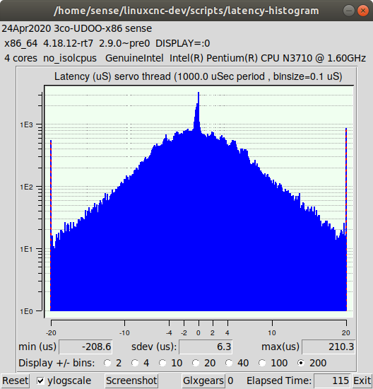

Then also we have Udoo X86 Advanced Plus single board computer running Ubuntu 18.04 that became my headache for the last week. I was able to build a linux-4.18.12-rt7 kernel, it has some latency issues spiking from time to time. Good news is that I can get LinuxCNC 2.9 and have some support for our Mesa 7i95. Bad news after trying SMI solutions I am having WiFi issues and it's important that wifi works also it has some errors I could not fix. At this point in BIOS everything is disabled as much as possible.

Also, when doing latency tests, use
latency-histogram --nobase
as you do not need the base thread and it can affect the servo thread.

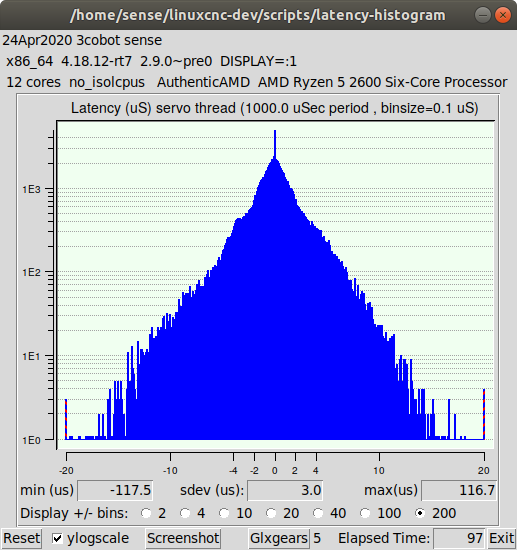

Thanks, will try proprietary drivers and report back. Our setup is: ASUS TUF X570-PLUS motherboard with Ryzen 5 2600 and GTX 1650.
I ran latency-histogram --nobase, but can you tell me, why I don't need a base thread?
6 years 6 months ago #165399
Replied by tommylight on topic Debian or Ubuntu on Udoo x86 or new computer?
That latency is still usable if it does not jump higher.
Ne need for base thread as you will be using a Mesa board and they only require servo thread that usually runs at 1ms.

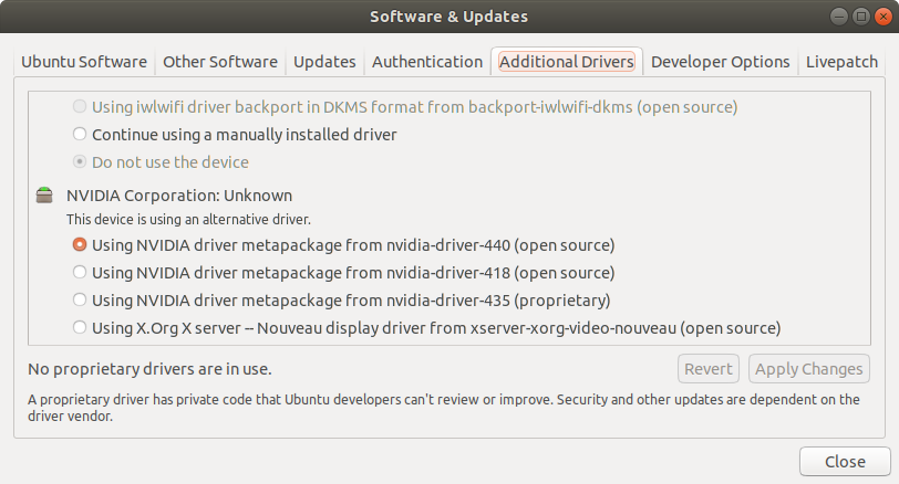

So I got to test latency on our main GPU:
But running glmark2 i get score around 400 and usually better on rt kernel and google says for GTX 1650 in glmark2 2000 is a normal score. Tested with nvidia-driver-440 and xserver-xorg-video-nouveau
With single glxgears window I get 2000+ FPS
Apart from that in the app we need GPU for it takes around 10 seconds for a render, when normally it's in ms.
So clearly GPU is not working, what's strange, that switching between rt kernel and generic does not seem to change anything glmark2 benchmarks stay more or less the same. What can be causing such behavior? Is it that RT kernel crashes the drivers?

Might be,.AndrejsA wrote: Is it that RT kernel crashes the drivers?
