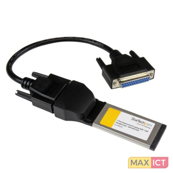

Hi there,
I am in the process of migrating my current LinuxCNC installation of my Deckel Fp1 to v2.9 on Mint 20..
That requires a 64-bit machine architecture, so I needed a different PC for that, and am considering to use an old Thinkpad T410 laptop .. (I know laptops are not perfect for CNC, but sofar the test installs look ok, and my speed requirements are not extremely high).
Ultimately I want to use Mesa Ethernet cards for the hardware, but since some are out of stock, I want to start with my current parallel port setup.
I ordered a Docking Station with parallel port, but that appears to be the wrong one . (subtle connector difference between a T400 and a T410 :
So another option could be an "ExpressCard 34 with parallel port". That is supposed to connect to the PCI bus inside the laptop.. See sample picture in the attachment...)
Is anyone having any experience with a setup like this on a LinuxCNC machine? Would that work ?
Thanks,
Frans

I did have PCMCIA cards that worked perfectly with LinuxCNC, so the 34 should theoretically also work.
But i am afraid that the Lenovo will be useless as i have X220 and T420S and they are useless except for simulation. The latency on them is terrible due to too much power saving stuff.

Last year I bought a serial ExpressCard 34 card for my T530, which shows as a USB serial port. So just make sure it is an actual PPort and not a funky USB to PPort.
I get pretty good latency on my T530 using Mint 19.2 and 4.19.106-rt44-lcnc PREEMPT kernel.

For the parallel port question: I did purchase an expresscard but cancelled that purchase since that model was still using a USB connection to parallel.
I ended up with rebuilding a desktop PC, using a spare motherboard with a 64-bit i5 processor on it. I am currently in the process of configuring and testing LinuxCNC 2.9 with Mint 20 on it. Still some smaller issues to solve.
