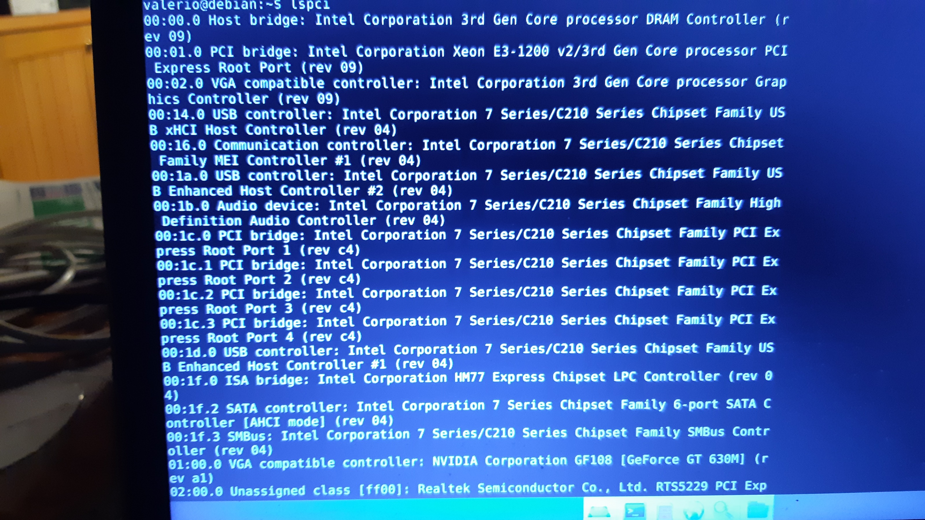

Hi everyone,
I tried to install linuxcnc 2.8 on my laptop.
The installation went well but, at the beginning when the double boot goes (as a first choice on linuxcnc), all my usb ports and the wifi does not work any more.
All the usb ports seems dead.
I tried different solutions, like modify the grub boot loader, trying to enable IOMMU but nothing seems to work.
If I reboot and go on windows10, everything goes back to normal.
Any help would be appreciated

Unless you give a bit more concise information regarding your hardware it's like wondering around in the dark with your eyes closed and a welding helmet on.
What model is your laptop ?
What ISO did you use to install ie: version ?
Do you know what exact model of a wifi adapter you are using, how is it connected ?
If you runin a terminal in debian what is the output ?
There is a chance that the version of linux you installed does not support your hardware, very rare nowadays but can happen. Sometimes Debian doesn't include "non-free" firmware blobs that some wifi adapters need.

Hi thanks for you answer.
My laptop is a lenovo E430.
The iso image I used is : linuxcnc-2.7.14-wheezy.iso
I ve burned on a CD and then I upgrade to version 2.8.
I hope you can see the output from the photo.
Thanks for your help.

Try the Buster ISO.
Some tests have been done with that laptop and it doesn’t appear to be a good candidate for Linuxcnc. Tho your mileage may vary.
There also is a Linux Mint 19.3 iso available. Links can be found under “Installing Linuxcnc” section of the forum.

I would say Wheezy is far to old to have support for your laptop hardware. The 2.7 ISO you used is no longer the release version of Linuxcnc. Download the current 2.8 release ISO on Buster and try that. I suspect it will solve your problem. If not try Mint. It works on most laptops.

Thank you very much again for your help.
I will try buster iso and if it does not lead to any result I will have a go with the other option.
