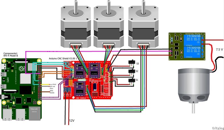

One of my students modified a CNC3018 with the following scheme.
A CNCShield has been used to support stepper drivers and to facilitate connections.
He also used a joypad as a teach-pendant.
The related hal file is attached.
The board was a Raspberry Pi 4 with 4 Gb
