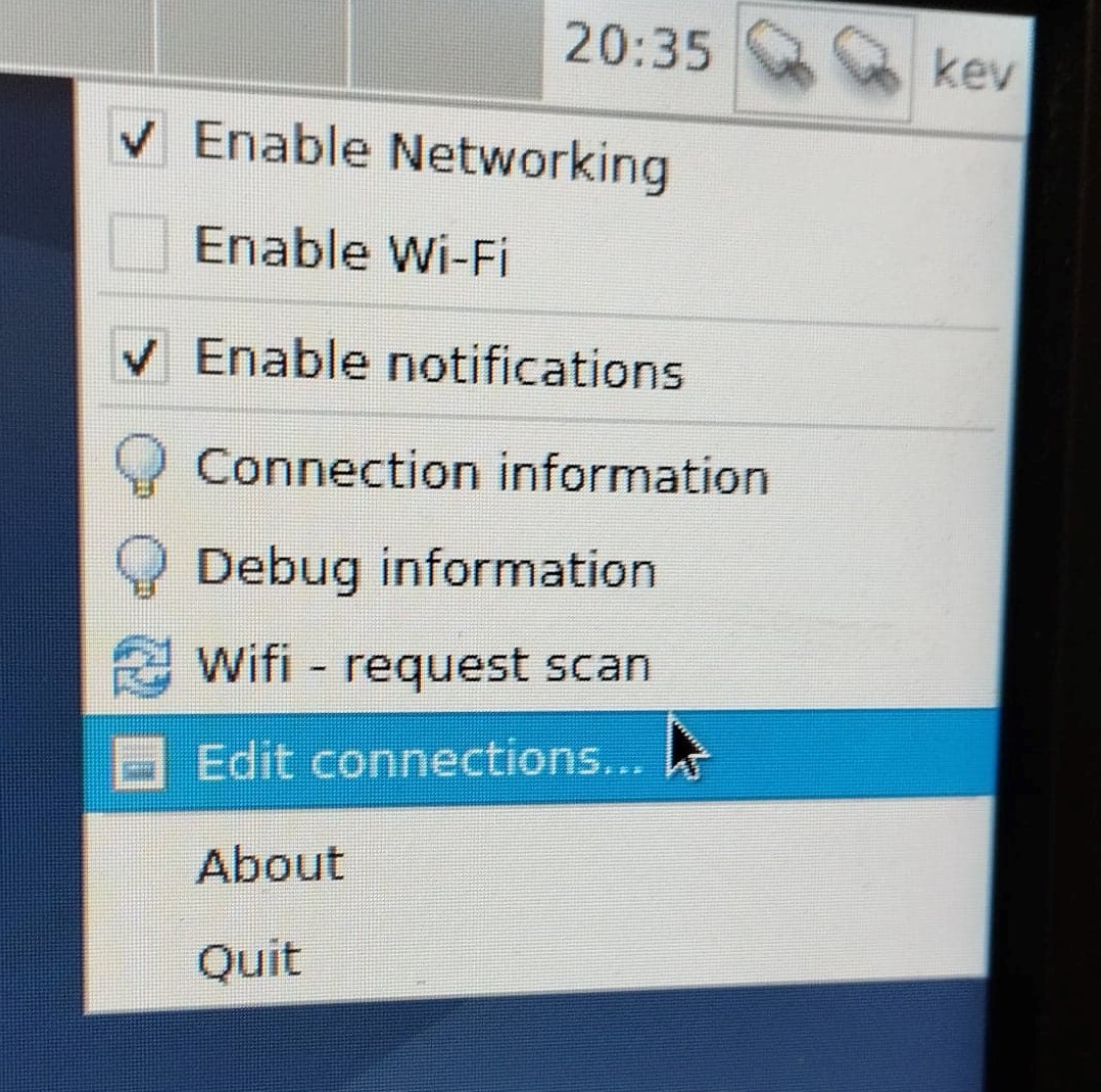

Network. Nothing happens when I press "Edit connections"

Network. Nothing happens when I press "Edit connections" was created by Kevin_Pawlus

gnipsel.com/linuxcnc/uspace/debian9-eth.html
You need to edit /etc/network/interfaces, network managers don't have a clue...
JT

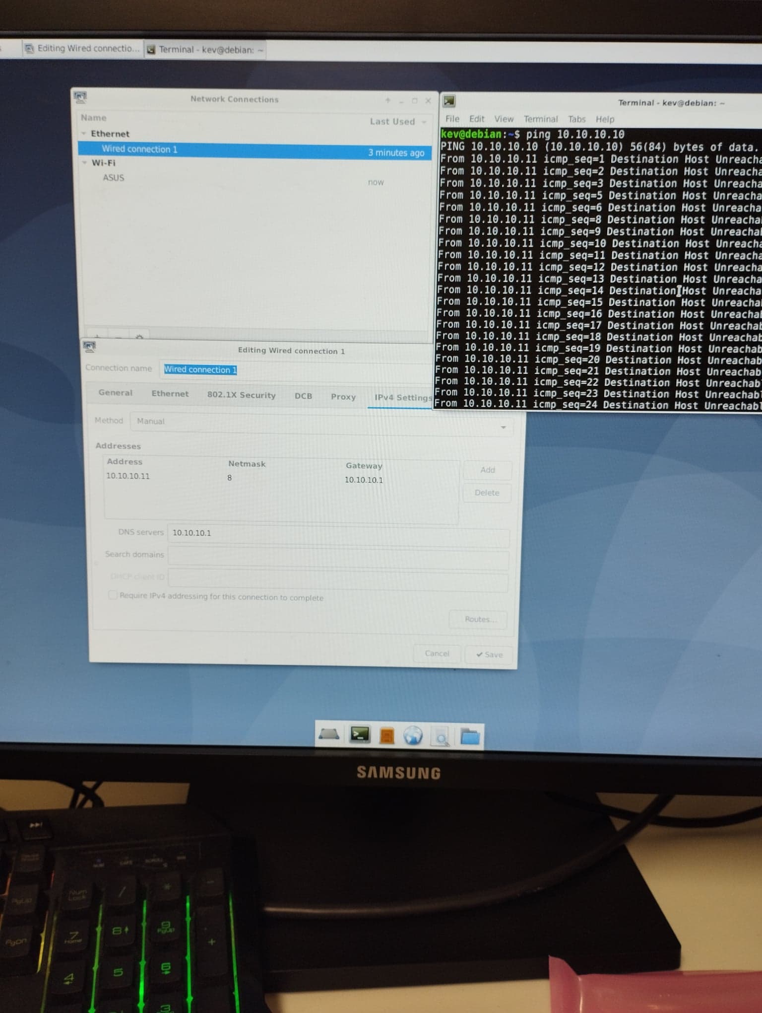

I did try that, could not get it to work...
Maybe should try one more time.
I edited the connection in network manager lite the pictures. I did also tried the guide on this forum but also no result...

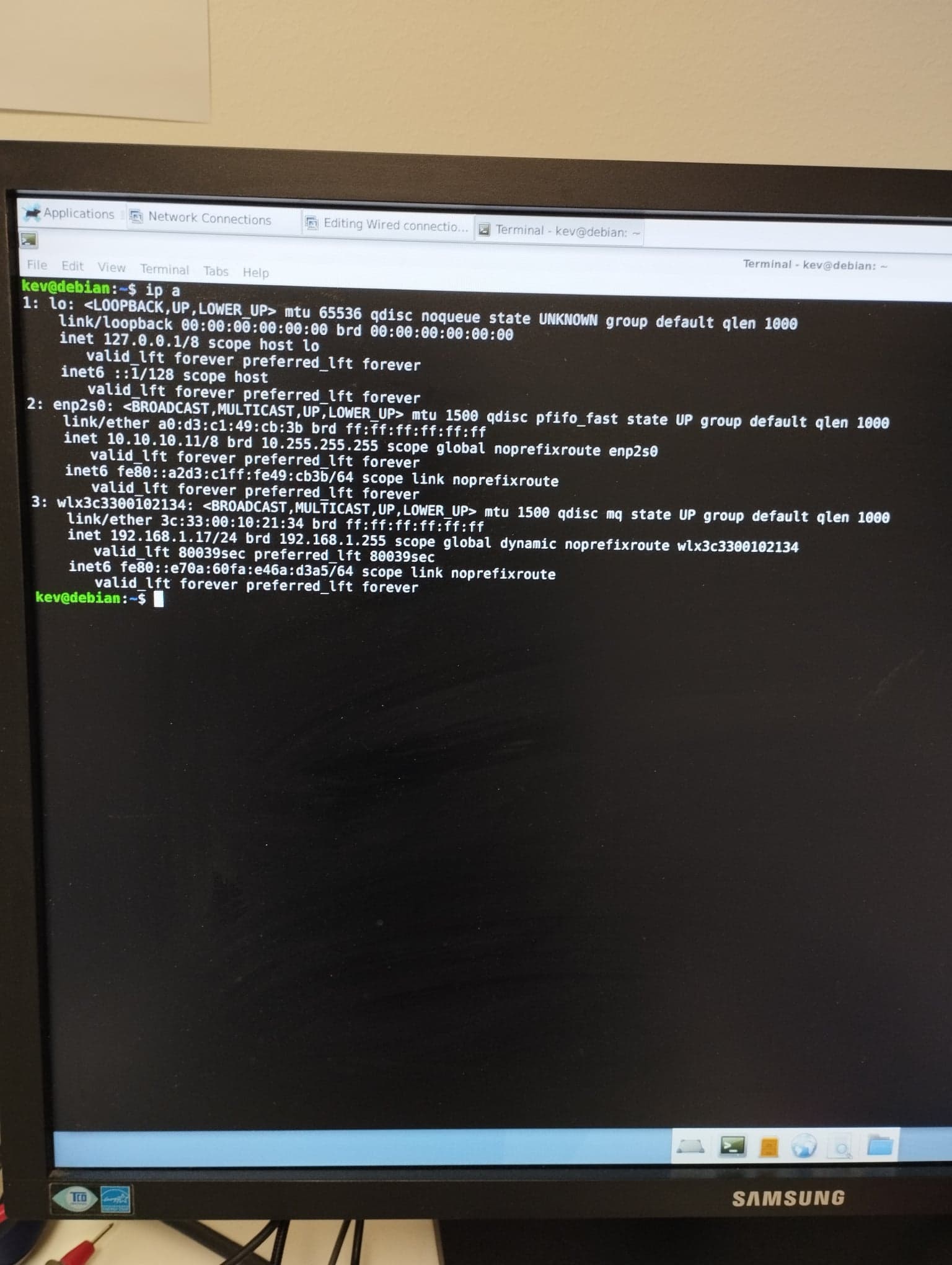

Is the 7I94 jumpered for 10.10.10.10 and connected?
What does
ip a
report
What does
ip a
report
- Kevin_Pawlus
- Posts: 63
- Thank you received: 6
18 Jul 2022 09:35 #247680
by Kevin_Pawlus
Replied by Kevin_Pawlus on topic Network. Nothing happens when I press "Edit connections"
- Posts: 18118
- Thank you received: 5336
18 Jul 2022 09:45 #247687
Replied by PCW on topic Network. Nothing happens when I press "Edit connections"
Default jumpers would set the 7I94 IP address to 192.168.1.121

I changed jumper W5 and it's working now!
Really glad for the help, this problem was annoying to me
