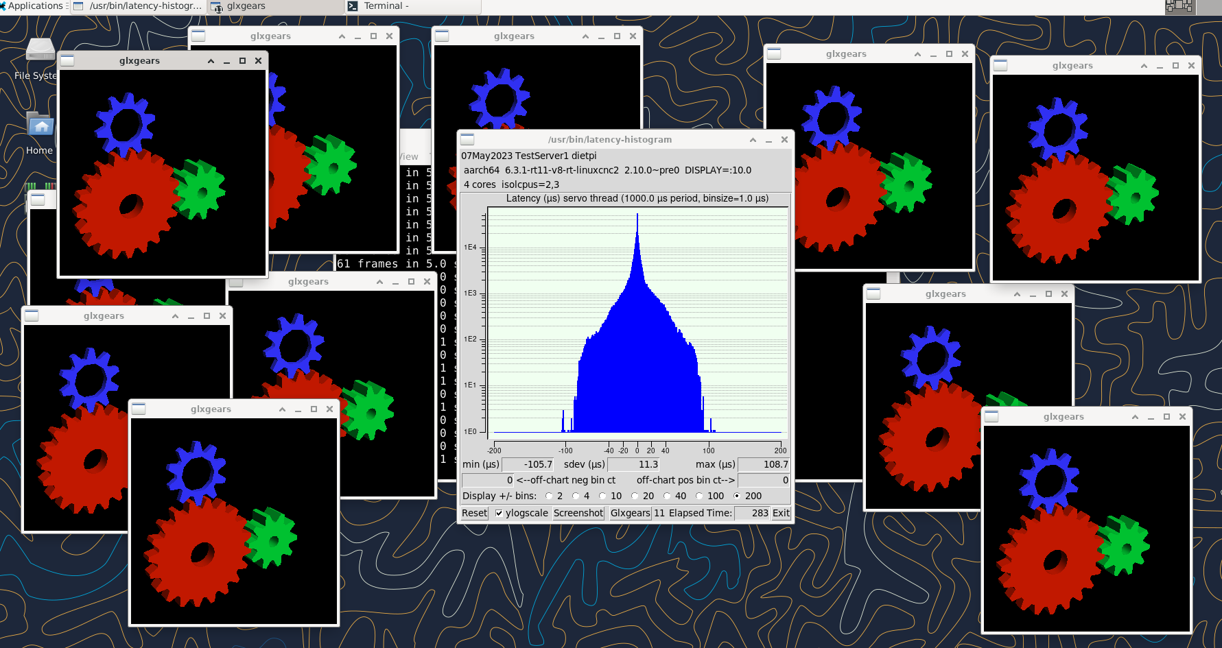

Hi All,
I've recently been experimenting trying to get LinuxCNC running on a RPI4 / RPI3
Using DietPi as a basis, I figured I'd list some of the details here I've been using for setup that might be useful
Although so far I've only managed to build the userspace side for 32bit and not 64bit for some reason It's basically raspian but with most of the default stuff not installed, so sort of a strimmed down version.
Although I've found it's main advantage over dietpi is if you install something via the dietpi-software menu
It will also handle all the configuration / setup, so I can just tick a box for xfce / xrdp
and instantly have a desktop I can remote to from a laptop without faffing with config files

For the realtime kernel
Ideally you don't want to be building the kernel sources on a SD card
so personally I tend to keep /boot on the sd card but move everything else across to a USB Hard Disk
I won't bother to go into details on how to do that here unless someone asks.
raspian recently merged 6.1.27 into they're 6.1 branch
github.com/raspberrypi/linux/tree/83cf6b...b7fef70b1a7c9539b0b9
using this in combination with this patch
mirrors.edge.kernel.org/pub/linux/kernel...-6.1.26-rt8.patch.xz
this seems to work ok for a realtime rpi kernel, at least for the Pi4

So I recently switched from 6.1 to 6.3
the performance seemed better also I encountered a random glitch with the harddisk after about an hour or so with 6.1 where it'd break the system
6.3 seems to have an odd glitch with the wifi rarely which prevents it recieving connections but not that often, and it can be fixed by restarting the wifi
performance still isn't great however but not terrible I think
interestingly enough running glxgears seems to have little impact
This is with "processor.max_cstate=1 isolcpus=2,3" in cmdline.txt
and dtparam=audio=off in config.txt
and the latest linuxcnc master (which I've figued how to build now)
Going to see if I can get the 5.10 series kernels to work to see how they compare
as the other Pi4 thread shows them as getting much better results

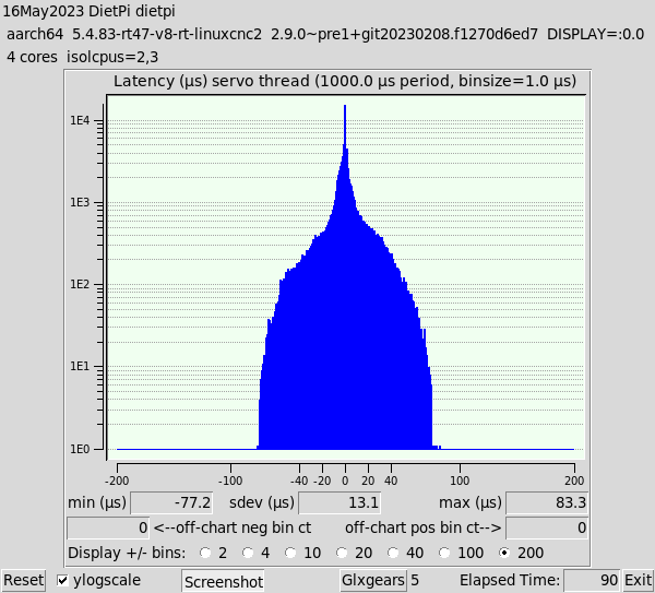

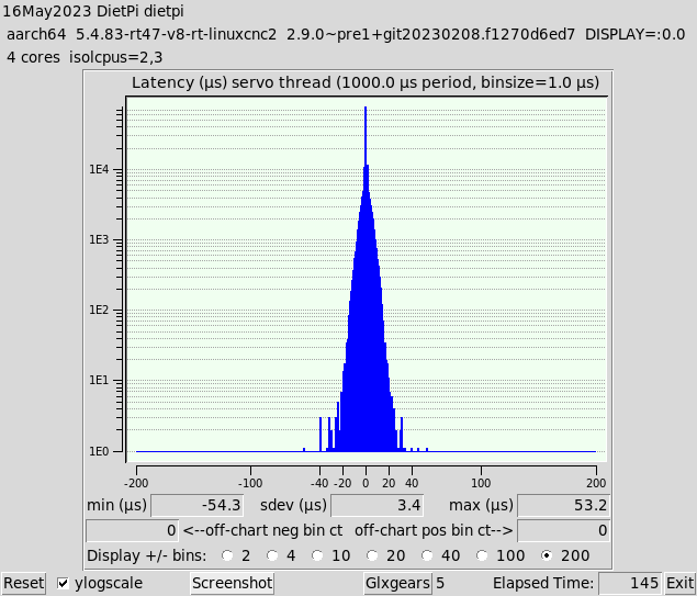

Just a quick update after a great deal of faffing I discovered the one thing that makes a huge difference isWhich is basically the 3D Accleration
From a before
To an after
I've also managed to get 5.4 working since I've seen that in other threads and wanted to see it's performance by comparison
I've also managed to hoard a large list of possible kernel options and optimisations which I need to trawl through
I've also written up a load of notes which I'll post a link to once I'm done.
Next its a case of going through each kernel config option / userspace script / boot command line option / kernel 6.3
I was trying that before but not getting consistent results until turning that video setting on doooh
dtoverlay=vc4-fkms-v3d-pi4From a before
