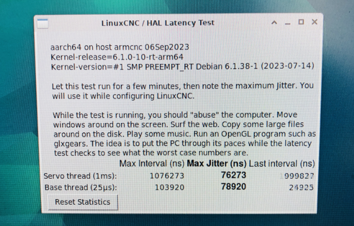

I am trying to install Debian12 and LinuxCNC on a Raspberry Pi 4B. Apart from the system being Debian12, I have followed the guidelines in the documentation for all other settings.
After the configuration was complete, I used the LinuxCNC test software to conduct a latency test, and the results are as follows:
I'm not quite sure what caused the issue. Can you provide some guidance and suggestions?

sudo rebootAfter the configuration was complete, I used the LinuxCNC test software to conduct a latency test, and the results are as follows:

Thank you for your help and guidance. I'll start testing immediately. Is it necessary to disable wifi to improve latency? Wifi is very important to me. I might use external devices for stepper motor control in the future.

Just test & see. You may have to raise your base thread a little to work with software stepping.

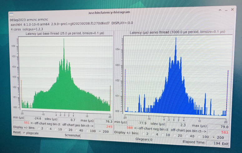

I tested it, and the runtime seems to be about the same as what I built myself.

Did you isolate another Core ? As built only 2 cores are isolated.
If you really need to use software stepping you can try upping the base thread but that will lower your step frequency.
latency-histogram --base 30000
Or as another option have a look around the forum there might be another image based on Raspbian OS that is Debian 11 (bullseye) that might get you better results.
There's some info here wiki.linuxaudio.org/wiki/raspberrypi whilst it's aimed at audio applications you might get some luck. To be honest an external motion card will more than likely be the better option as latency isn't such a big issue.
Another thing to think about is the Debian kernels don't appear to allow loading of overlays, the kernel from the Raspberry guys have the patch for the required infrastructure.

I don't know the pi well but developed the Debian 12 installer using the debian images and pioneered the approach Cornholio is using to make the Debian image.
What I don't understand is why you would use software stepping on a pi. Wouldn't you be better off using a hardware or timer interupt on the GPIO pins? Andy Pugh has a new device driver for gpiod but I think he's stilll working on how to get it to build within linuxcnc
github.com/LinuxCNC/linuxcnc/blob/andypu...l/drivers/hal_gpio.c
This is the more generic approach to deal with gpio on most SBC's
He says this reads in 16 usec and writes in 8 usec. I have run steppers with a simple on/off square wave pulse (2 writes per pulse) but linuxcnc is a bit smarter and sets a shorter pulse in the operating frequency. I think that is still only 2 writes per step. That gets you up to around 62 kHz step max frequency. I think that would be quite a reasonable performance. My tests found step frequency was limited to about 90-100 kHz from memory for a stepper. You guys should investigate how feasible that would be to implement. Me, I will stick to Mesa or ethercat.
