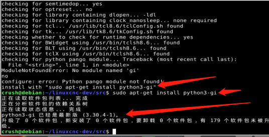

When I was executing "./configure --with-realtime=uspace"
[attachment=55898]326fafdb94d4b26e5884c1619de669b.png[/attachment]
Reminder: I don't have 'python3 gi'
When I was executing "sudo apt-get install python3-gi"
Python 3 gi is already the latest version (3.30.4-1).
I don't know where the problem is.
who can help me?

image1:
checking for python pango module... Traceback (most recent call last):
File "<string>", line 1, in <module>
ModuleNotFoundError: No module named 'gi'
no
configure: error: Python pango module not found!
install with "sudo apt-get install python3-gi"
image2:
crush@debian:~/linuxcnc-dev/src$ sudo apt-get install python3-gi
Reading package list complete
Analyzing dependency tree for software package
Reading status information complete
0 software packages have been upgraded, 0 new packages have been installed, and 0 software packages need to be uninstalled. 179 software packages have not been upgraded.

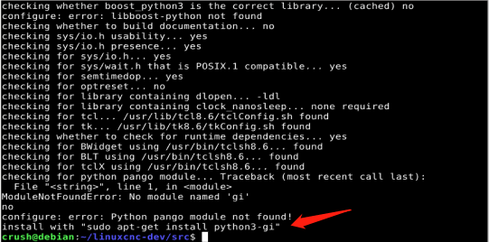

no

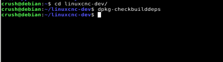

you can runto see what is missing.
dpkg-checkbuilddepsPlease Log in or Create an account to join the conversation.

Here is a video I did of the build process which may help. It shows how to use dpkg-checkbuilddeps

12 Sep 2023 01:41 #280510
by zq17788959338@gmail.com
Replied by zq17788959338@gmail.com on topic about:./configure --with-realtime=uspace

hmmm that was interesting.
I have python3 installed, this is the line that runs the check where you are failing, I added the python3 bit, the original line is.[/code][/code][/code]
if $PYTHON -c "import gi;gi.require_version('Pango', '1.0');from gi.repository import Pango"; thenpython3 -c "import gi;gi.require_version('Pango', '1.0');from gi.repository import Pango"
was ok
[code]python -c "import gi;gi.require_version('Pango', '1.0');from gi.repository import Pango"
failed
After linking /usr/bin/ptyhon3 to /usr/bin/python
was ok
What does [code]python --version[/return] ?
Does Buster have both python3 & python2.x installed ?

I followed the video to operate. When I execute 'sudo./configure -- with real-time=uspace'
When, the system will prompt me to install 'Python 3 gi', but I have this module in my system, so I don't know how to solve this problem.
