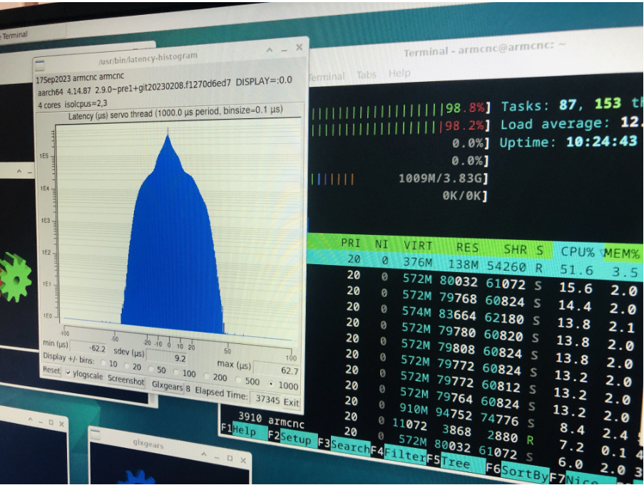

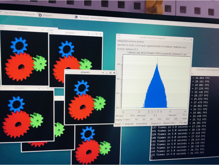

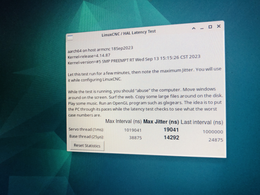

This is our own development board, intended for use with LinuxCNC. Currently, we're researching and adapting it in our spare time.
1、We built the base filesystem for Debian 12 using the following method:
2、We installed some basic software packages:
3、We installed LinuxCNC using the following method:
4、Currently, we have tested the latency using LinuxCNC's test software, and the results are acceptable. However, we are unable to start the LinuxCNC simulator.
mkdir debian12_rootfs
debootstrap --arch=arm64 --foreign bookworm debian12_rootfs http://mirrors.ustc.edu.cn/debian/2、We installed some basic software packages:
lsb-release git vim wget make cmake python3 python3-pip systemd-timesyncd wireless-tools wpasupplicant iw firmware-iwlwifi net-tools sudo nano openssh-server console-setup rng-tools locales fake-hwclock hostapd ethtool dnsmasq netbase udev dbus parted htop rsyslog u-boot-tools openssl libssl-dev stress chromium xfce4 xfce4-goodies lightdm network-manager-gnome3、We installed LinuxCNC using the following method:
sudo apt install linux-image-rt-arm64 linux-headers-rt-arm64
sudo apt install linuxcnc-uspace linuxcnc-uspace-dev4、Currently, we have tested the latency using LinuxCNC's test software, and the results are acceptable. However, we are unable to start the LinuxCNC simulator.

It seems all the problems have been solved, thank you for your help.
My current approach:
1. Rebuild the Debian 12 base filesystem, optimizing and porting some of the original Ubuntu dependencies.
2. Download the built Debian 12 image to the SD card.
3. Reinstall: libgl1-mesa-glx libgl1-mesa-dri xserver-xorg-core
4. Install: linuxcnc-uspace linuxcnc-uspace-dev
Everything is now in order, and I'm ready for the next step.
