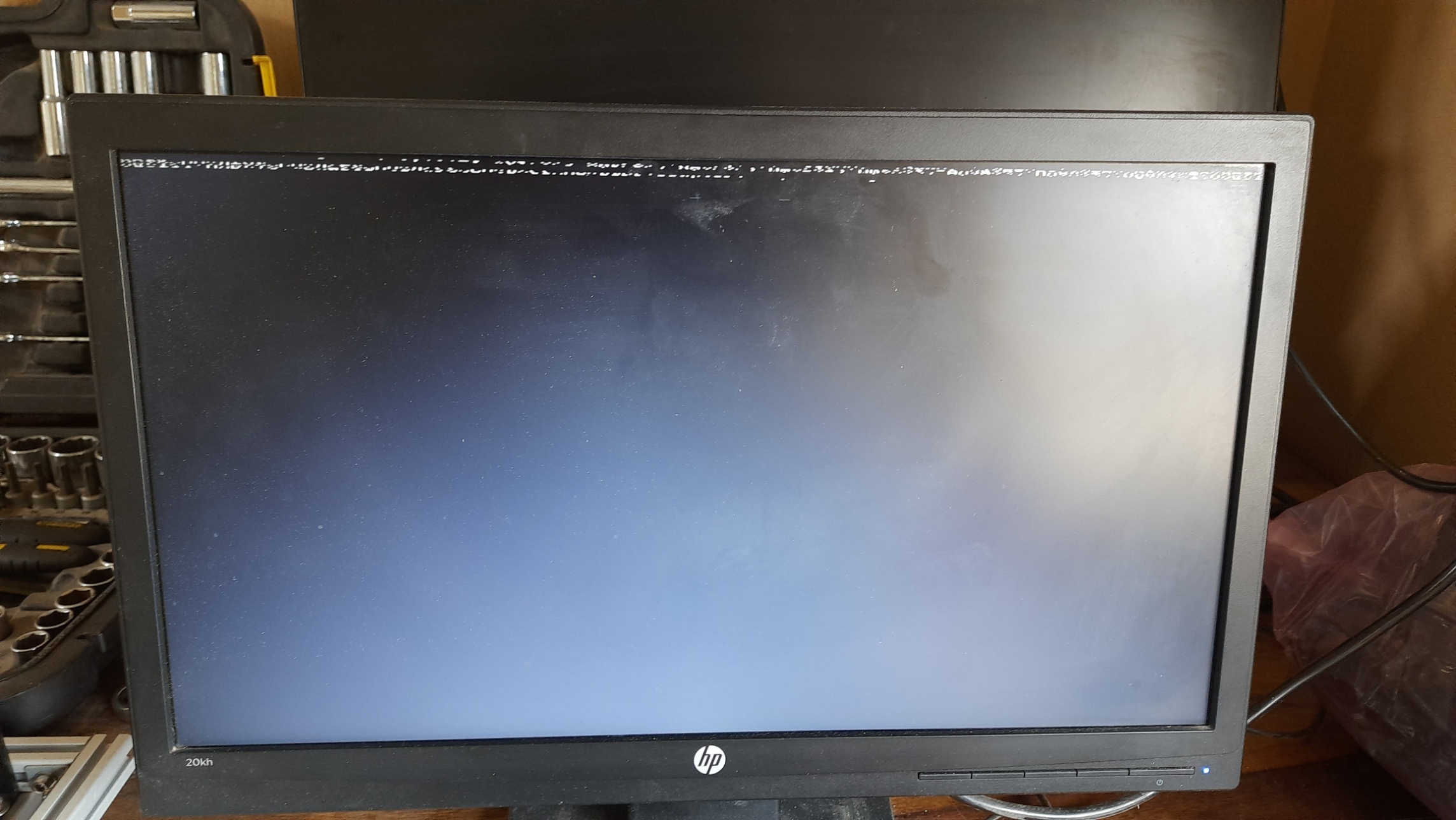

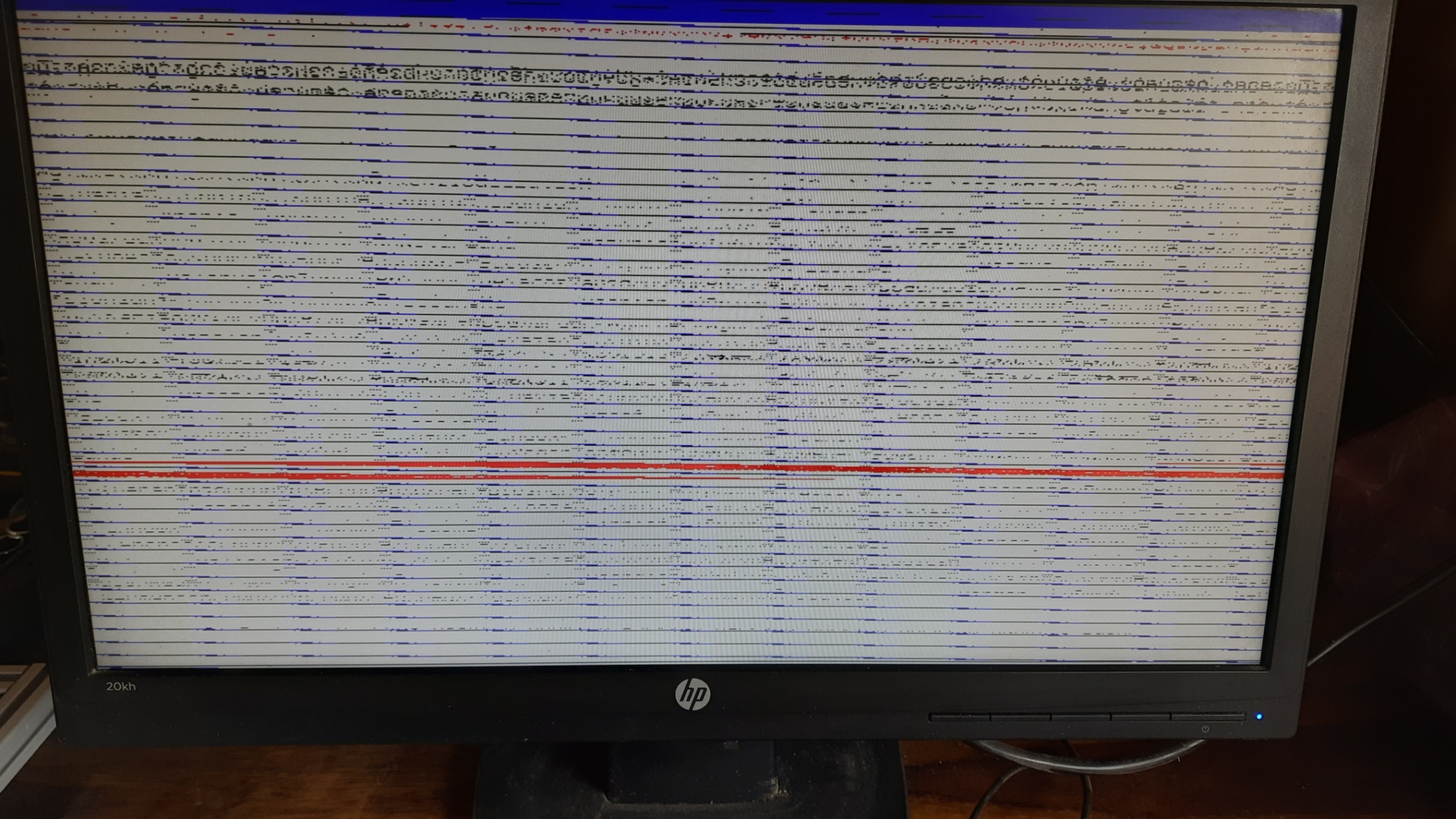

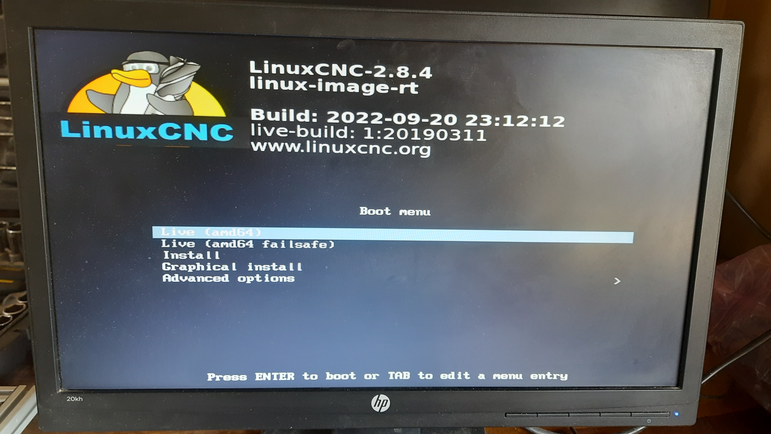

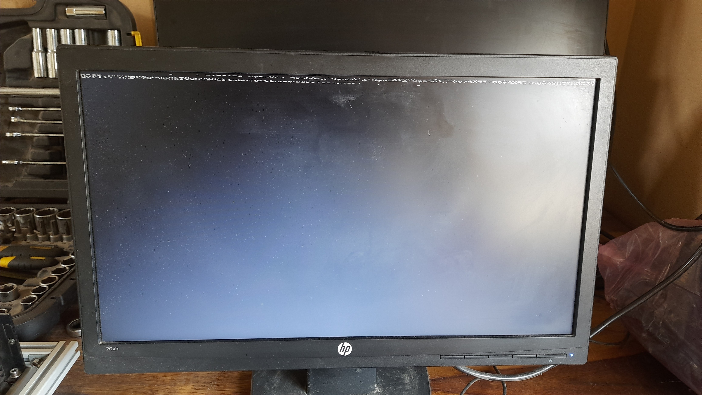

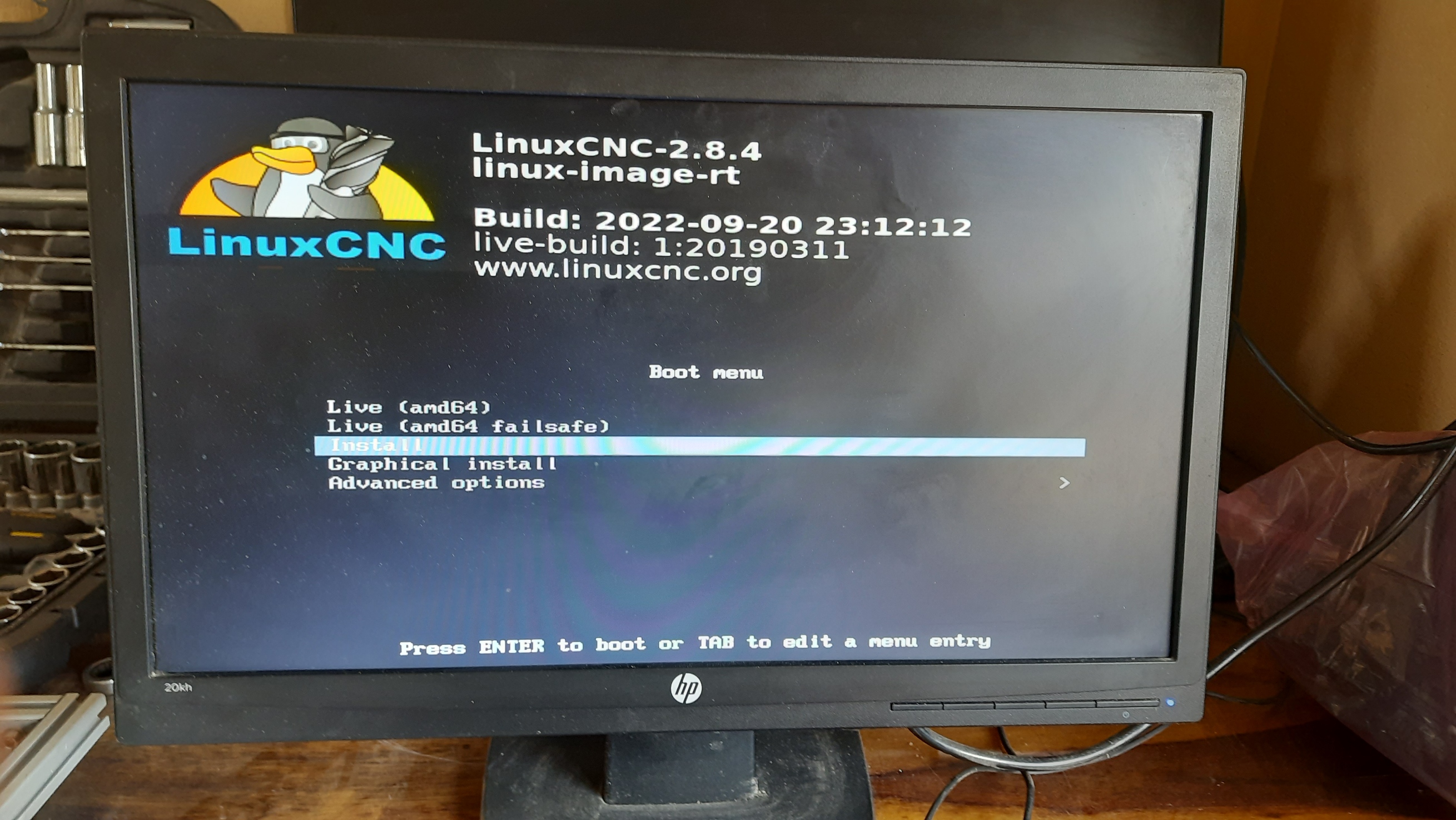

I am getting garbled / broken display as soon as i try to use either install / graphical install. Some images are given below. It doesnt break in any other options that i use.

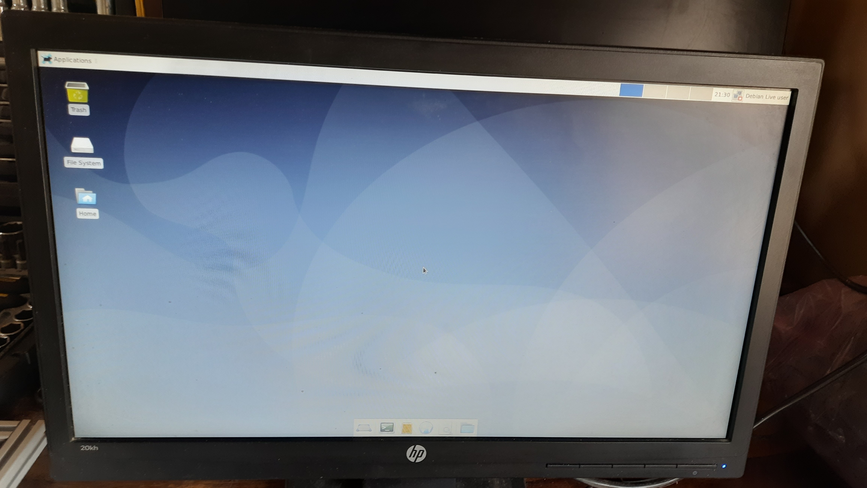

It boots to the live cd for both versions as well and the diplay is good there, where it does have some broken screens on the way there.
I have tried versions 2.8.4 & 2.9.1.
PC Configuration
MB - MSI A320M-A PRO AMD PCIe 3.0 DDR4 (HDMI & DVI Output Only)
Processor - AMD Ryzen 3 3200G with RadeonVega 8 Graphics Desktop Processor 4 Cores
SSD - Crucial BX500 240GB
RAM - 8GB DDR4 3200
Monitors - HDMI Only - 20 inch & 24 Inch - Same issue on both monitors.

It was resolved with a BIOS update.

Probably VSync error, usually from the graphic card sending non standard refresh rates to the monitor.
