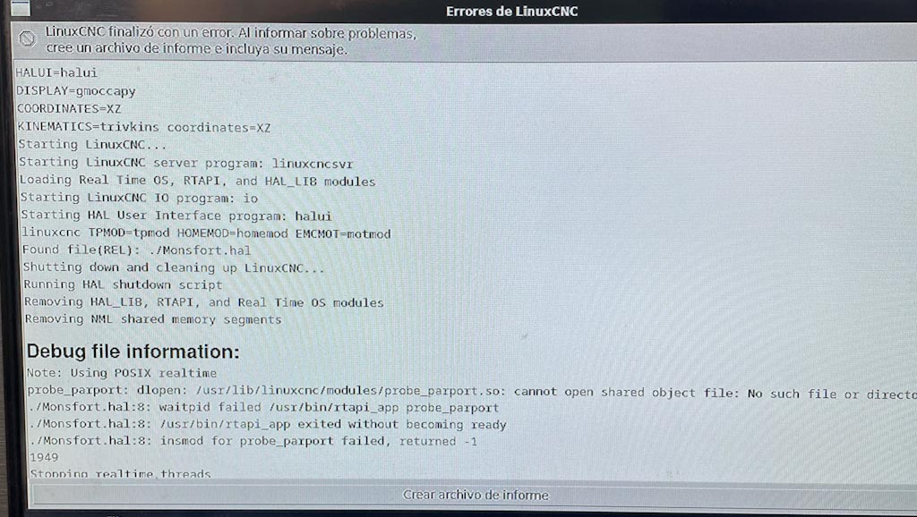

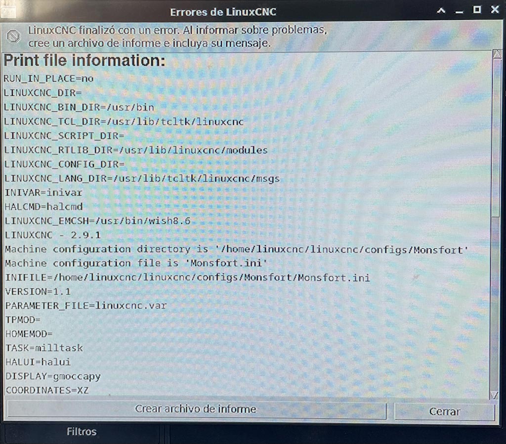

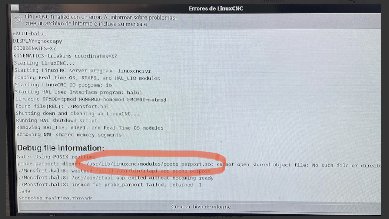

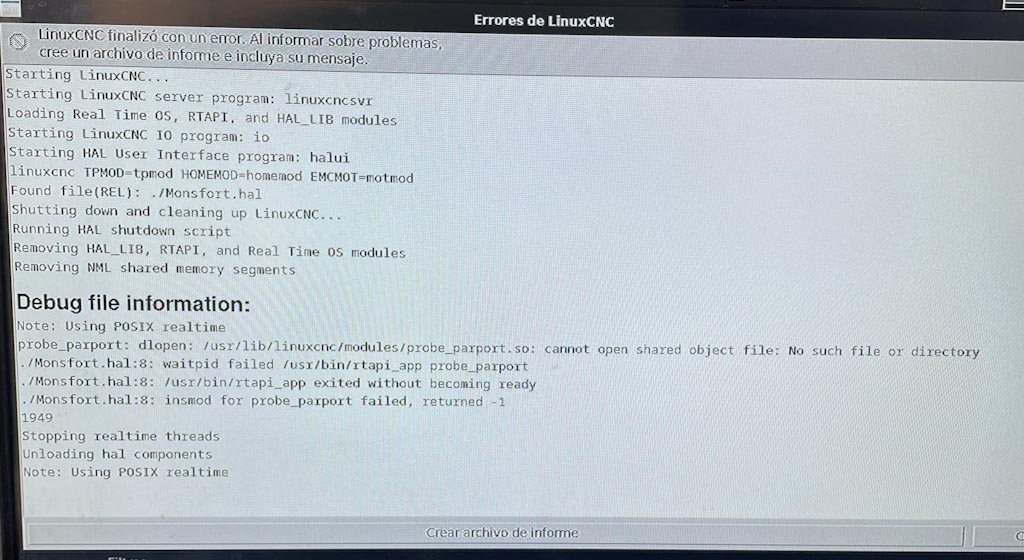

I've installed linuxcnc 2.9 by downloading the latest ISO.
after copying my previous configuration files (/linuxcnc), It didn't launch anymore.
I attach the errors I get.

Your custom module is missing. You could try copying this file from your old Linux CNC PC.

That module is not used by LinuxCNC since 2.7 or earlier, i think, so just delete or omit the line containing probe_parport.so in the hal file.
