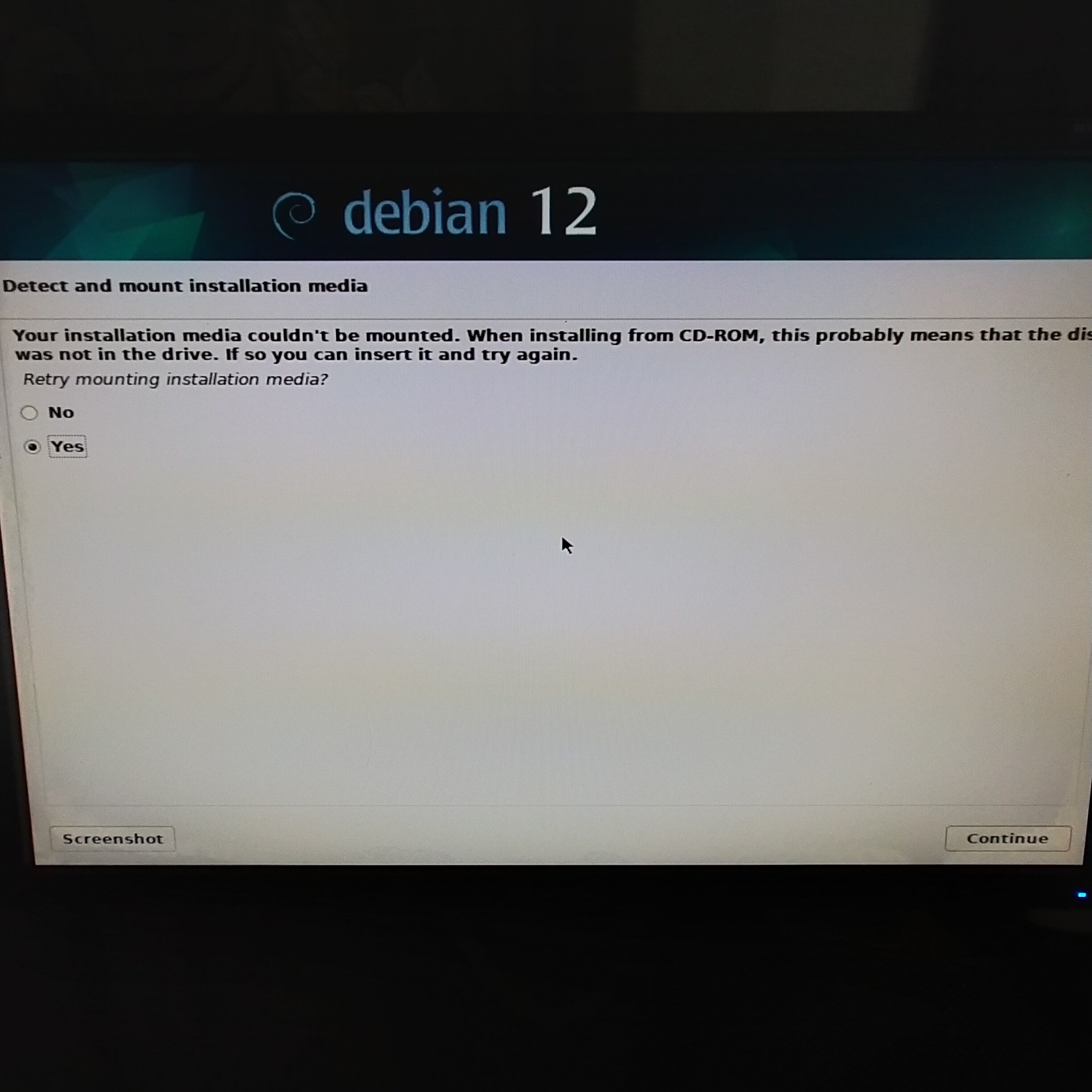

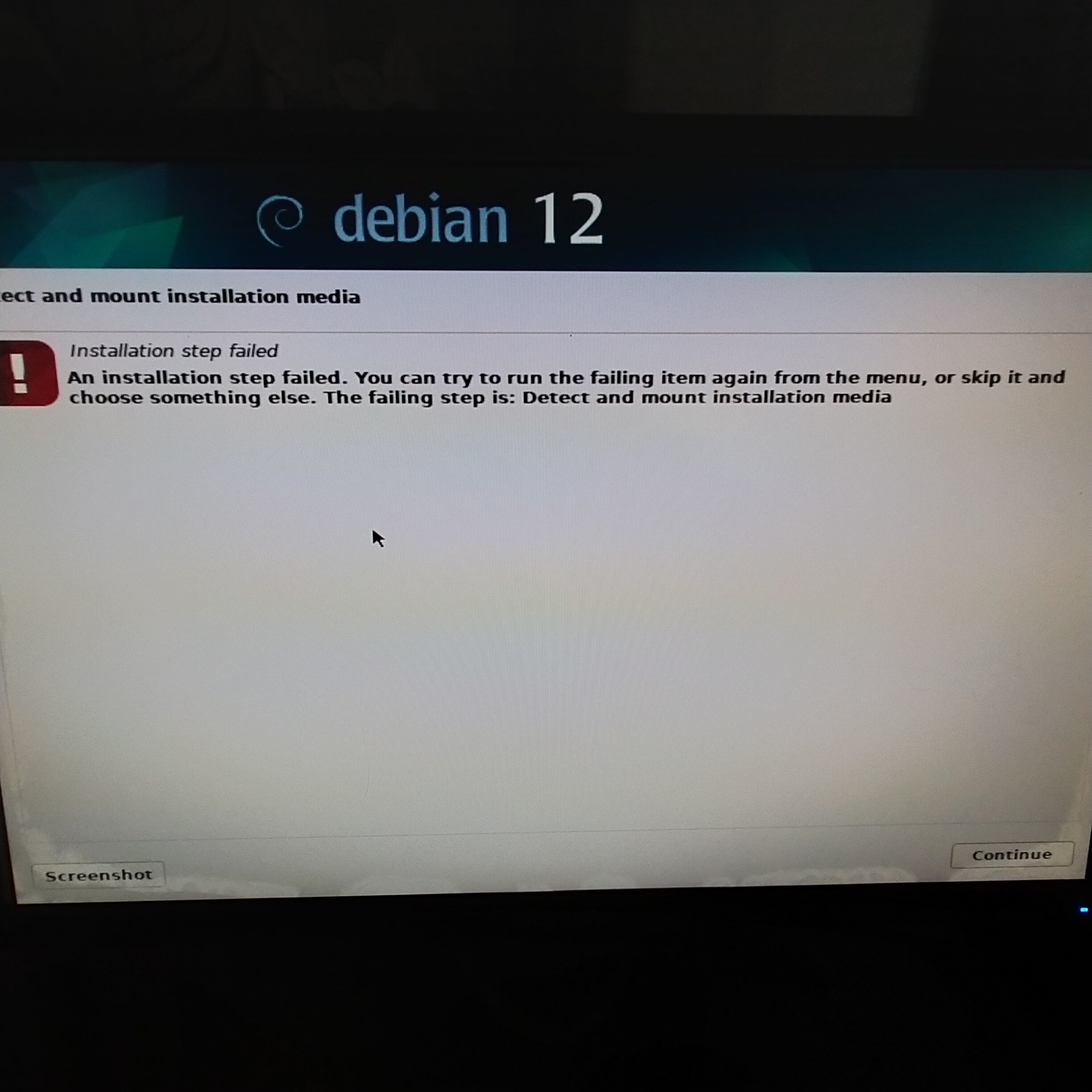

Hello, I created a USB installation disk using rufus. After starting the installation, I have a problem with the CD-ROM, I don't want to install from CD, the installer does not allow it.

In Rufus, after clicking "Start", select "Write in DD Image mode".

Replied by tommylight on topic LinuxCNC 2.9.1 installation from USB
When you get the first error, unplug the USB, wait 3 seconds, plug it back in, wait 10 seconds, select "yes" and continue.

Replied by rodw on topic LinuxCNC 2.9.1 installation from USB
Can you try using Balena Etcher to burn your USB stick? Rufus does some funny things.

Replied by szatri on topic LinuxCNC 2.9.1 installation from USB
it works, thank you for your helpWhen you get the first error, unplug the USB, wait 3 seconds, plug it back in, wait 10 seconds, select "yes" and continue.
