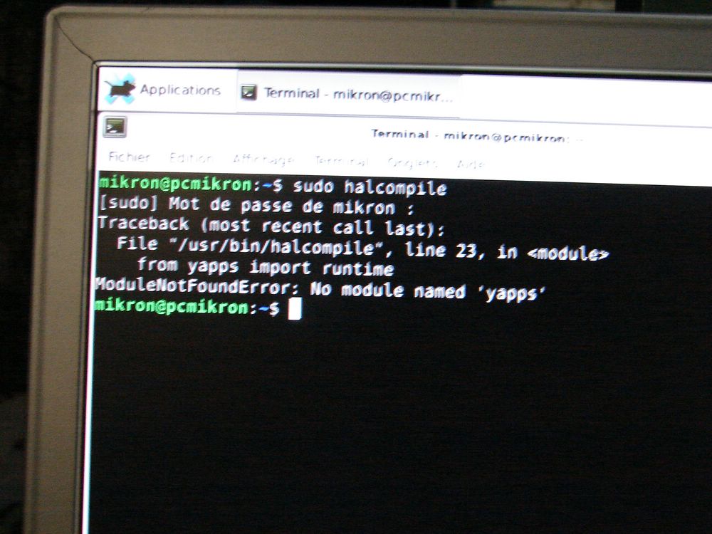

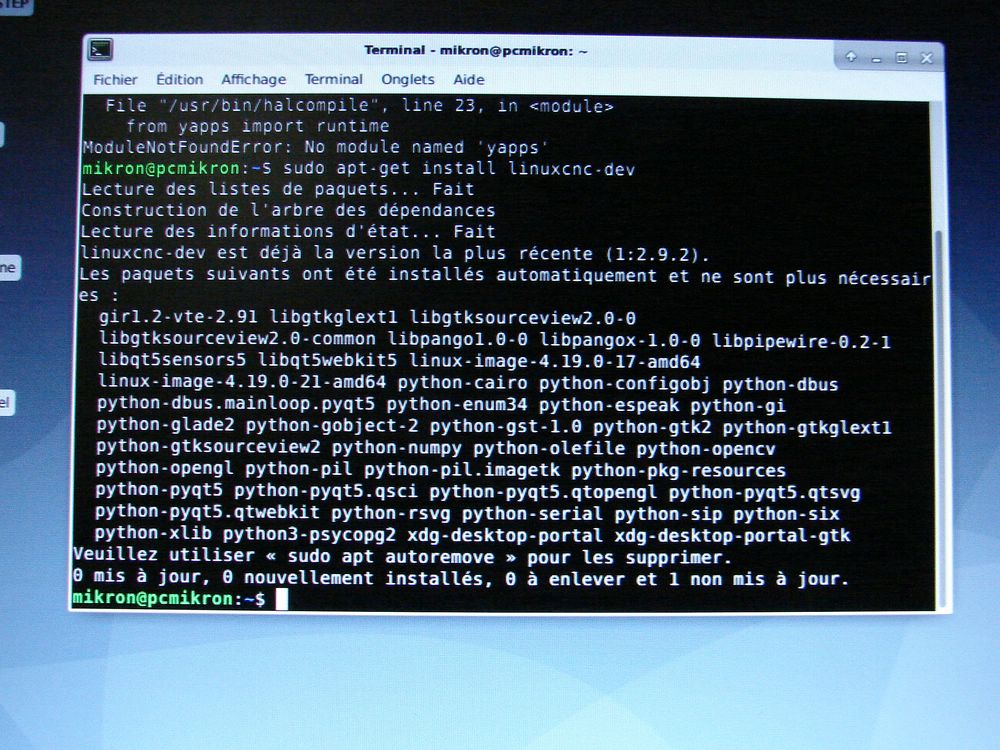

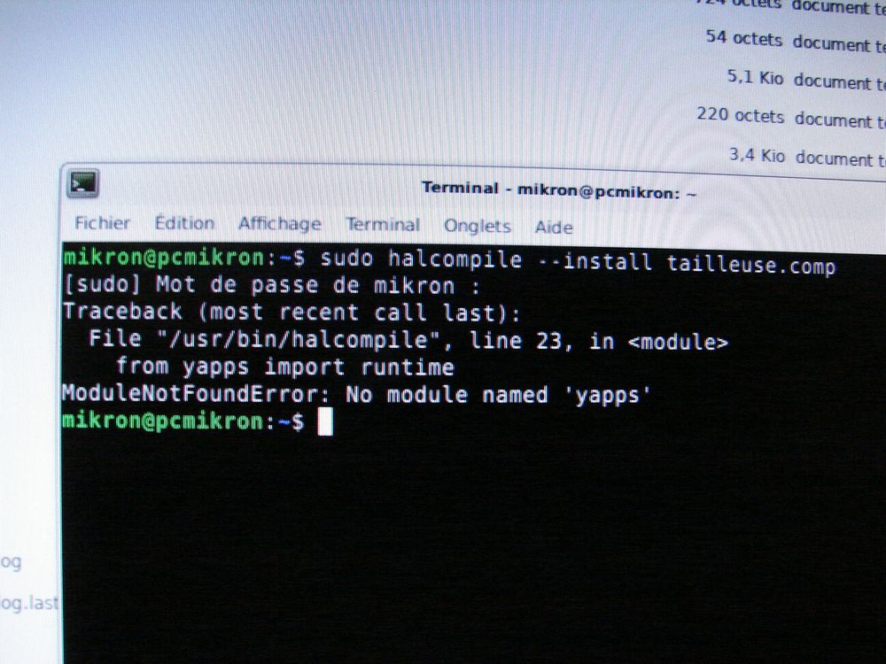

27 Dec 2023 14:54 #289175
by gaston48
Replied by gaston48 on topic Errors in linuxcnc update
- Posts: 21922
- Thank you received: 7468
27 Dec 2023 15:03 #289177
Replied by tommylight on topic Errors in linuxcnc update
sudo apt install yapps2
The following user(s) said Thank You: gaston48
- gaston48
- Posts: 112
- Thank you received: 5
27 Dec 2023 15:44 #289178
by gaston48
Thank you tommylight
it works perfectly
