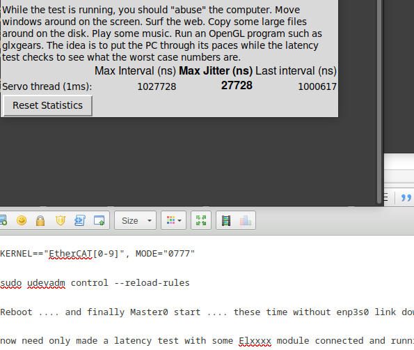

After these your system is pefectly udate .... so you can proceed with less panic ..... BUT... actually (from 8-9-2024 ) repository on kernel 6.10 headers have some problem about some loses lib or firmware .... so impossible to start a preempt SO ..... I update you when these problem was solved ....
At 15-09-2024 I find find all packages needed .... after these you can install freely linuxcnc. Think open a post as guidance. Actually for right SO for modern application need to solve problem with utf8 encoding and qt6 .... after we can have a complete modern LMDE6 SO working for many different modern industrial like applications. Think all is applicable for bookworm too.
linuxcnc-ethercat work only for standard Intel210 ethernet port ... for all other need to install etherlab 1.6 and build right module driver .... generic driver install with linucnc-ethercat is ok too ... but can have sono more packet looses than right driver for right port as example r8169 realtek .... or i915 or other inside module folder of etherlab repo.

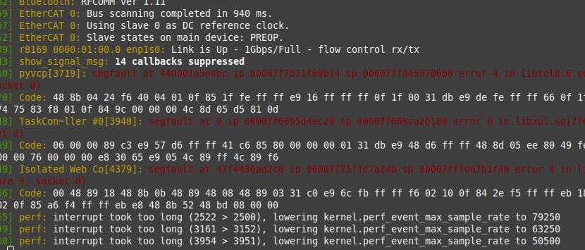

After is only a story of my difficult to have r8169 working on LMDE6 .... at the end it work but kernel 6.6.3 is real buggy so i have a lot of loses packet during ethercat working .... So i start a new and plain install using 6.10 .... no so buggy like 6.6.3 ...
I discovered at my expense and through my own distraction that the Realteck ethernet ports do not go well with Linux in general..... please google: RTL8169 linux problem..... or RTL8168 Linux driver.... or the 10 more search suggestions from Google now that it uses AI.
It is clear that having a PC that requires RL816x drivers is not something to be taken lightly.
My experience with LMDE6 and with rt-preempt 6.1.0.18 is that I got a good kernel with very good results on an N95 but it started to give problems with ethercat.... in fact the master managed port kept disconnecting .... similarly to what is written in the various posts on Google .... so I tried to install dmks-r8168 as most people suggest .... with the result of no longer having any Ethernet ports visible from the system ... ..I then took a step back to the old drivers....installed original realteck drivers and blacklisted the r8169 drivers to only use the r8168 drivers....got a working system....but with ethercat blaming constant disconnections.
I then upgraded to kernel 6.1.0.20..... a disaster.
I reinstalled LMDE6 non-rt version all over again, I tried installing the dmks-r8168 drivers first and then switching to an rt system with kernel 6.1.0.18.....everything seemed to work great.....so I tried to upgrade to kernel 6.1.0.20 rt ...... excellent latency in tests ... better than the previous one ..... but once again the ethernet ports have disappeared.
I then try to reinstall everything from scratch again.... I'll write the steps here... let's see if luck will help me.

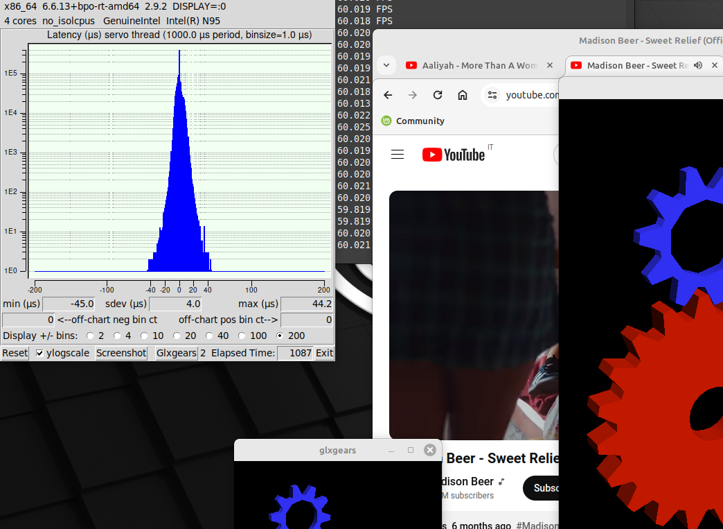

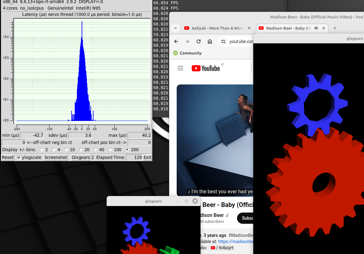

20 Apr 2024 05:50 #298716
by bkt
Replied by bkt on topic Lcnc on LMDE6 with rt 6.1.0.18/20 -- realtek problem
So I restart a couple of time for sanity check ... and every time launch dmesg .... I obtain the same messages .... and after sudo dmesg -C if run youtube for 30min not discover other enp1s0 event ..... so now after 30mins of youtube music video
-> sudo dmesg | grep "enp1s0"
Seems there are not a problem with r8169 driver in these newest SO ...... not try to install rt-preempt ( tese link is still valid forums.linuxmint.com/viewtopic.php?t=407613 )
-> sudo apt install -t bookworm-backports linux-image-rt-amd64 (because we have the last one bookworm istalled)
at the end we need to reboot .... after can be all ok .... and we can have last rt-preemp avaiable ....
but in my case have these:
so now try to solve these error ....

After these I istall Chromium .... because firefox was unstable ... and dmesg shoe is not rtl drive related .... after boof enp1s0 is linked and never go dows ..... using chromium neve see other web page go dow at all ....
I remeber some week ago need to install something for can install Lcnc 2.9.2 ... so i check and discover need to install these packets
sudo apt-get install libgpiod2
sudo apt-get install libtool
sudo apt-get install autoconf
reboot .....
After I use GDebi for istall previous dowloaded Lcnc ..... than reboot
After try to have a latency test ..... good result whitout nothing do... see image above .... first and same after some time:
quite good result ... enought for servo pourpouse at least. Surely with some trik we can do better than these ... but my intentio is to use 2ms realtime so in these case is perfect.
Now need to install ethercat ....

we are in kernel 6.6.13+pbo because it promised to solve problems related to the realtek card.... unfortunately I had doubts ethercat/etherlab supported the 6.6 kernel... but I also saw that either Shasa or Christian wrote something about the kernel 6.6 from the changelogs of the gihub etherlab repo....so I went straight with the test without looking too much...like a happy child.
however, to do things properly the ethercat modules should have been compiled in this way... I'll repost it for completeness:
CONFIGURE TO THE TYPE OF MODULE NEEDED
./configure --sysconfdir=/etc/ --disable-8139too --enable-userlib --enable-generic --enable-r8169
I didn't do it... instead I followed a guide by jjdege on an Italian forum so I used these source list:
deb [allow-insecure=yes] download.opensuse.org/repositories/home:...rLab/Debian_Testing/ ./
sudo apt-get update
KEYRING=/usr/share/keyrings/ethercat.gpg
curl -fsSL download.opensuse.org/repositories/home:...:/science:/EtherLab/
Debian_Testing/Release.key | gpg --dearmor | sudo tee "$KEYRING" >/dev/null
Before this I made my own suggestion to configure the port with a fixed IP.... something I had never done before for ethercat which has always worked well. As usual I disabled IPV6 leaving IPV4 with mask 24 and address 10.0.0.1... nothing else configured outside the standard.
sudo apt install -y linux-headers-$(uname -r)
sudo apt-get install ethercat-dkms libethercat libethercat-dev ethercat-master
I made the usual settings of the mac address ... also using the MODULES macro this time:
MASTER0_DEVICE="xx:aa:yy:zz:bb:cc"
DEVICE_MODULES="generic r8169"
so the system can choose whether r8169 or generic
Now I have given the usual permissions:
sudo systemctl enable ethercat.service
sudo systemctl start ethercat.service
sudo systemctl status ethercat.service
sudo chmod 666 /dev/EtherCAT0
sudo gedit /etc/udev/rules.d/99-ethercat.rules
KERNEL=="EtherCAT[0-9]", MODE="0777"
sudo udevadm control --reload-rules
NOW REBOOT.
all that remains is to check the latency test and check the dmesg
Latency seems quite good but firefox have some problem ...
dmesg show me that firefox have some problem but enp3s0 that is ethercat have no disconnection now ..... thats all and is good enought for me ....
NOW need to discover firefox problem where is and why ACPHI error see at start of post.

ACPHI problem is not solved for now .... and with more and more test ...
But work on increase latency result simply for self learn about these theme. Now try these:
GRUB_CMDLINE_LINUX_DEFAULT="quiet splash snd_hda_intel.dmic_detect=0 nosmt acpi_irq_nobalance nohz=off nowatchdog " ... after these read linuxfoundation guidance and tatel post
