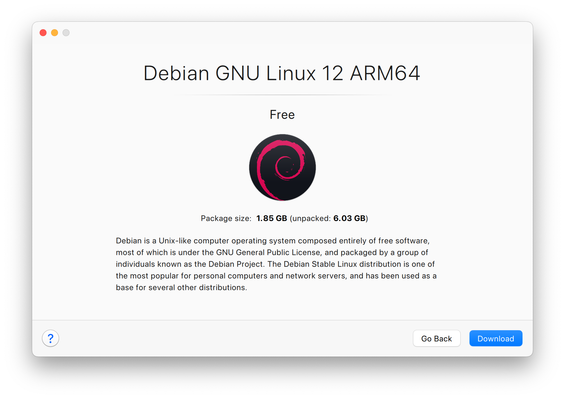

I am considering using LinuxCNC, but I have never used Linux in my life - except when I program for and control a Hermle 5-axis cnc mill with a Heidenhain TNC640 control, which runs Linux under the hood.
I am at heart a Mac person, and I just installed a VM of Debian 12 Linux (image below from Parallels installation process) on my M2 Max Mac Studio. I am typing this from Firefox in Linux, which was already installed.
I have been trying to figure out how to install LinuxCNC, but I keep going in circles. I managed to find instructions here: linuxcnc.org/docs/stable/html/getting-st...etting-linuxcnc.html, under 7.2, but then I got the following error in Terminal:
parallels@debian-gnu-linux-12:~$ sudo apt-get install linuxcnc
[sudo] password for parallels:
Reading package lists... Done
Building dependency tree... Done
Reading state information... Done
Package linuxcnc is not available, but is referred to by another package.
This may mean that the package is missing, has been obsoleted, or
is only available from another source
E: Package 'linuxcnc' has no installation candidate
Not sure what else to do. Should I try to figure out how the Raspberry Pi installation works? It's also ARM, so I imagine it would probably work similarly.
Is there a Debian for ARM that already includes LinuxCNC that would work in a VM on a Mac, at least for simulation?

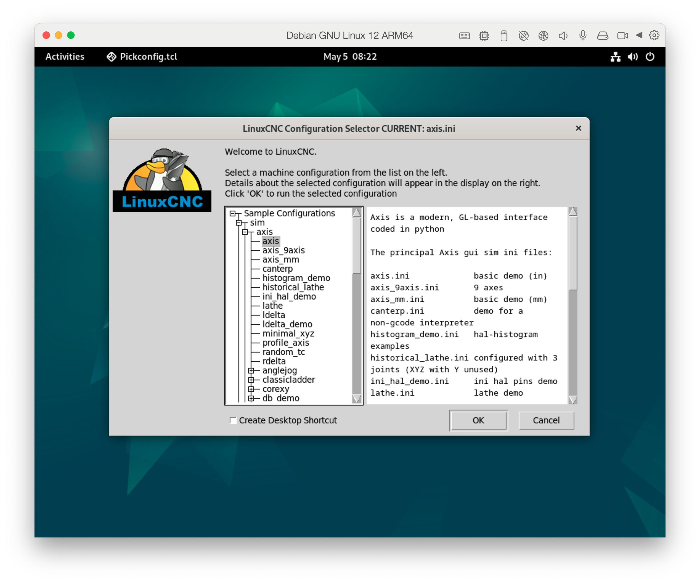

First
sudo apt update
Then
sudo apt install linuxcnc-uspace
And you have been using Linux all the time, Mac's run Linux, iPhones run Linux, Android is Linux. All the worlds servers run Linux.
It just looks and feels a bit different in each case.
sudo apt update
Then

Linuxcnc requires a real time kernel version of Linux called PREEMPT_RT
While you may be able to run linuxcnc on Parallels, you will not be able to run a real machine from it.
The ARM version of linuxcnc you are running is well over 12 months old so will be mising a lot of recent features and bug fixes.
Find an Intel based PC and install the linux ISO we provide and life will be a lot easier.
I think people have been able to install Linuxcnc from the ISO on Mac AMD64 hardware but it wipes MacOS from the system.
