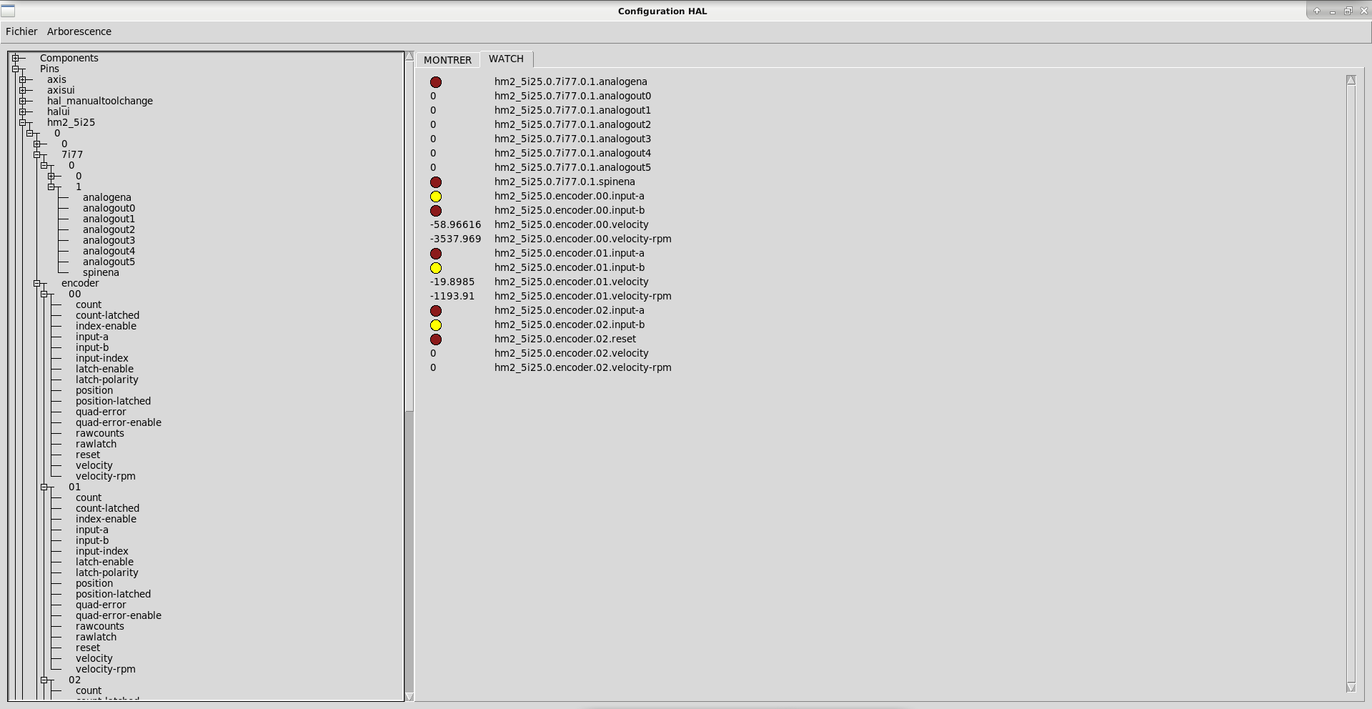

hello there I followed the instructions given but my DRO remains inactive however the coders are well taken into account attached to the photo of the open page. I'm stuck at this level

Upload the hal and ini files here so we can have a look.
Do the numbers move on screen when you move the motor by hand?

oui ils bougent etb meme dans les bons sens et-. voici mes fichiers ini et hal.merci

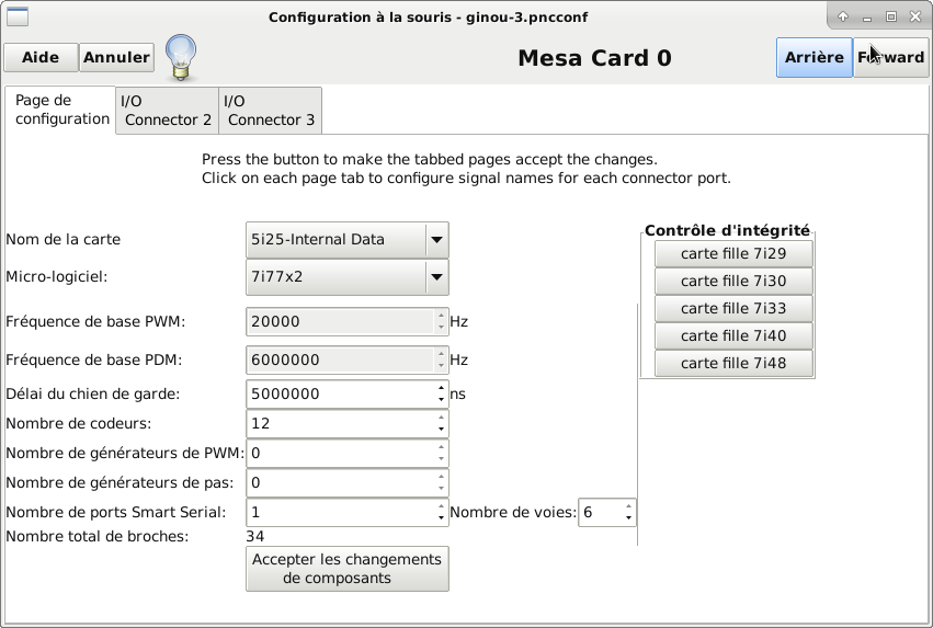

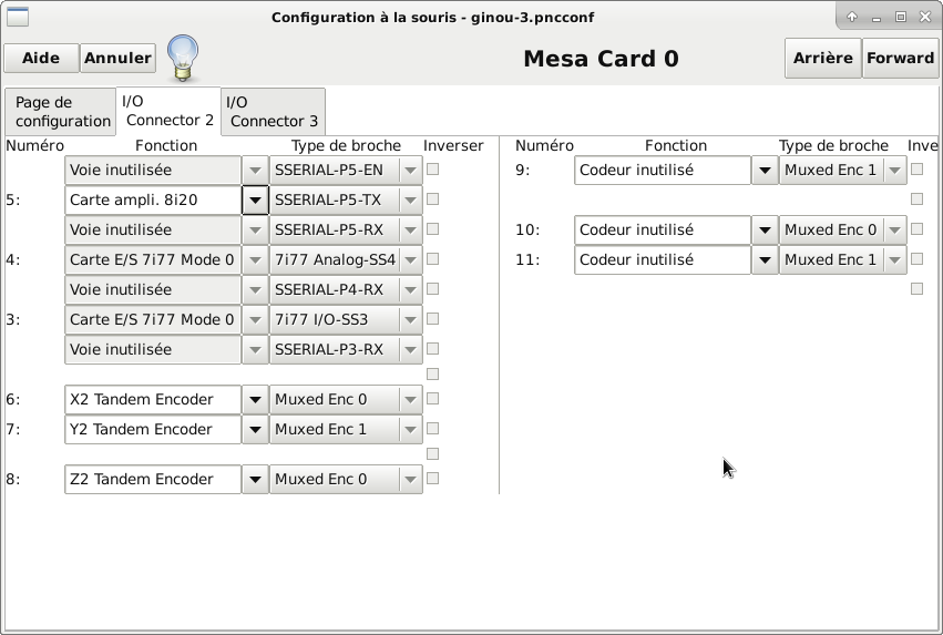

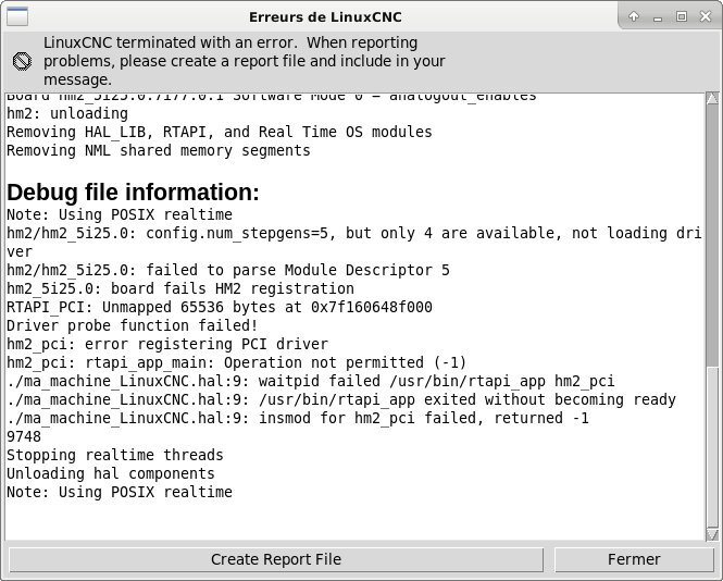

03 Jun 2024 09:13 #302245
by Ginou
Replied by Ginou on topic Deckel FP4A
hello i come back after several inconclusive tests and with almost always the the same message see photo attached

Those errors look like you selected a 5I25+7I76 configuration in pncconf
(the error is because the 7I76 configuration enables 5 stepgens
and you only have 4 in the 7I77+7I78 firmware)
As tommylight said, you should chose 5I25+7I77 in pncconf.
Then get that part working before tackling the 7I78 part
