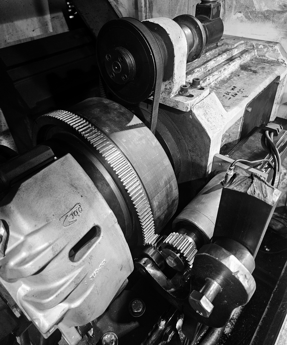

So as far as I can tell there is a few ways to zero out a c axis that can be disengaged.
1, engage the axis drive then drive the spindle around till the spindle reaches its encoders 'z' point.
2, engage the axis drive then re-zero the c axis (it has a prox) then reading both the spindle position and the current position adjust the c axis position. - the c axis position could be set on startup.
3, stuff around and get spindle alignment working (m19) - this is no easy task using modbus for spindle drive. Then drive both to a point where the gears mesh.
What are some solutions people out there have used?

Here's a pic!

After a fair bit of research, looks like it's easy enough to incorporate into the m106 code that will engage the c axis do some math to read the spindle position and do a g10 l20 to set the c axis in reference to the spindle encoder. I will have to work out how to subtract the whole number from the spindle position and just use what's after the decimal place to get a reference to 360degrees. - more reading....

Yeah, I'm just using a cheap stepper drive but it does have an encoder built in so it dosent loose steps, I ran it yesterday for hours running in the gear teeth drive. And the gear engage command would do the g10 l20, so it should be accurate. I'll be testing this next week.
The bit that has me currently is converting 8.5674 etc to eight point five six seven four revolutions, and getting rid of the eight.
