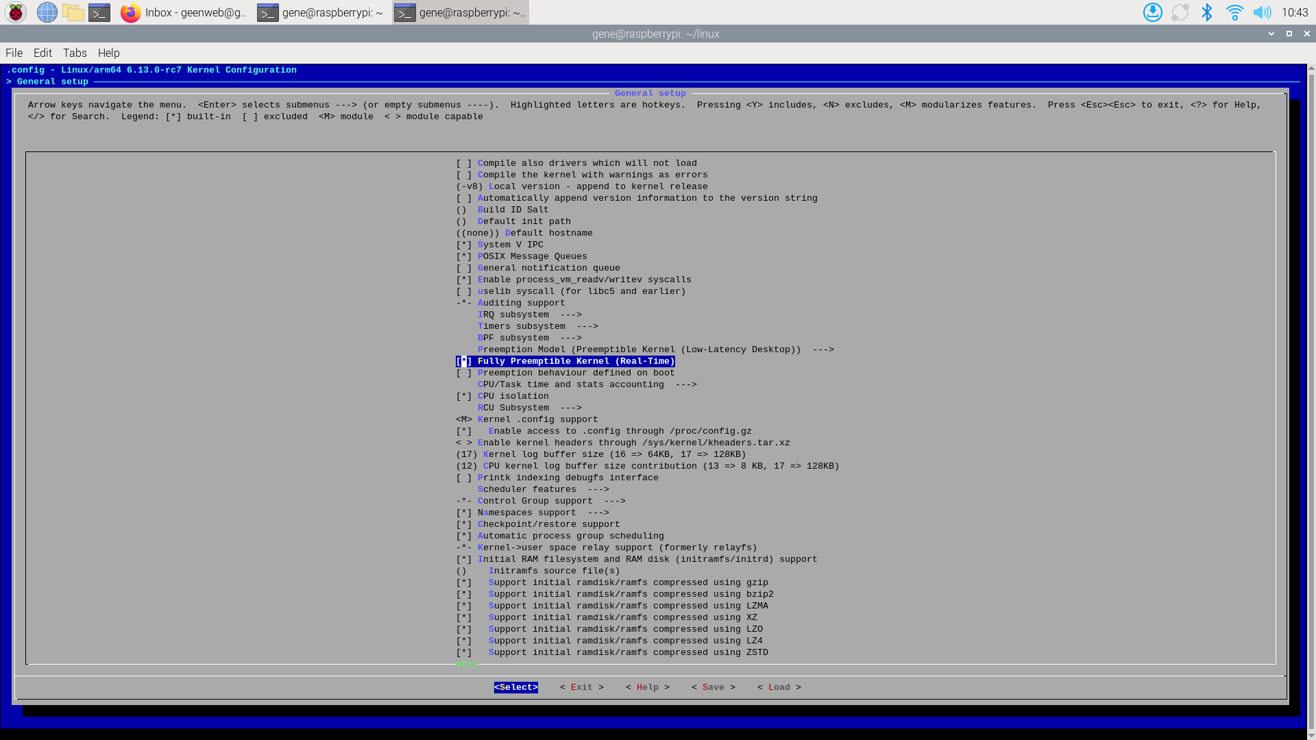

- Hopefully it helps someone trying to do this or something similar. I appreciate the pointers I got from alangibson, cornholio, and rodw
- This is the first Linux kernel I've ever built. So I open this up to comments and suggestions.

Create the base .config file for the Raspberry Pi 4 64-bit:
NOTE: For a Raspberry Pi 5 64-bit the lines should be:
Make / launch the menuconfig utility:
Install the required package:
Under General Setup, select: Fully Preemptible Kernel (Real-Time)Exit and Save.
Change Local version name. vi .config and change the following line:
To:

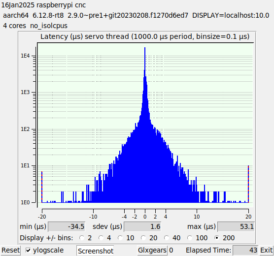

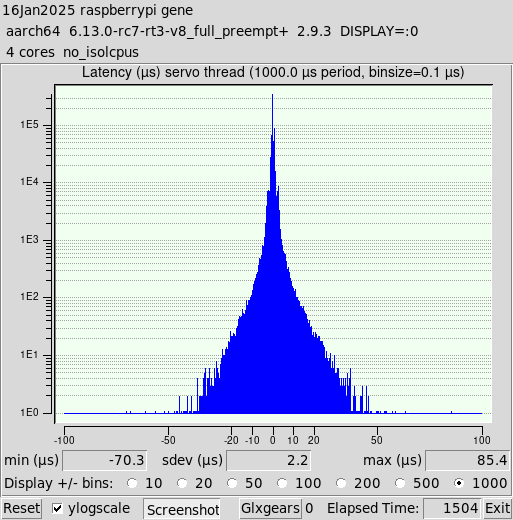

EDITED 1/16/25: Changed image to X11 pre-optimization latency.
Ran a baseline latency test before making any jitter optimizations.
Note: Using POSIX realtime
I checked the real-time attributes of the latency-histogram process (the process ID for this run was 10527):
pid 10527's current scheduling policy: SCHED_OTHER
pid 10527's current scheduling priority: 0
I had thought the policy would be SCHED_FIFO, or SCHED_RR. But even after I added CPU isolation it remains SCHED_OTHER.
I will probably create a separate thread about jitter optimization.
Code:
sudo apt install libncurses5-dev
Code:
make menuconfig
Code:
CONFIG_LOCALVERSION="-v8"
Code:
CONFIG_LOCALVERSION="-v8_full_preempt"
Code:
latency-histogram --nobase --sbins 1000
Code:
chrt -p 10527
