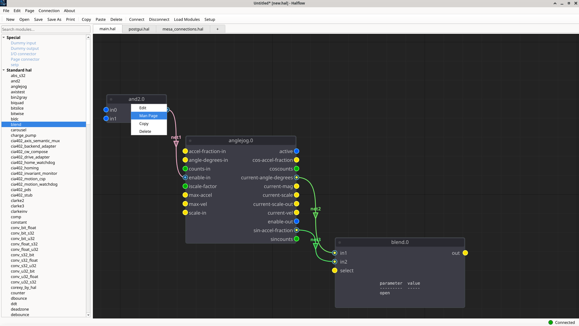

Introducing halflow, an interactive graphical hal editor
- NWE

Goals of this project:
1. Visualization of the current running hal config on any LinuxCNC machine over local trusted network.
2. Editing of parameter values, signal names and values.
3. Automatic detection of loadable hal components on the running LinuxCNC instance.
4. Load/Save configuration projects within the linuxcnc/configs directory.
5. Live parameter and pin value displays while connected to a live hal system.
6. Live editing of the running hal via net, setp, unlinkp, loadrt, and related commands over ssh connection to the machine directly via interaction with the nodes in the canvas. This action will be preceded by a popup strongly encouraging the user to first e-stop the machine. This will avoid having to constantly reload linuxcnc after minor edits.
7. Still dreaming...
Of the above list:
(1.) is working on my pc.
(2.) Is working.

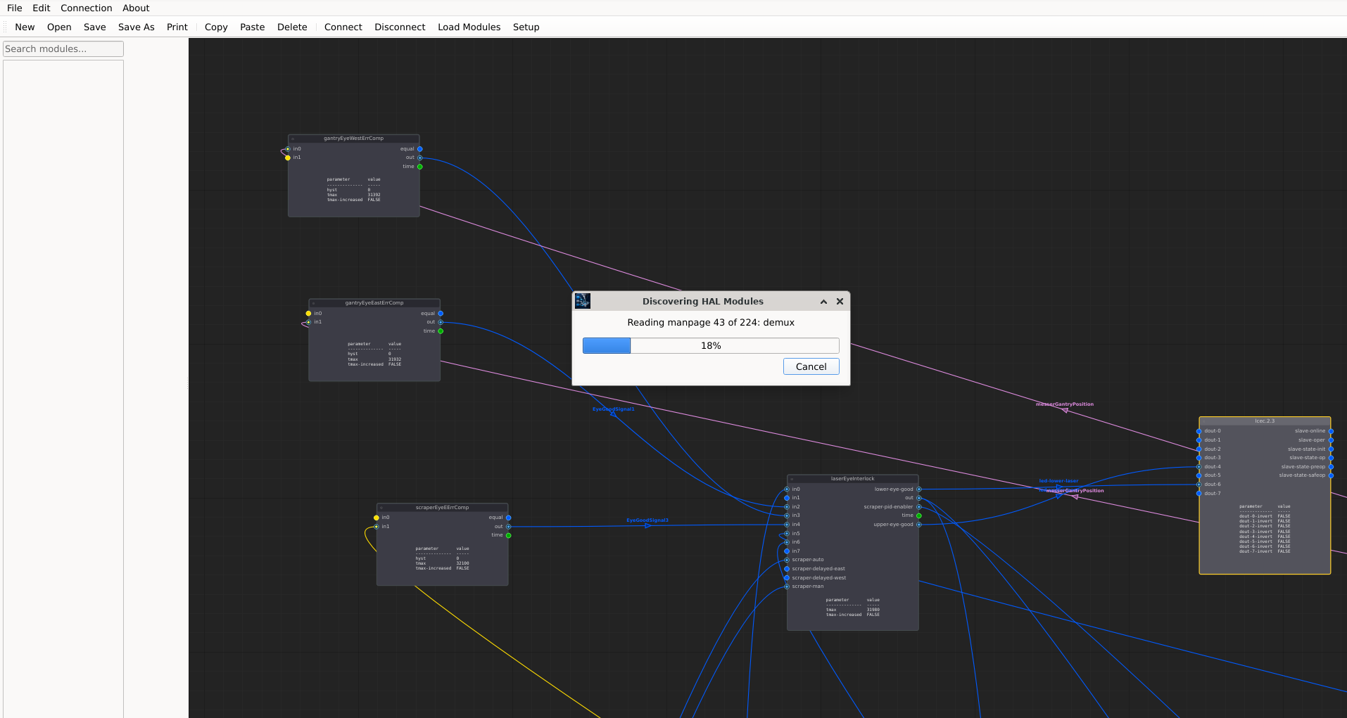

(3.) detects installed components; to properly detect custom components make sure you fully installed with:
sudo halcompile --install my-custom-component.comp
sudo halcompile --install-doc my-custom-component.comp
TODO: find custom python components also.
(4-7) Coming soon...

Replied by NWE on topic Introducing halflow, an interactive graphical hal editor

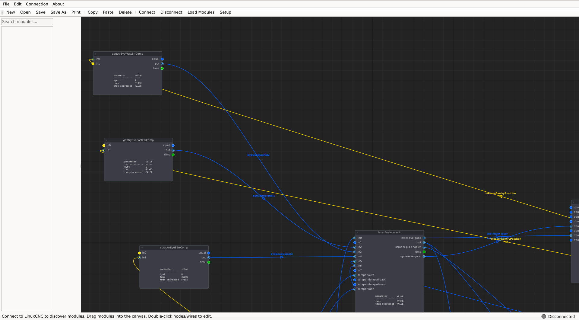

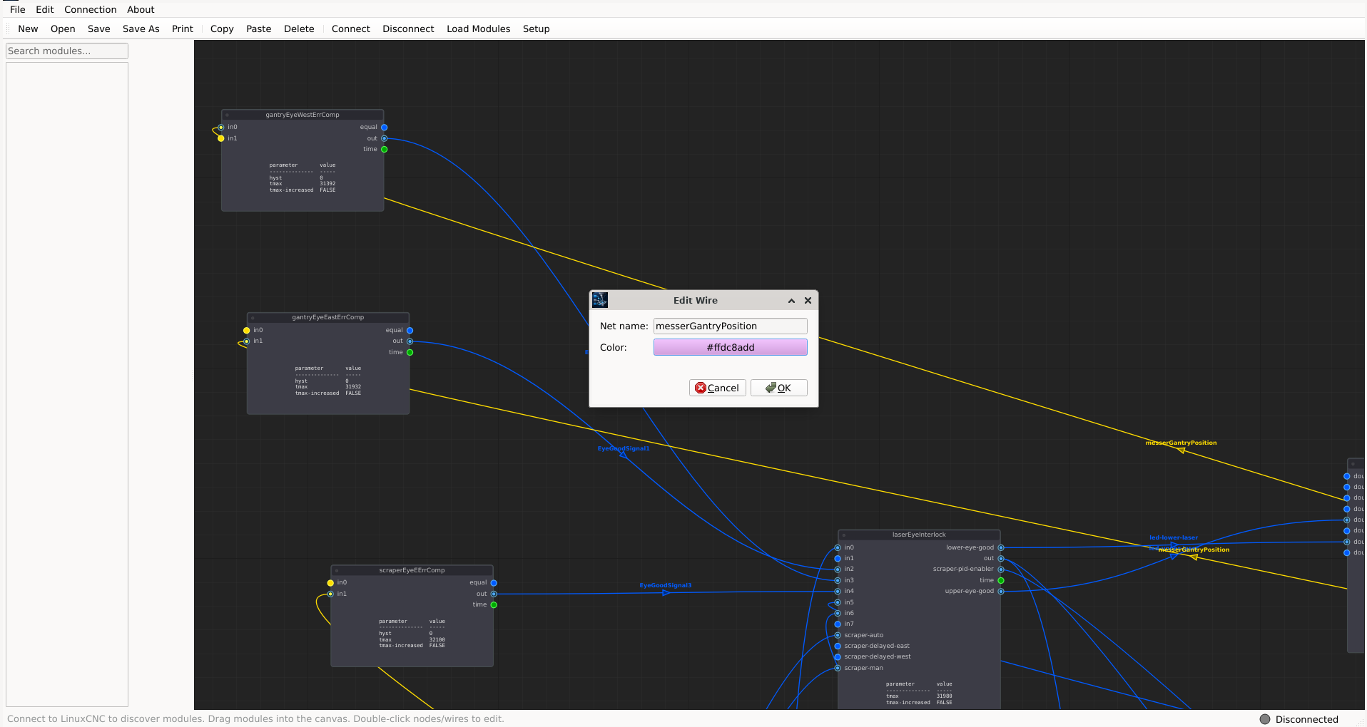

Signal wire colors default to color codes representing the signal type, but can be edited. If the rat's nest is a confusing mess of same-colored wires, double-click or right click a wire to edit its color. All wires connected to the same output are synced and will change to your edit.
You can also change the wire (hal signal) name, but the current version of halflow gives you no capability to load your edits back into your linuxcnc hal config.

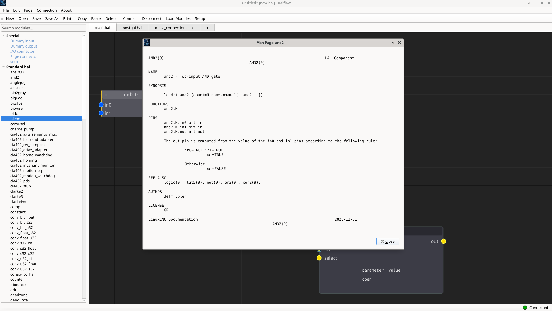

man pages built-in.

This is becoming useful for debugging a running LinuxCNC instance. I still have some features to add and bugs to fix before releasing an installer.
Up-to-date source code is available at the link on my first post.

Some new features added:

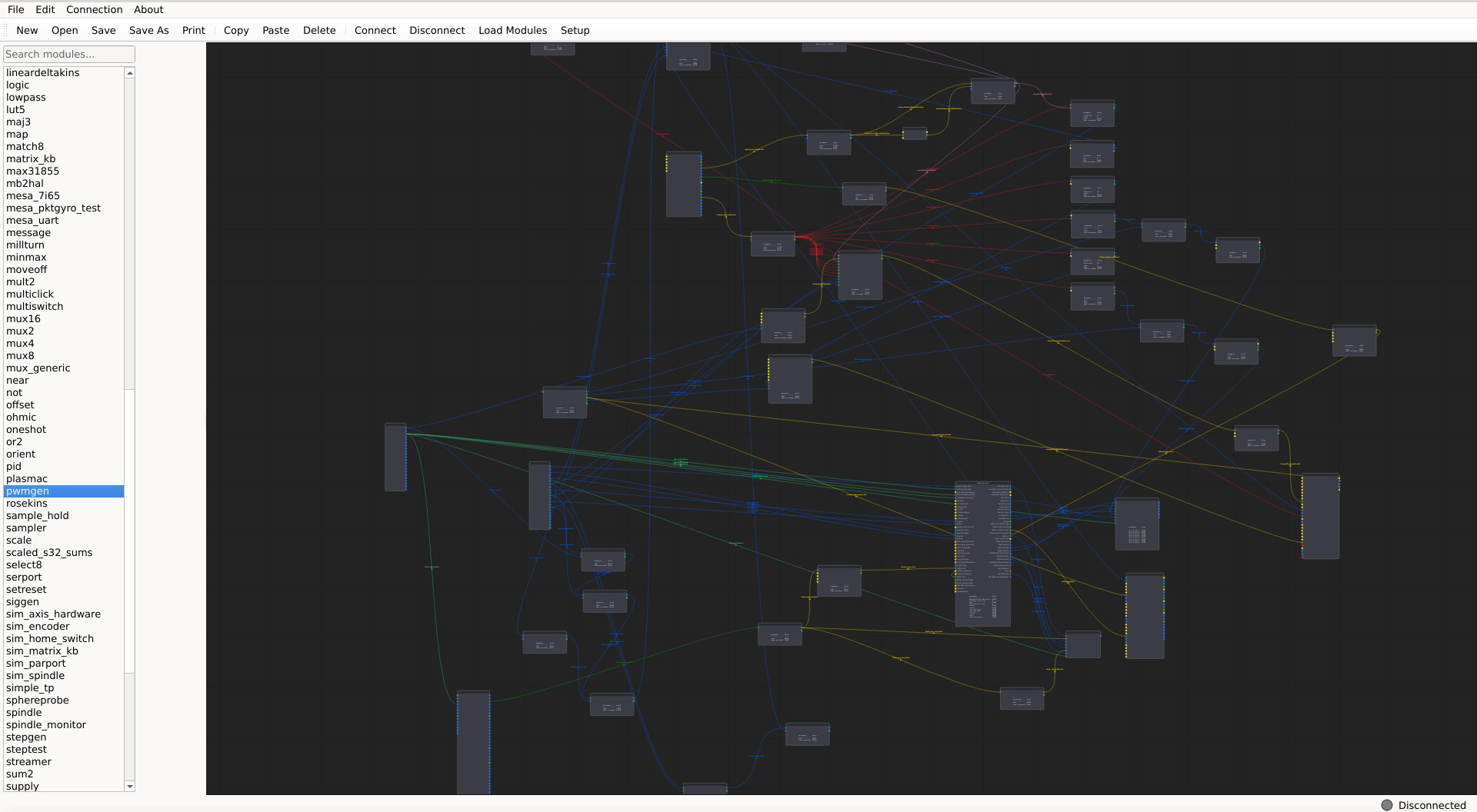

1. Net highliting for easier following of wires that are all part of the same signal: click or hover a wire and all wires on that signal illuminate.
2. Importing/drawing new wires can be configured to A: be colored by signal type, or B: be randomly colored.
3. An auto-placer for optimizing placement of components on the canvas. This feature is currently broken. It runs, but it usually makes a mess.
Current effort is on creating and exporting new configs for actual use in LinuxCNC. This process requires me to better understand the config loading process, so I can cause this to be interactively created by the halflow "New config" wizard. On an impulse, I asked chatgpt to give me a tour of the LinuxCNC config loading process. I found the result quite interesting and am sharing it at [1].
Currently it is possible to import configs NOT created by halflow, but ONLY FOR VIEWING. I am finding this feature quite helpful for visualizing and diagnosing some of my highly customized hand-edited configs.
Installer releases will be provided once I consider the project stable.
As always, the latest source code is available at the link shared in my first post.
