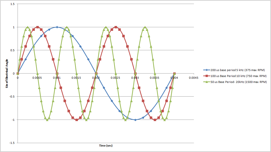

Yes, from what I have seen using both current and phase advance is key to making it work well. It is good to know that softDMC has this function. I didn't really know much about softDMC till I just went and read some of the manual. I noticed that softDMC typically runs at between 15-30 kHz sample rate, this fast sample rate would help with the task of commentating a high pole count stepper motor.
So from what I understand most 3 phase BLDC or AC servo motors have 3, 6, 9, or 12 poles. I think that a common stepper motor with 200 steps per revolution has 40 poles, right? So I would think that it is possible to do what softDMC is doing within linuxcnc with fast enough hardware to close the loop. For example if I were to use a 5i24 card with say a 7i32 or similar card to support current control on the two coils, then it seems that all that would be required is a fast enough servo loop and the right HAL components for a PID loop that would output a signal to a component that would convert the PID output signal to the right current signal for each coil. That component would take both current and phase control into account.
I'm thinking that to get good smooth control there ought to be at least 20 (completely pulled out of a hat after looking at a sin plot approximated with 20 points) servo periods per pole to control the motor with reasonable smoothness. This would be about the same level of smoothness somewhere between 1/4th and 1/8th stepping in open loop. If this were the case, then by my quick calculations a 5khz servo period (200 us) in keeping with that 20 servo periods per pole would results in a maximum rotational speed of 375 RPM. With a 10 khz servo period the max rpm is 750 rpm, and with a servo loop of 20 kHz the max speed would be 1500 rpm and so on. Of course you could control the system at higher RPMs than this but it would get less stable and start to act more like open loop full stepping. See attached graph.
The general control law for the current and phase control might generally look something like this for a two phase stepper motor:
Current in Coil A= pid_output*max_current*sin(mechanical_angle+(pid_output/(pi/2))
Current in Coil B= pid_output*max_current*cos(mechanical_angle+(pid_output/(pi/2))
So, i know that I have heard of mesa pci cards operating with a servo period of 5khz, but what is the real practical limit with low latency and jitter?
Also please let me know if i'm way off base.

Yes, you are right, 50 poles, I transposed a number in my spreadsheet. . So the RPMs I stated should have been 300, 600 and 1200 respectively. Certainly it is more difficult to control a motor with a pole count that high in comparison to typical AC servo motor, or at least it will require a faster control loop.
