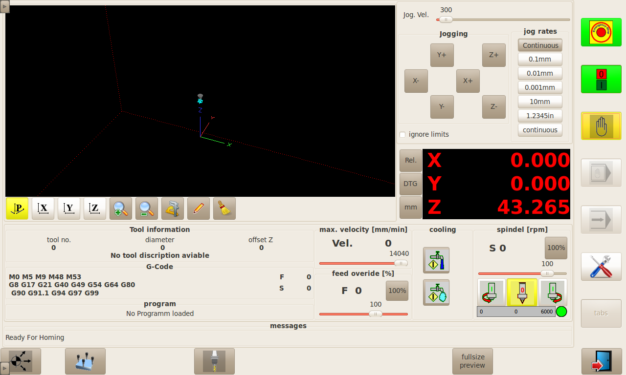

Thank you Norbert for the nice GUI, Chris for pushing it to the master.
I have missing icons after installation:
Originally the "icon" directory under gmoccapy was not existing, I created it and copied the content of "/usr/share/mocca26/skins/hh1280x1024" into it. However it still not enough, some icons are still missing.
I checked the downloadable moccagui debian packages, but couldn't find the icons either.
Regards:
James
**** GSCREEN INFO: Using LOCAL glade file from /home/bj/linuxcnc/configs/sim/gmoccapy/gmoccapy.glade ****
/usr/bin/gscreen:418: GtkWarning: Could not load image 'icon/Logo.png': Failed to open file '/home/bj/linuxcnc/configs/sim/gmoccapy/icon/Logo.png': No such file or directory
self.xml.add_from_file(xmlname)
/usr/bin/gscreen:418: GtkWarning: Could not load image 'icon/clear.png': Failed to open file '/home/bj/linuxcnc/configs/sim/gmoccapy/icon/clear.png': No such file or directory
/usr/bin/gscreen:418: GtkWarning: Could not load image 'icon/dimensions.png': Failed to open file '/home/bj/linuxcnc/configs/sim/gmoccapy/icon/dimensions.png': No such file or directory
.Originally the "icon" directory under gmoccapy was not existing, I created it and copied the content of "/usr/share/mocca26/skins/hh1280x1024" into it. However it still not enough, some icons are still missing.
Regards:
James

22 Mar 2013 07:20 #31703
Replied by cmorley on topic Gmoccapy - A new screen for linuxcnc
James is this a run-in-place/git version or a installed from buidbot version?
Chris M

Hi Chris,
On this particular system I use buildbot version. The 2.6.0-sim config selector showed the gmoccapy configs, I choosed one.
Last night I installed the moccagui from debian package on a 2.5.2 LinuxCNC (ubuntu 10.04) system. I got no errors about missing icons, although no fancy icons either in moccagui, just text labels on each button.
Maybe I shouldn't mix the two installation versions in one thread here.
Regards:
James

- Posts: 7368
- Thank you received: 2181
22 Mar 2013 11:13 #31710
Gmoccapy (or Gscreen) will not run on version 2.5.2, only master.
This surely is a packaging problem - I only use the RIP versions built from source.
I will have to do more research this weekend.
Chris M

26 Mar 2013 01:55 #31871
by newbynobi
Replied by newbynobi on topic Gmoccapy - A new screen for linuxcnc
Hallo James,
I just builded a virtual machine and tried gmoccapy under buildbot.
Unfortunately buildbot does not include all the sub folders from gmoccapy, not only the icons folder is missing, also the subroutine folder, so you will not be able to execute macros in MDI mode.
May be Chris can give us a hand, finding out, why the sub folders are missing.
Please use until then a git copy from master. It has just been updated to ver. 0.8.6, and does now export HAL pins to adjust the sliders for jog-velocity, Max-veloxity. feed-overide and spindle-overide with attached MPG wheels.
You will find an example how to connect the MPG wheels to the hal Pins in gmoccapy_postgui.hal. The lines are commented out, because the use a parport and otherwise the sim version will not work.
To include the icons in moccagui, you will have to edit the corresponding XML Files of that GUI.
Again: moccagui and gmoccapy are not the same and are written in different languages!
