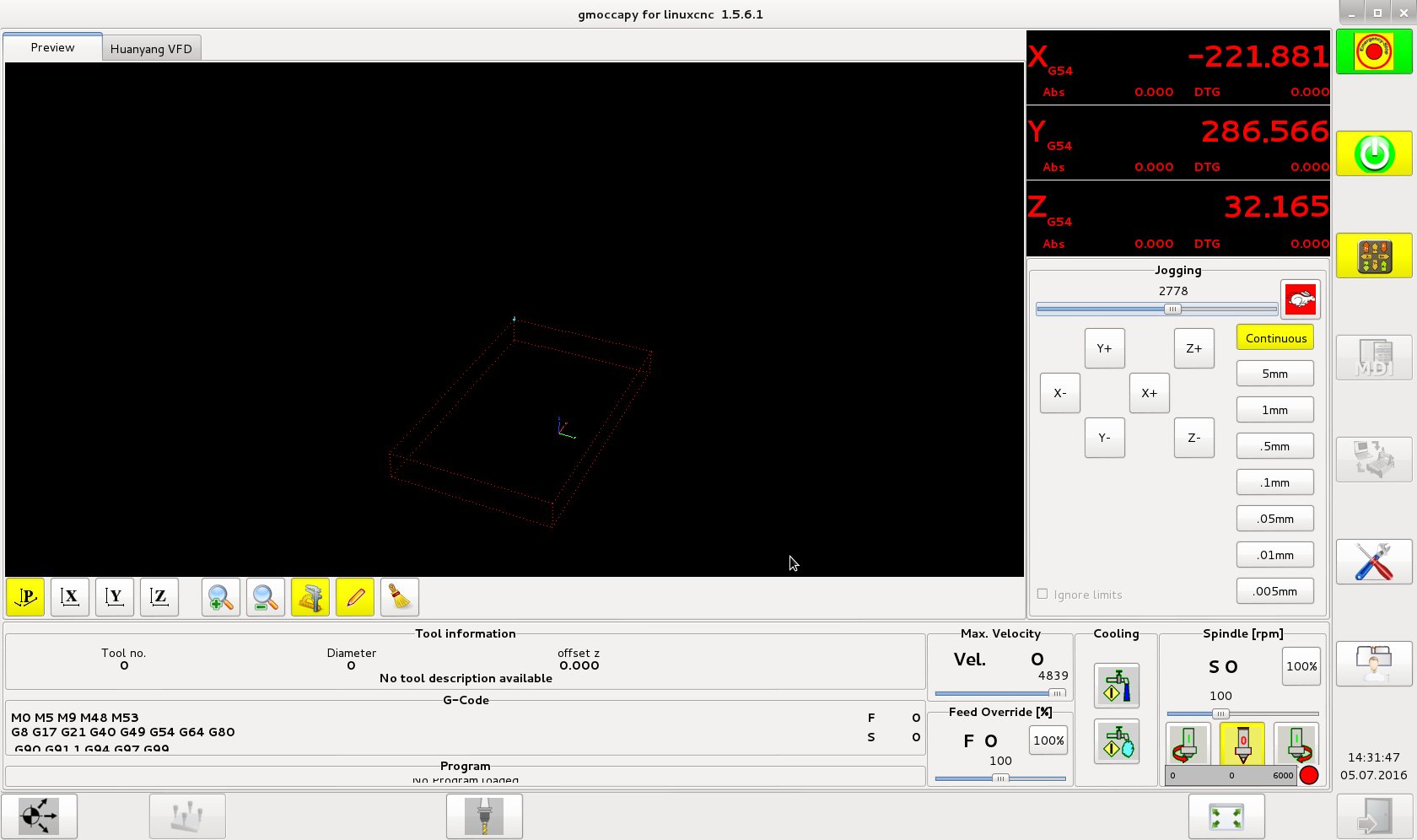

I have configured gmoccapy and works ok but it crops the letters in
G-code and Program label.
Also it shows me warnings when i start in terminal
Any fix for this ?
See attached screenshot
/usr/bin/gmoccapy:153: RuntimeWarning: missing handler 'on_btn_load_state_changed'**** No gmoccapy2.glade file present ****(gmoccapy:13343): GtkSourceView-CRITICAL **: gtk_source_language_manager_set_search_path: assertion `lm->priv->ids == NULL' failedAny fix for this ?

06 Jul 2016 16:39 #77090
by newbynobi
Replied by newbynobi on topic Gmoccapy config
Hallo vre,
lets begin with the errors and messages at start up:
first one has been solved with gmoccapy release 1.5.6.3 (27.05.2016), you are using 1.5.6.1, unfortunately I have no influence, on the schedule of releasing new packages. It is included in the 2.7 branch on git and github and should also be in the buildbot version.
second one is only an information, that you ddo not have a gmoccapy2.glade file, that one is not needed, but can be used a user extension for the GUI
Third one is named critical, but has no influence, as the file is registered correctly, I have not jet found a solution to avoid this message, caused by GtkSourceView.
Cropping part of the GUI:
What screen resolution do you use?
Have you tried to go to the settings page and change the appearance from window to fullscreen?
IMHO it should fit, if you delete on of the 8 increments.
So there are several possibilities to solve your issues.
Thanks for using gmoccapy
Norbert

06 Jul 2016 18:47 #77097
by vre
Replied by vre on topic Gmoccapy config
iam using 1680x1050 i deleted increments tried full screen but the cropping remains.
It is only fixed if i go to gnome advanced settings in fonts and decrease text scaling factor to 0.7 but then the letters become so small
