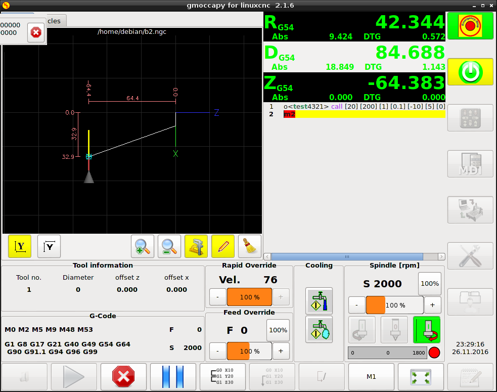

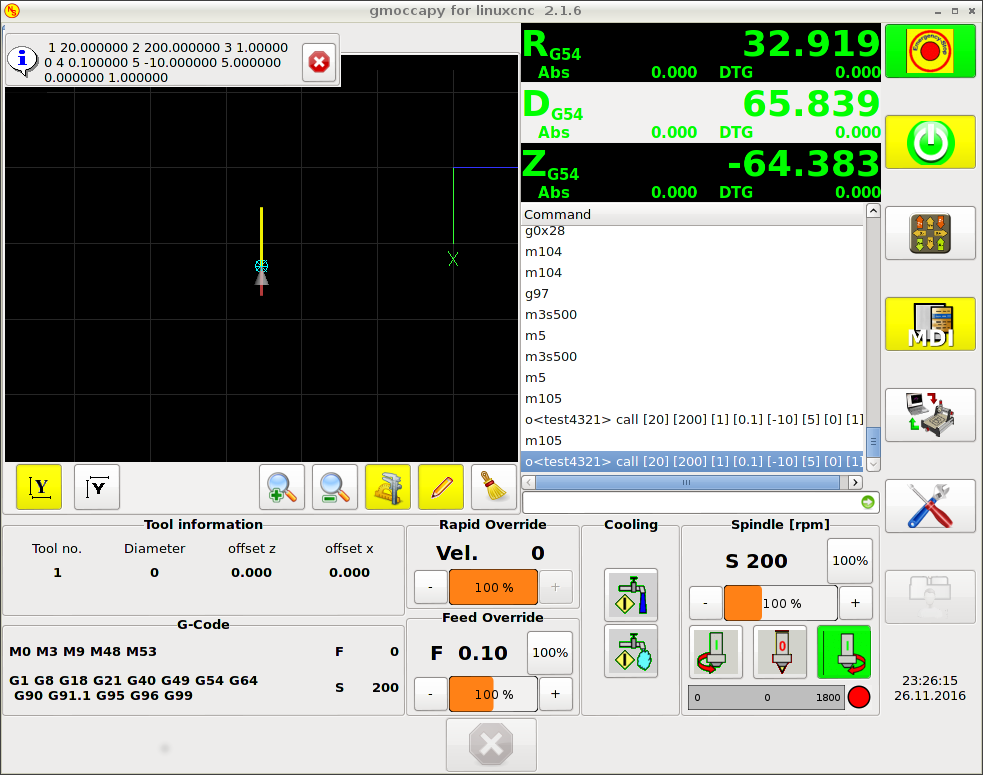

I have tested to call a subroutine from the mdi and get a result I didn't expect.
I don't seem to be able to use constant surface speed when calling the subroutine
from the mdi, instead a constant rpm is selected for the spindle, from the S parameter.
When I write the very same line in a file.ngc and run that, the CSS works,
the spindle speed up and down as expected when moving in X.
That's how it is for me in gmoccapy in 2.7.6 and also in master. In axis, css works.
I attach the ngc file with the subroutine. I call it with
o<test4321> call [20] [200] [1] [0.1] [-10] [5] [0] [1]
I did take screenshots when running from mdi and from file.
I attach them as well. I can see that there are differences.

29 Nov 2016 09:28 #83419 by Hakan
Replied by Hakan on topic Calling subroutine from mdi?
Andy, perhaps you recognize the code snippets, it comes from your excellent lathemacro package. I can't make it work in gmoccapy. Under Axis it works though. I like colors a lot so I want to run it under gmoccapy. Do you know if your macros work under gmoccapy?
I have tried to make the example a bit cleaner and removed stuff I didn't fully understand.
The movement I have put in there is just a relative move + and - 10 mm from the position shown in the screen dumps, so I can hear the spindle speed change. In the mdi case, the spindle speed is constant at 200 rpm. In the file.ngc case, the spindle speed is perhaps 1000 rpm and changes as the X axis moves - like it should.
newbynobi: I am for sure not an expert of G code, but I thought G96 just specified how the spindle speed should behave. On the following line the spindle is started and some lines further on there is actual movements. There are no error messages.
I have tried to trace the command, and in the lathemacros case the command is executed by EMC_Action_MDI from glade, which is a more or less unknown environment to me.
It could of course be my configuration, but how should I start to investigate this?
