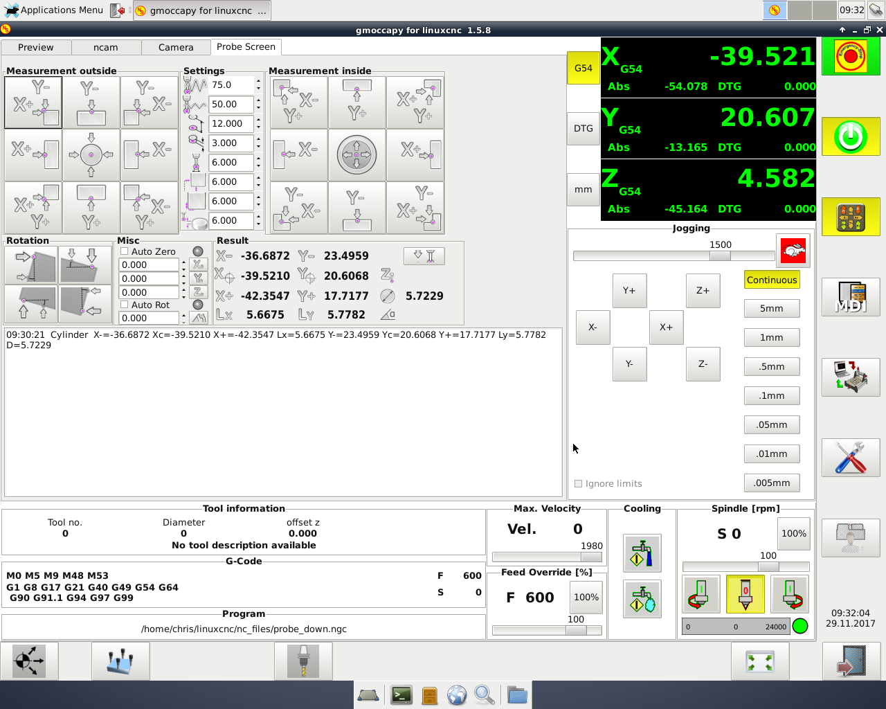

is anyone using the probe screen by the russian guy, 'verser' with gmocappy? All working? Any problems? It seems to have stopped working with latest linuxcnc version, I think it might be a glade problem but I have no experience with this really...

Hi John, I have checked the probe cylinder this morning, all ok.
I am using gmoccappy 1.5.8 debian 7.11 linuxcnc 2.7.11

I am using linuxcnc current master 2.8. All was working fine with 2.7.11
After upgrade it does not work any more.

Give me a view days, i will check on this with gmoccapy, even if it seems not to work with axis eather.
Unfortunately i have no probe, so my test may be limited, or do someone like to sponsor some hardware ? ☺
May be I even rewrite the code, as i saw potential to optimize.
I will test with the latest master and report.
Norbert

Hi Norbert,
there may be a spare probe sitting around gathering dust. Ask Rene-dev
This evening there was some small action on irc. I think maybe a bug was found in probe_screen.py, line 413, def gcode is wher the problem appears to be coming from, user 'hazzy' knows more and is trying to fix this now..

I just tested with brand new master and gmoccapy 2.3.3 and it does work with gmoccapy!!
Find attached my config directory for simulated application.
To test set:
and push the probe button while the vel changed to 150 and a second time the vel changed to 10.
(Just push, do not hold down, as this is a mometary switch to simulate probe contact.
Norbert
To test set:
