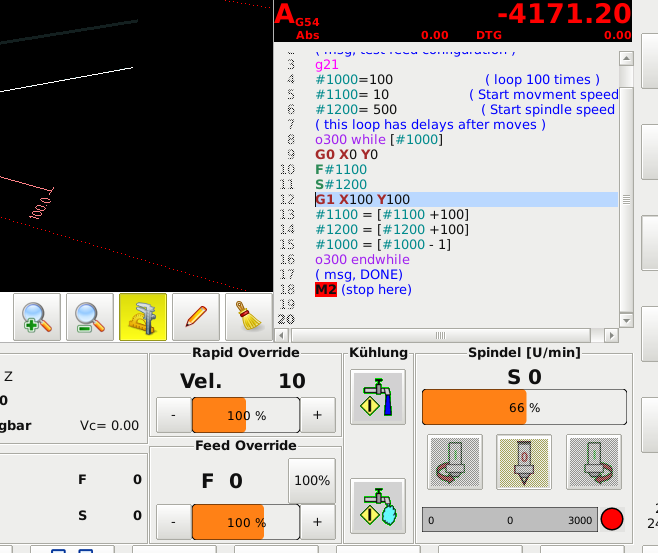

24 Feb 2018 21:27 #106460
by Mike_Eitel
Replied by Mike_Eitel on topic Gmoccapy feed on screen
NOW it gets interesting.
MIDI F300 works but the following test program not:
feedtest.ngc
( test program to see Feed changing )
( msg, test feed configuration )
g21
#1000=100 ( loop 100 times )
#1100= 10 ( Start movment speed )
#1200= 500 ( Start spindle speed )
( this loop has delays after moves )
o300 while [#1000]
G0 X0 Y0
F#1100
S#1200
G1 X100 Y100
#1100 = [#1100 +100]
#1200 = [#1200 +100]
#1000 = [#1000 - 1]
o300 endwhile
( msg, DONE)
M2 (stop here)
IMAGE is while correct running program ;-(
THX Mike

- newbynobi
- Posts: 1931
- Thank you received: 394
24 Feb 2018 22:03 #106462
by newbynobi
Replied by newbynobi on topic Gmoccapy feed on screen
F value is read ahead, your programm has finished reading ahead, before your programm even starts moving.
I will check your code on my machine tomorow.
Norbert

- newbynobi
- Posts: 1931
25 Mar 2018 10:03 #107802
by newbynobi
Hallo,
I just checked your sample file. And the read ahead does cause the "feed display" problem. There is some work going on a branch called "statetags" to solve the read ahead problem.
So no solution for now.
Norbert
Norbert
