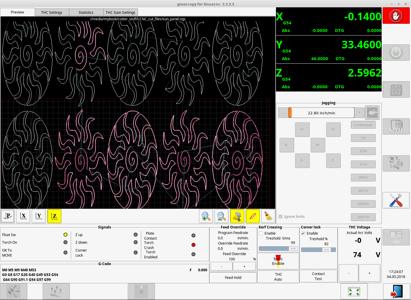

Hello
Does anyone have any ideas about what may be causing the preview display to be squished?
It certainly isn't a show stopper but it would be nice to have the aspect ratio of the display correct.

I have been doing some testing today without much success but have the following observations:
1. My machine is a gantry machine using the master 2.8-Pre branch. The mechanics work correctly.
[KINS]
KINEMATICS = trivkins coordinates=XYZY
#This is a best-guess at the number of joints, it should be checked
JOINTS = 4
and
[TRAJ]
AXES = 3
COORDINATES = X Y Z
LINEAR_UNITS = inch
ANGULAR_UNITS = degree
CYCLE_TIME = 0.001
DEFAULT_LINEAR_VELOCITY = 0.38
MAX_LINEAR_VELOCITY = 8
#NO_FORCE_HOMING = 1
2. I have both a Gscreen and a Gmoccapy configurations. The "squished" preview is actually a Y values times two. The measurement "rulers" and numbers are corrected but the plot is Y times 2.
3. I have tested by loading gcode files I created and ones in the distro. Both exhibit the same behavior.
4. When I run any of the sim configurations from the distro the preview is correct.
5. When I home my machine using either working configuration the Y axis travel is shown as being twice the distance actually traveled in the preview. The main DROs display the correct travel distance.
6. The aspect ration of the preview background grid is correct (1:1).
Ok, I know this isn't much to go on. Does anyone have a clue about what is happening or further testing to be done?
John

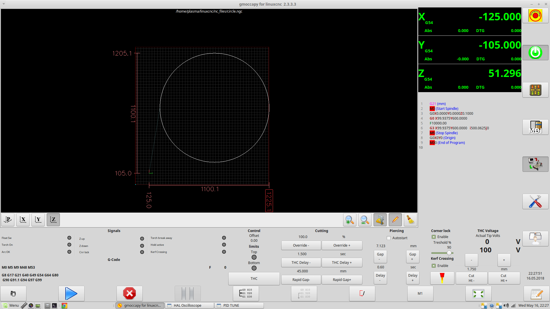

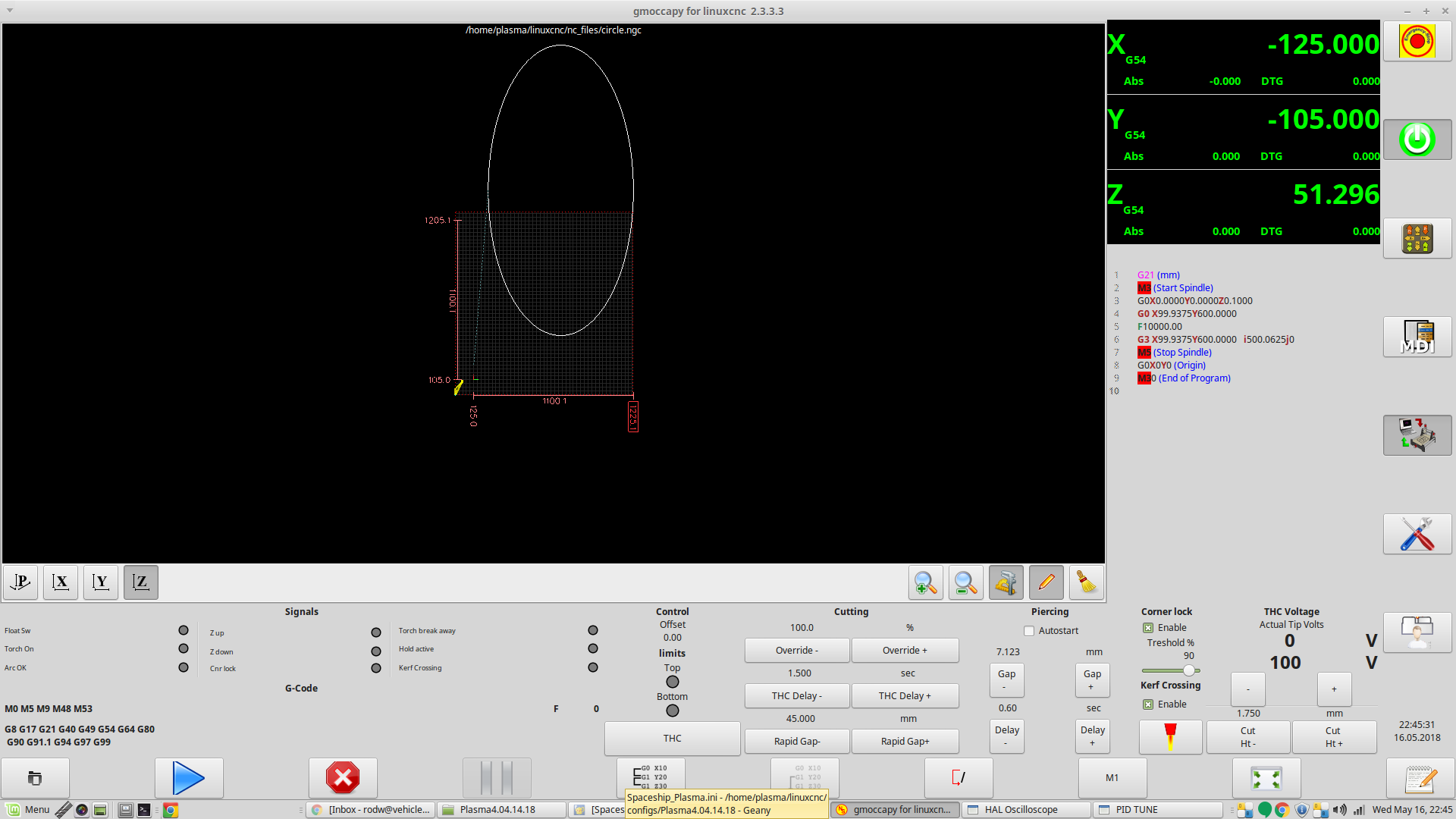

I am sure that you have
in your ini file as this gives an egg instead of a circle
the correct setting should be
which will correctly display a circle
the GEOMETRY= setting has nothing to do with joints and axes but configures the number of DRO's etc (and apparently the gremlin preview).
try it with this gcode file
[DISPLAY]
GEOMETRY=XYYZin your ini file as this gives an egg instead of a circle
GEOMETRY=XYZwhich will correctly display a circle

Rod
You nailed that one. I thought that I had tried using just GEOMETRY=xyz during part of my testing but must have missed it.
So this looks like a case where the very "concise" docs can use a little updating for when a JA branch is used and when the JA branch auto configure script runs it should check this entry. A little better explanation about how the axis/joint definitions work together in the [TRAJ} and [KINS} sections of the .ini file and that they don't control what happens in the Gremlin Preview will be helpful as well. This was very confusing as the machine otherwise was working correctly.
