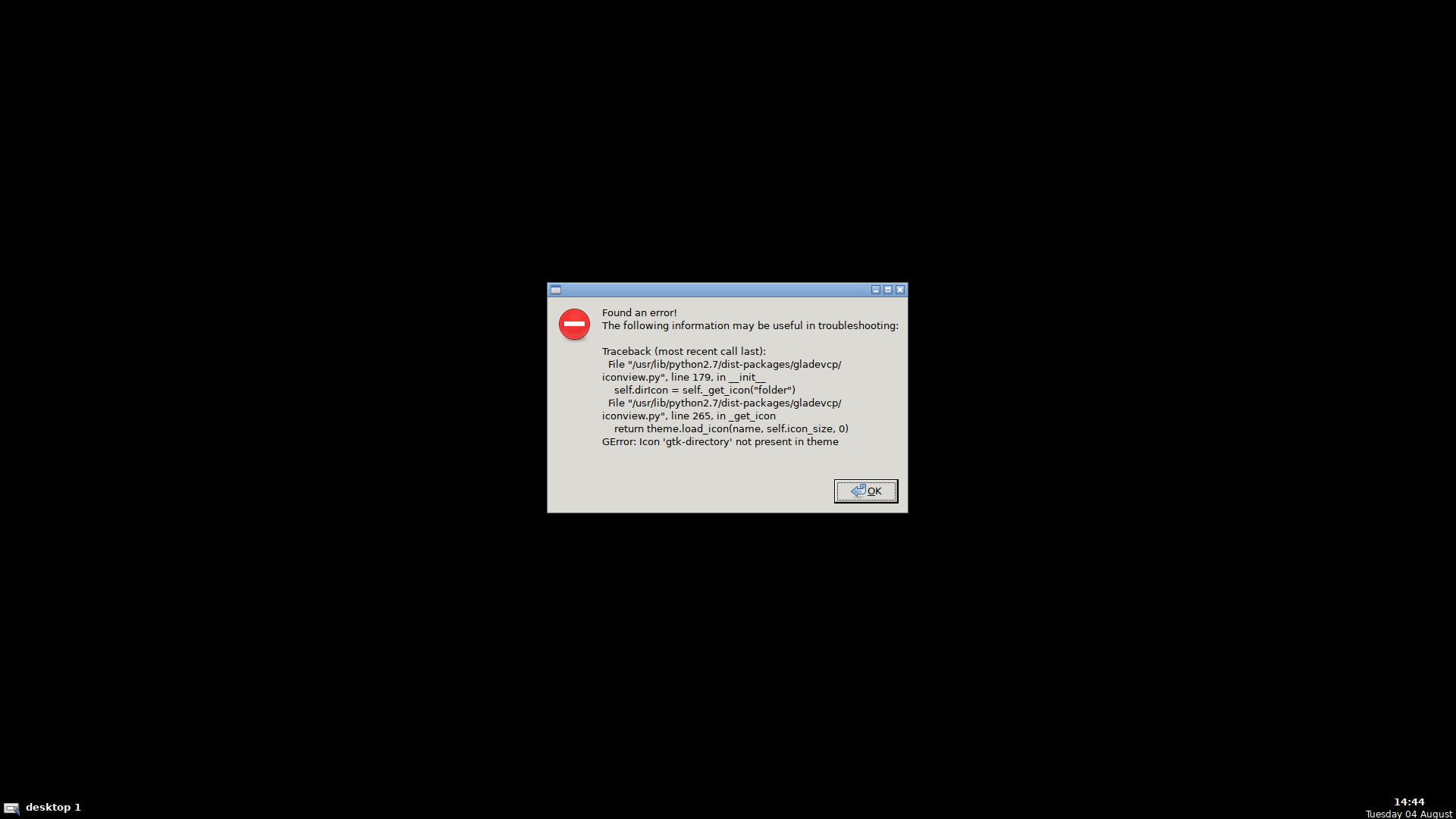

Hi.
I have got precompiled deb package with Linuxcnc-uspace 2.9.0-pre0 for Ubuntu 18.04.
It works well with Xubuntu 18.04 or Linux Mint 19.3, it's no wonder because that are similar systems.
I can install this package on basic Ubuntu installation with xserver-xorg and openbox only.
All works but Gmoccapy.
The error messages are unclear and completely unusable.
Of course its due of lack some files in system.
All dependiences of Linuxcnc are installed, apt program gives no error messages.
Somebody can tell me, whitch package should I install ?

05 Aug 2020 07:02 #177385
Replied by andypugh on topic Hidden Gmoccapy dependencies
I wonder what icon it can't show at 48x48?
The line number shown seems to be unhelpful.

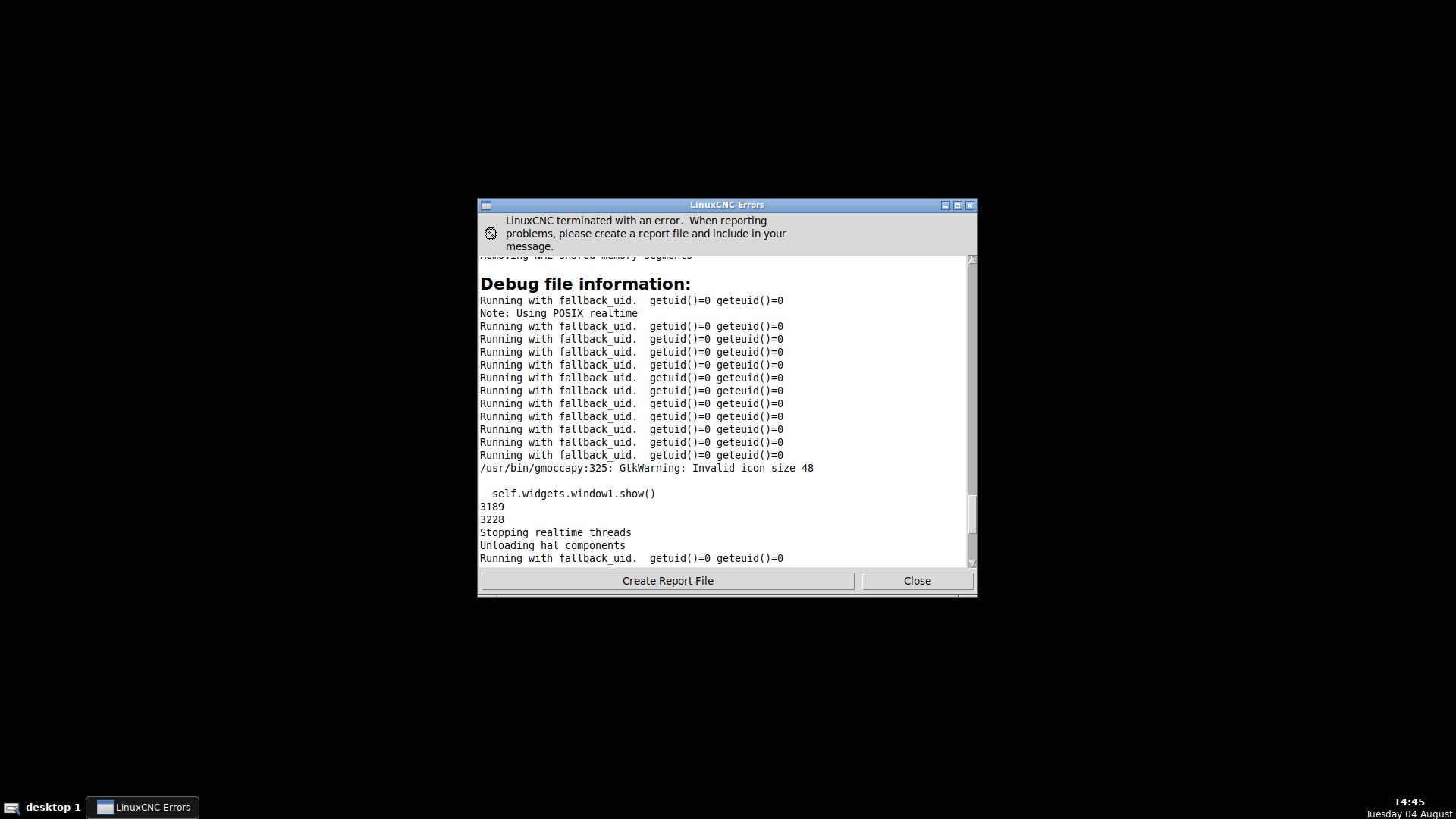

05 Aug 2020 09:32 #177391
by tuxcnc
Replied by tuxcnc on topic Hidden Gmoccapy dependencies
I have compilled Linuxcnc to deb package on Xubuntu 18.04 and ALL works icluding Gmoccapy. On Linux Mint 19.3 the same.
This same package was installed on basic Ubuntu 18.04 (no gnome, gtk etc., only xserver-org and openbox), and all work excluding Gmoccapy.
I can run Axis and others, but only Gmoccapy failed at start.
The only possible reason is lack some files, used by Gmoccapy, but not listed in Linuxcnc dependiences.
The compillation was succesfull, the installation was succesfull, but program not works - this is not acceptable.

lsof | grep gmoccapyPlease Log in or Create an account to join the conversation.
- Posts: 7368
- Thank you received: 2182
09 Aug 2020 02:45 #177731
Replied by cmorley on topic Hidden Gmoccapy dependencies
This looks similar;
stackoverflow.com/questions/35794241/mel...present-in-theme-wha

09 Aug 2020 03:13 #177733
by tuxcnc
Unfortunately, apt-get install --reinstall gnome-icon-theme is not the solution.
- Posts: 7368

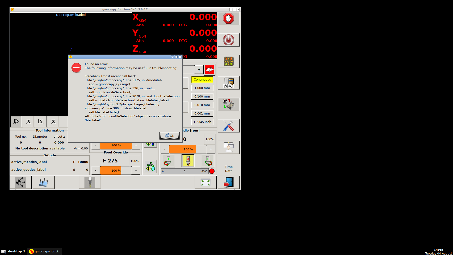

09 Aug 2020 03:17 #177734
does gscreen load properly?
