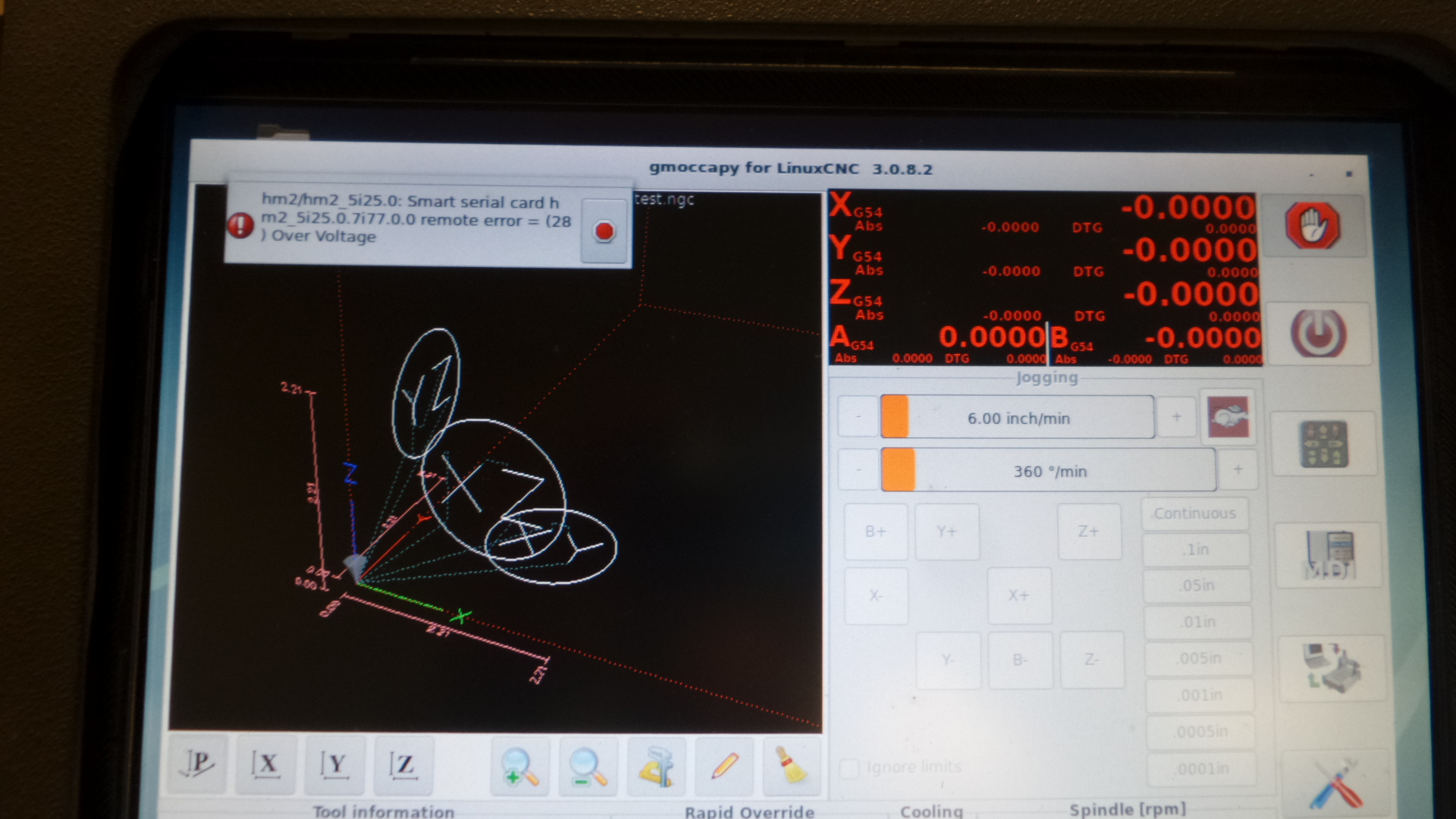

Iltereally changed nothing on the machine since it was last running fine and now I have a new error:
hm2/hm2_5i25.0: Smart serial card hm2_5i25.0.7i77.0.1 error = (28) Over
> Voltage
I am unable to turn on the machine. Halmeter doesn't seem to read the actual values going to the inputs.
If I hit e-stop on gmocappy it says it : Error: External ESTOP is set, could not change state.
I checked that all power supply voltages were proper and all was good.
Checked if any inputs were reading high voltages and found nothing.
Would this possibly be the Desktop PC's power supply voltage is too high.

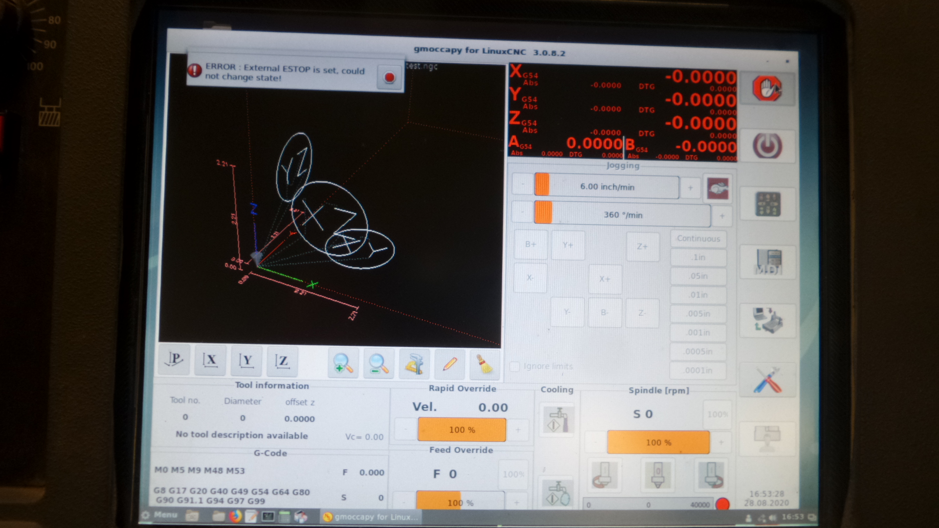

> Voltage

Replied by PCW on topic New error No control?? 5i25 7i77 Over Voltage!
That error would indicate that the 7I77s field voltage was too high

- Posts: 18122
- Thank you received: 5337
28 Aug 2020 20:40 #179899
OK well for some reason the field I/O section of the 7I77 thinks the field
voltage is too high. Is it possible there is some debris or contamination
on the 7I77?
