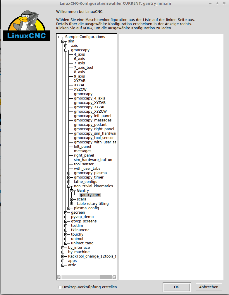

Hallo,
thanks for reporting, that is an bug, I need to fix!
Strange is, you can home the machine and the button appear. Switching then to joint mode results in not having any jog button.
By the way, why someone wants to use Joints mode on a Gantry? It is dangerous jogging only Y1, or are there reasons to do that?
I have not rebuild my gantry, will do this this year, but mine has only one Motor for Y, moving both Y ball screws with a belt.
Norbert
Norbert

@creative25,
no! If your config has negative numbers for home sequence, you not even be allowed to jog a joint Y or Y2 if that joints are not homed.
Have you in your INI HOME_SEQUENCE = -2 für both Y joints?
This could be a typical double Y joint config for a gantry:
Norbert
