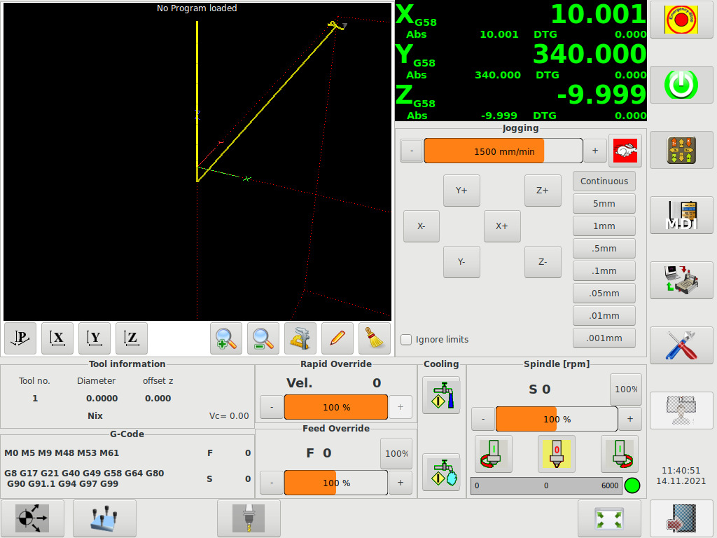

It's about my Maho MH500,
forum.linuxcnc.org/42-deutsch/42077-maho...-plugandplay?start=0
running with linuxcnc 2.8.2 and gmoccapy.
Beforehand the machine was configured with this basic configuration.
forum.linuxcnc.org/30-cnc-machines/41442...tion?start=20#204531
so started with Axis, and then only changed to gmoccapy in the configuration.
What I noticed now is that after the homing the wrong DRO is displayed first
G58 is displayed, but with the machine coordinates on the right. If I really want to see g58, for example, I must first call a g57 and back again aug G58, then the DRO output is also correct.
Have googled , on github I have found exactly such an issue from 2016.
github.com/LinuxCNC/linuxcnc/issues/157

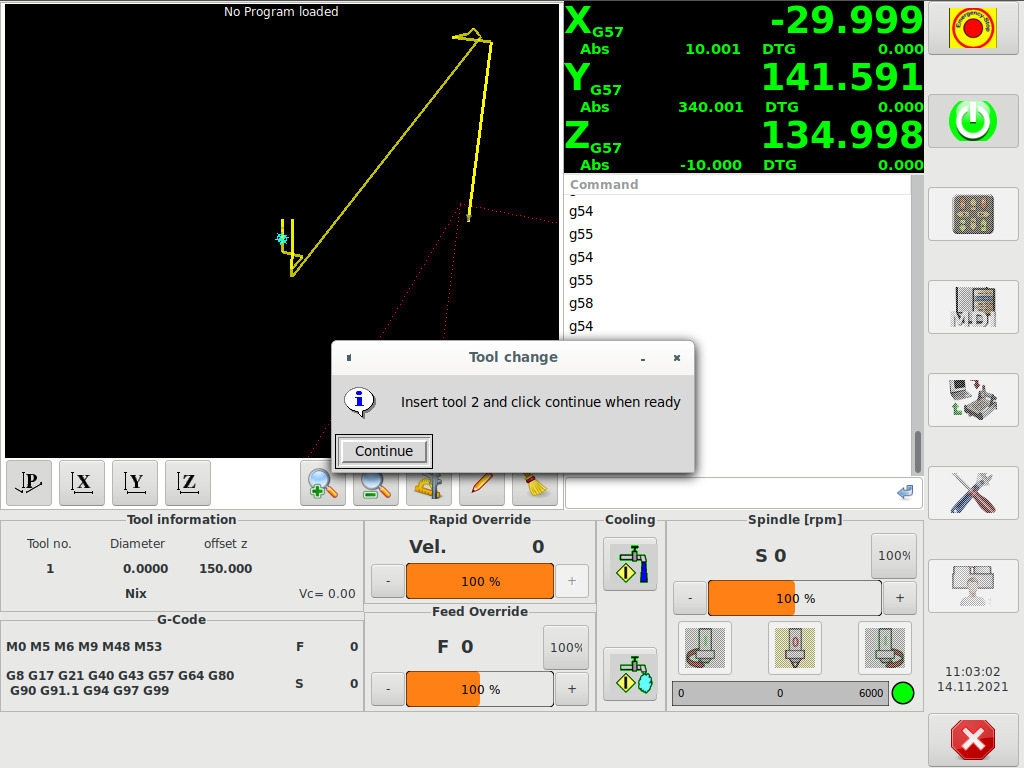

The next thing would be the tool change.
works fine , but with the axis window.
Probably because my configuration was only changed to gmoccapy, from axis.
Afterwards I have to look again at the connections in the Hal and compare them with a gmoccapy example
but at least with the DRO story I'm quite at a loss
My configuration folder is on github
github.com/DoWerna/maho_retrofit/blob/master/basic7i97.hal
github.com/DoWerna/maho_retrofit/blob/master/basic7i97.ini
github.com/DoWerna/maho_retrofit/blob/master/custom_postgui.hal
and the entire folder

Just test renamed the .var .pref files and restarted the machine.
Unfortunately without success the DRO still shows the wrong values at startup.
Only when I run a G55 and G54 the G54 values are displayed.

Yes
I have just inserted the line.
but has unfortunately brought nothing.
After homing, the Abs coordinates are always displayed in the DRO, although the values in the DRO are labeled with G55.
to see the real G55 values you need a G54 and then G55

apparently not after all
after the reinstallation everything worked.
after homing were always immediately displayed the correct values in the DRO.
Have now switched to the Gmoccapy Toolchange window...
I have really only edited the configuration files and started some previus configs for testing
now shows me after the homing again the machine constants, instead of the selected G5X coordinate system.

4 years 11 months ago #227277
by DoWerna
Replied by DoWerna on topic wrong dro after start, and axis tool change window
Am I really the only one with this "problem"?
Of course, this is not really a big deal now.
You only have to call up the coordinate system again and the values are correct.
I would find it only strange that with me a bug occurs, which has no one else.
Means for me that I have somewhere an error in the configuration or installation....
