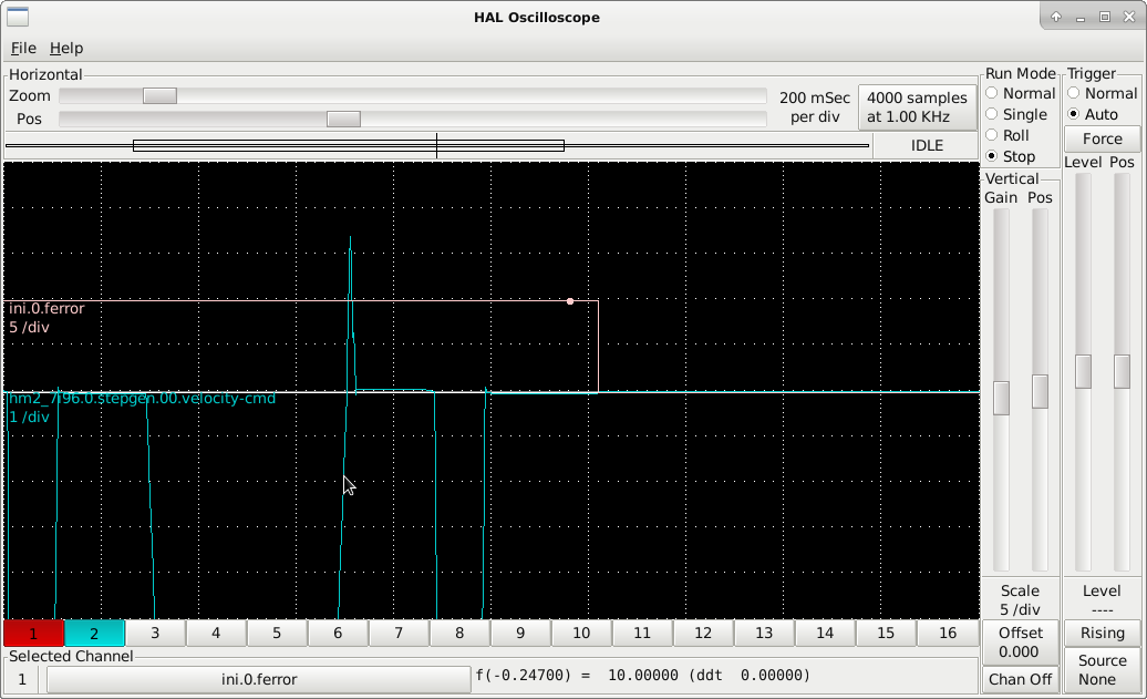

- ollied1981
- Posts: 17
28 Dec 2021 17:39 #230154
by ollied1981
Replied by ollied1981 on topic Gmoccapy & 7I96 jerky movement
I tried adding the lines to the hal file, but the problem is the same.
CPU usage from the Gmoccapy process is around 25% when it's happening. The machine is a core I3 with 4Gb of ram.
Attached is a screenshot of halscope when the error is happening. The ferror always seems to be at "10"...not sure of the units. Irrespective of the commands...
- Posts: 18105
- Thank you received: 5328
28 Dec 2021 18:03 #230156
Replied by PCW on topic Gmoccapy & 7I96 jerky movement
You are plotting the f-error limit setting, not the actual f-error,
which would be:
joint.0.f-error
(for joint 0, usually mapped to the X axis)
which would be:
joint.0.f-error

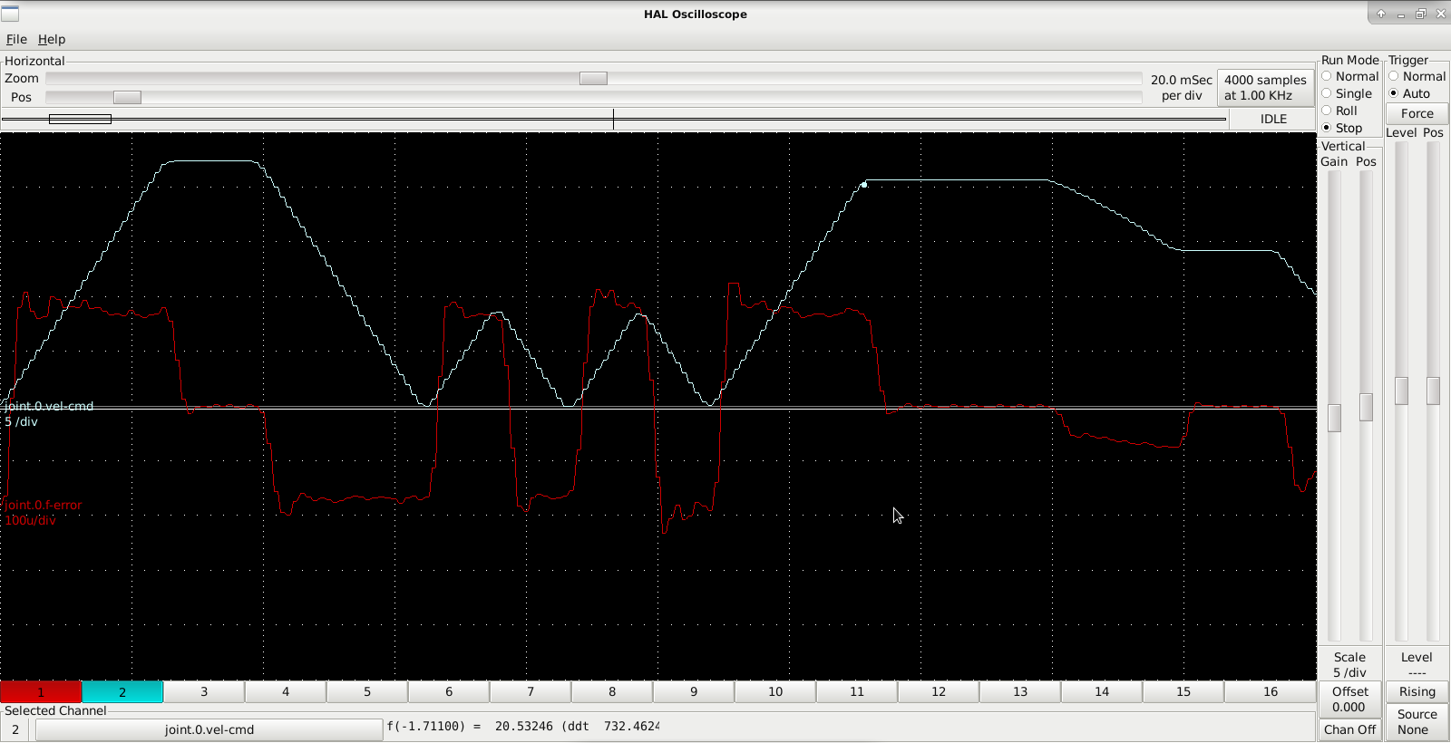

- ollied1981
- Posts: 17
28 Dec 2021 18:50 #230160
by ollied1981
OK I managed to capture it in the attached.
The error isn't there when linuxcnc is first started, but after a number of runs through the same gcode it starts, and then continues until linuxcnc is restarted. I can pause the running programme and restart it, and the jerky movement continues.
It's pretty obvious once it's started because it makes the whole machine vibrates, but increasing the feedrate makes it even more apparent...

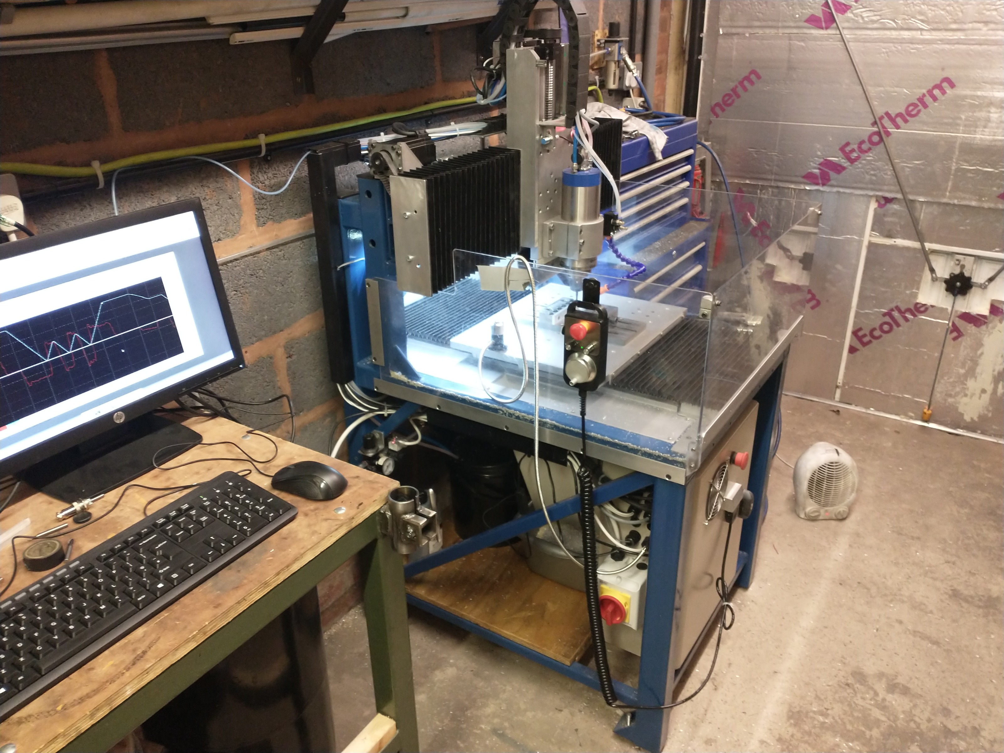

28 Dec 2021 19:01 #230161
by ollied1981
Pic of the machine in question attached just for interest.
- Posts: 18105
28 Dec 2021 19:13 #230163
OK so those errors (+ and - 0.002 mm) are negligible so the
stepgen is doing what's expected, that is, it's following LinuxCNCs
commanded position accurately.
Other possibilities are electrical (how is the 7I96 connected to the drives.
Some drives don't like differential connections as there is less drive current
Also might be a mechanical intermittent.
