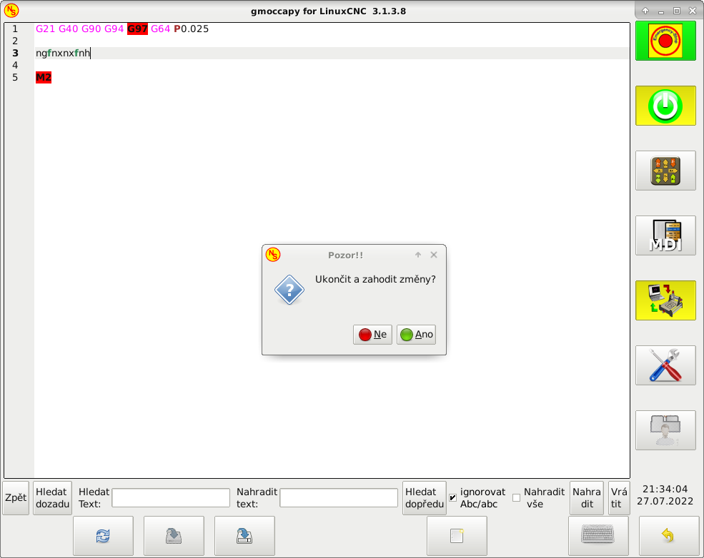

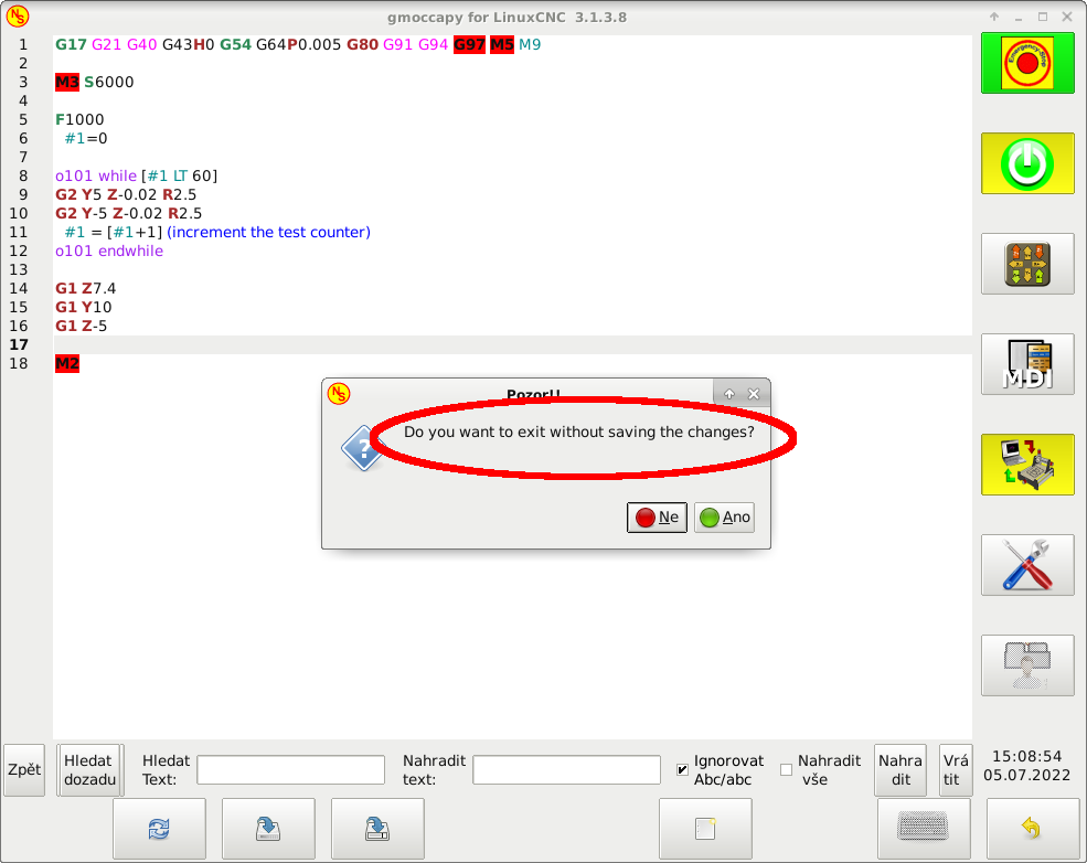

4 years 3 months ago #246645 by zz912
I didn't find a way to translate.

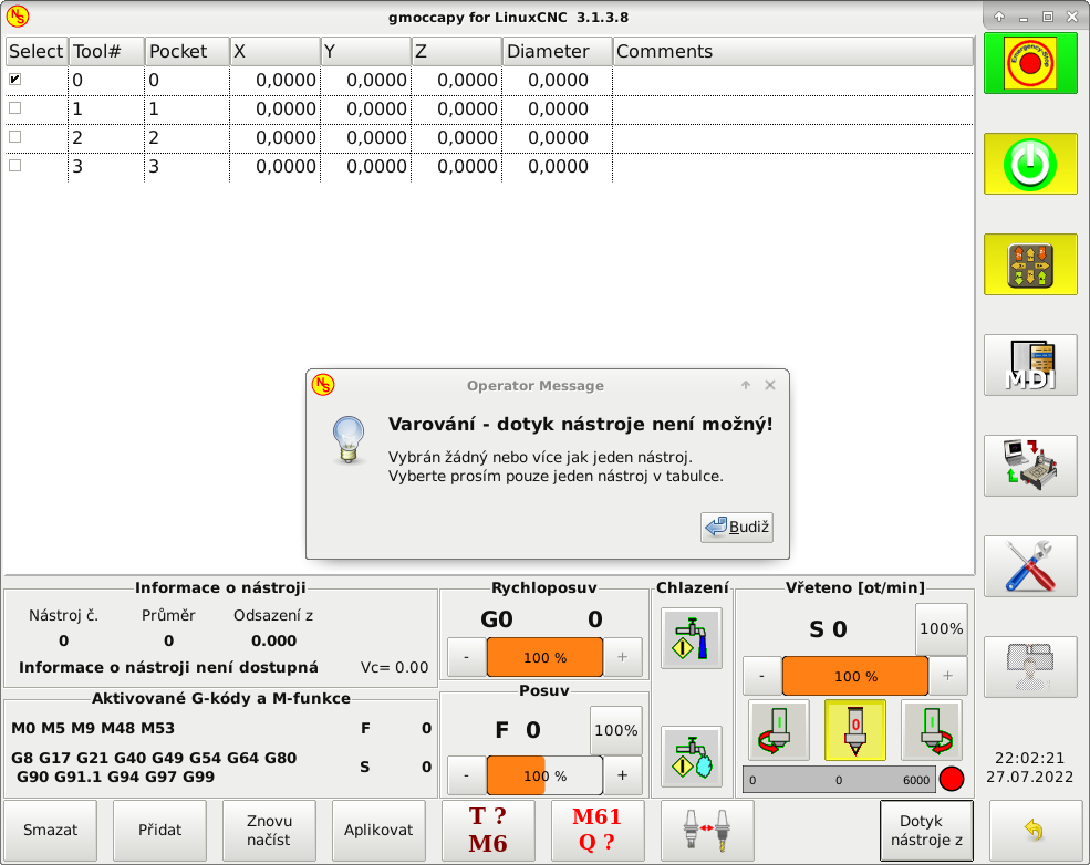

4 years 3 months ago #247215 by zz912
Replied by zz912 on topic LCNC 2.8 - Language bugs
I managed to fix some errors with the help of the members here.
I learned how to make a pull request on Github thanks to it.
Would anyone be willing to take a look at the remaining bugs?
forum.linuxcnc.org/gmoccapy/46206-transl...ton-dont-work#246506
forum.linuxcnc.org/gmoccapy/46206-transl...ton-dont-work#246507
forum.linuxcnc.org/gmoccapy/46206-transl...work?start=10#246645
4 years 3 months ago - 4 years 3 months ago #248426 by HansU
Replied by HansU on topic LCNC 2.8 - Language bugs
This should work when editing the string in src/po/gmoccapy/cs.po
#: dialogs.py:111 dialogs.py:126 dialogs.py:140
msgid "Operator Message"
These are just strings you can ignore while translating. It doesn't matter what is inside this string, as it is only a placeholder that's being overwritten.
I fixed this in 2.8 now. Look for the string "Exit and discard changes?"
