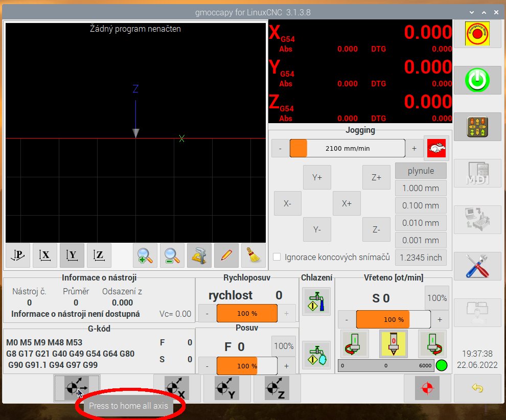

22 Jun 2022 18:14 #245609
by zz912

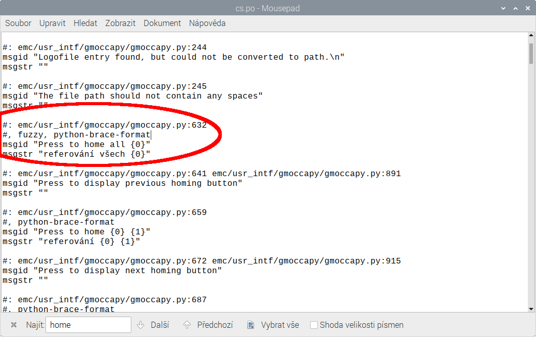

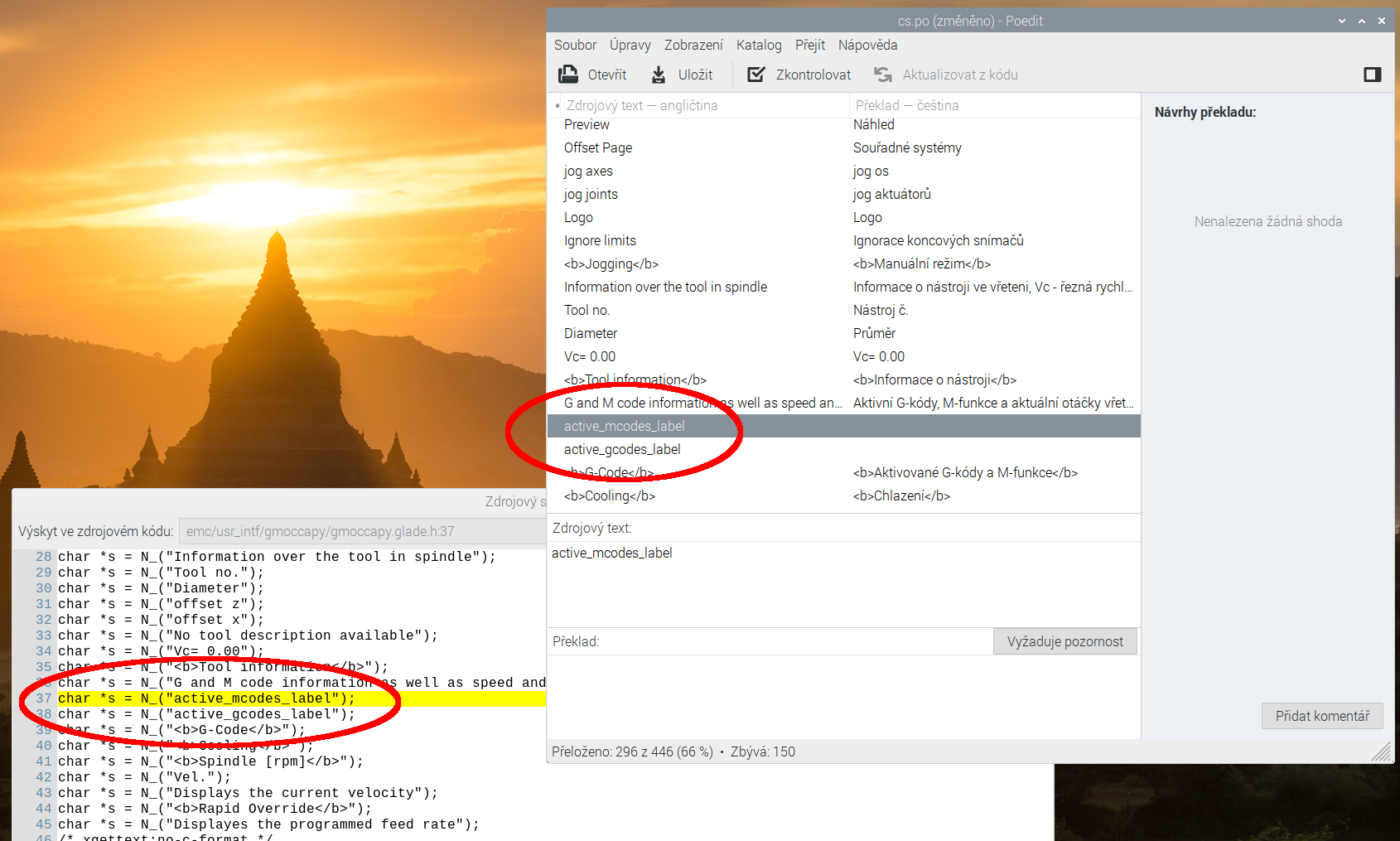

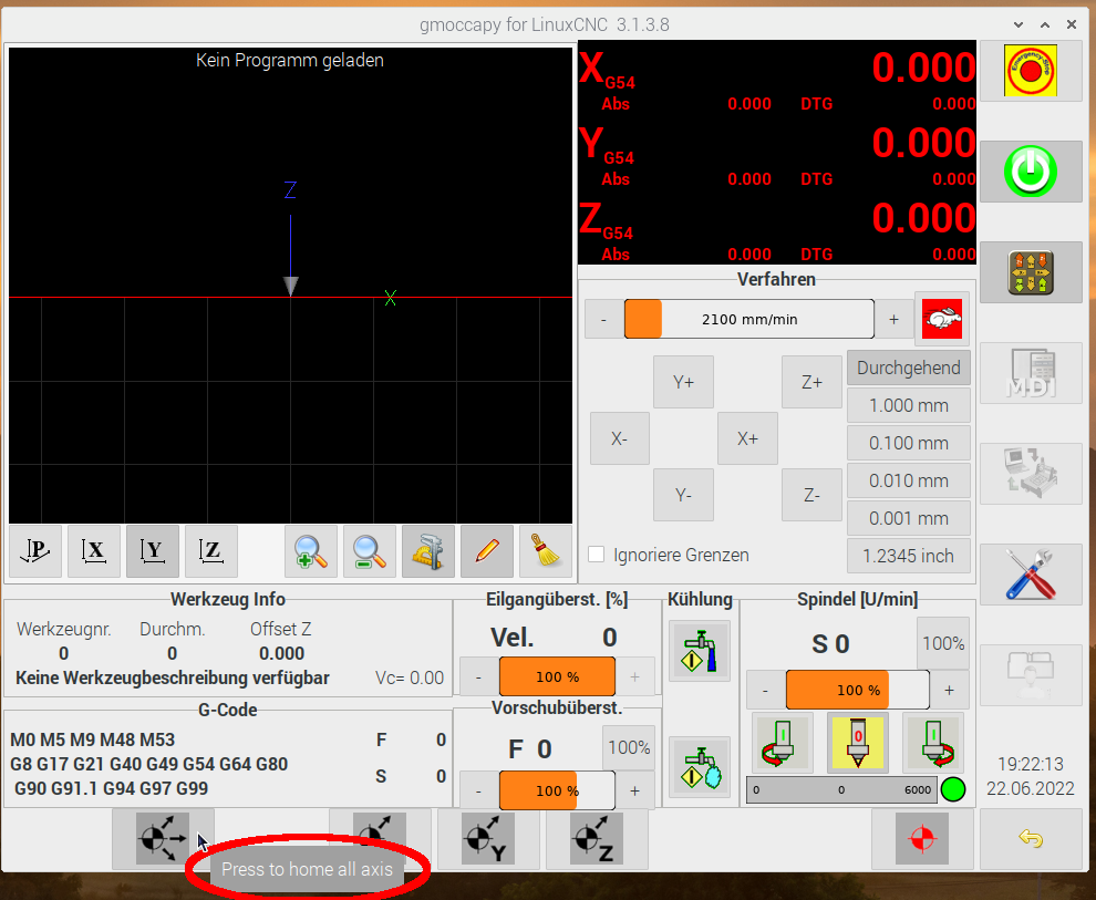

Translate Tooltip Home button dont work was created by zz912

Replied by HansU on topic Translate Tooltip Home button dont work
It seems that you are not yet using Weblate for your translation.
You just have to add your language here hosted.weblate.org/projects/linuxcnc/gmocappy/.
Then I would strongly recommend you to do your translations there if you want to have them in master.
If you have already worked a lot on your translation based on the po file - I think there is a way to get your translations into Weblate.
Regarding the primary problem - I'll have a look...

24 Jun 2022 14:51 #245791
by HansU
I fixed the strings in 2.8 as well as in master.

If I created Czech for LCNC, will it be possible to easily switch LCNC to English in version 2.9? I am currently compiling the whole LCNC using "make" and I have a RIP installation, most LCNC users use live distribution and here I do not know how to change the language and whether it is possible at all. Czech is interesting only for some individuals, others would like to kill me if suddenly a change came and they had everything in Czech instead of English.
I also have a problem that I am not a machinist and I do not know suitable translations for some expressions. In addition, I find that Gmoccapy has features that I don't know what they are for, let alone how I translate their controls.

I am a very conservative person, so I will use version 2.8 for as long as possible.It seems that you are not yet using Weblate for your translation.
I tried to start a translation thread on the Czech forum
forum.strojirenstvi.cz/viewtopic.php?t=41960
but no one interested this topic. Maybe someone will be in the future.

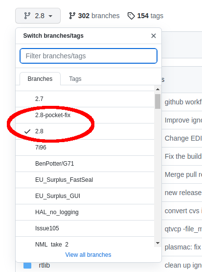

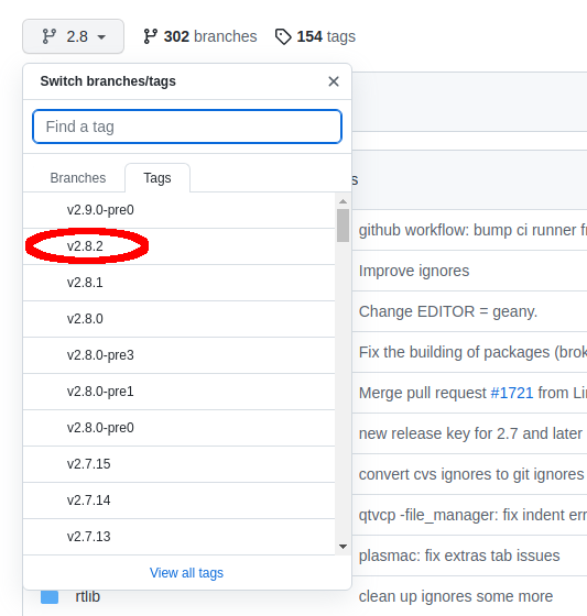

29 Jun 2022 09:19 #246142
by zz912
I use RIP Installation. I download source from github:
I don't know the difference between "Branches" and "Tags"
Is "2.8" future version 2.8.3 in this moment?
Is in "2.8" this fix?
Replied by zz912 on topic Translate Tooltip Home button dont work
Is there a way to get this fix?I fixed the strings in 2.8 as well as in master.

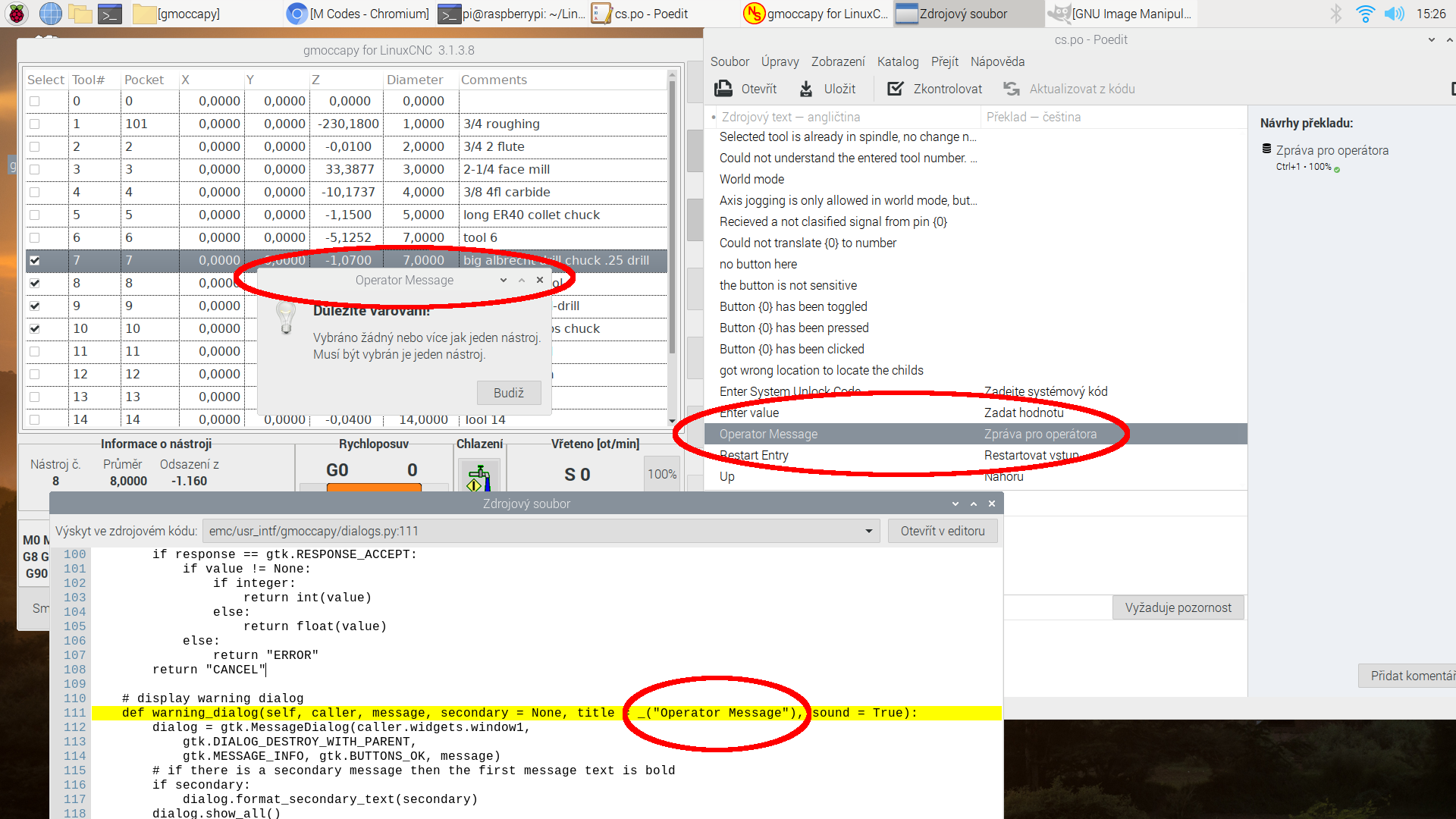

29 Jun 2022 19:15 #246190
by zz912

I found next bug:
github.com/LinuxCNC/linuxcnc/commit/cc1b...ff0bde4ffd9568313549
Gmoccapy.py
line 1160
old: btn.set_property("tooltip-text", _("Press to jog axis {0}".format(axis)))
new: btn.set_property("tooltip-text", _("Press to jog axis {0}").format(axis))
line 1179
btn.set_property("tooltip-text", _("Press to jog joint {0}".format(joint)))
same problem
line 1229
btn.set_property("tooltip-text", _("Press to run macro {0}".format(name)))
same problem
I fixed it like you. Can I ask you for fix it in Github?
Edit: I made Pull request

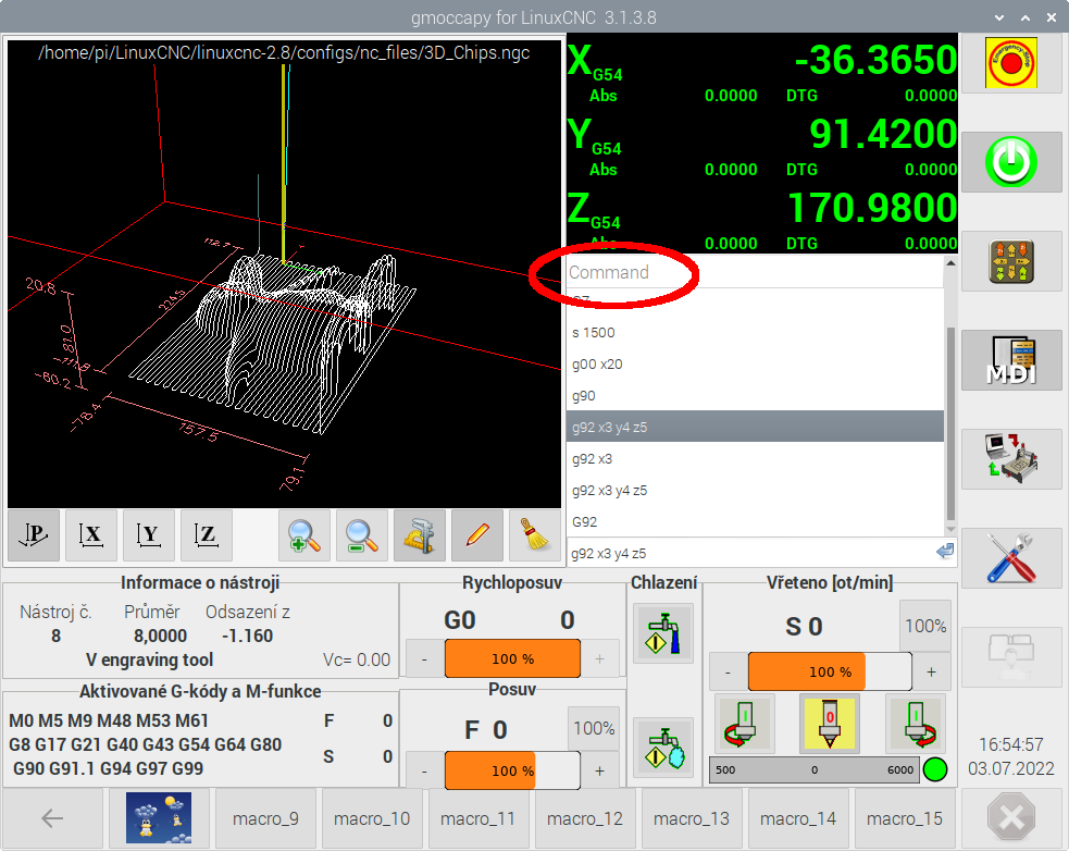

03 Jul 2022 13:46 - 03 Jul 2022 14:16 #246506
by zz912
Last edit: 03 Jul 2022 14:16 by zz912.
- zz912
- Posts: 596
- Thank you received: 98
03 Jul 2022 14:20 #246507
by zz912
- zz912
- Posts: 596
03 Jul 2022 15:07 #246511
by zz912
