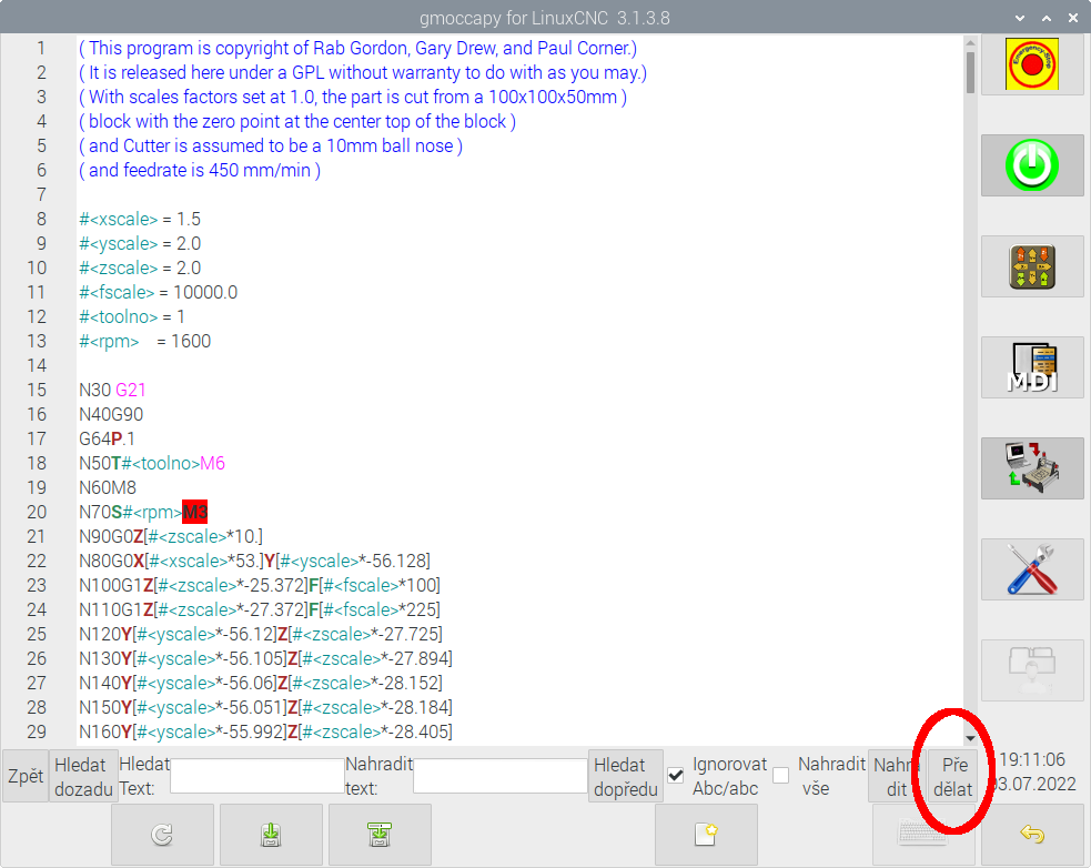

In the text editor is button Redo. What the function make?
It is pity, the button has no tooltip.

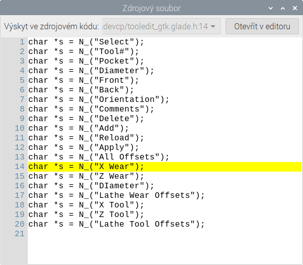

What is "Wear" mean?

Wear = how much worn off or used = jak moc je nehco pouzito ???
On the left is "undo", which reverses the previous edit action.
"Redo" reverses the "undo".
Also, in the other posts.
"World" mode moves the tool tip in XYZ space. "Joint" mode moves the joints of the machine one at a time. For some machines this looks like exactly the same thing, but with a robot arm (for example) there is a significant difference.
(But, the meanings are not exactly obvious in english either)
Thank you for explain.
I finished for myself for these buttons Tooltips.
