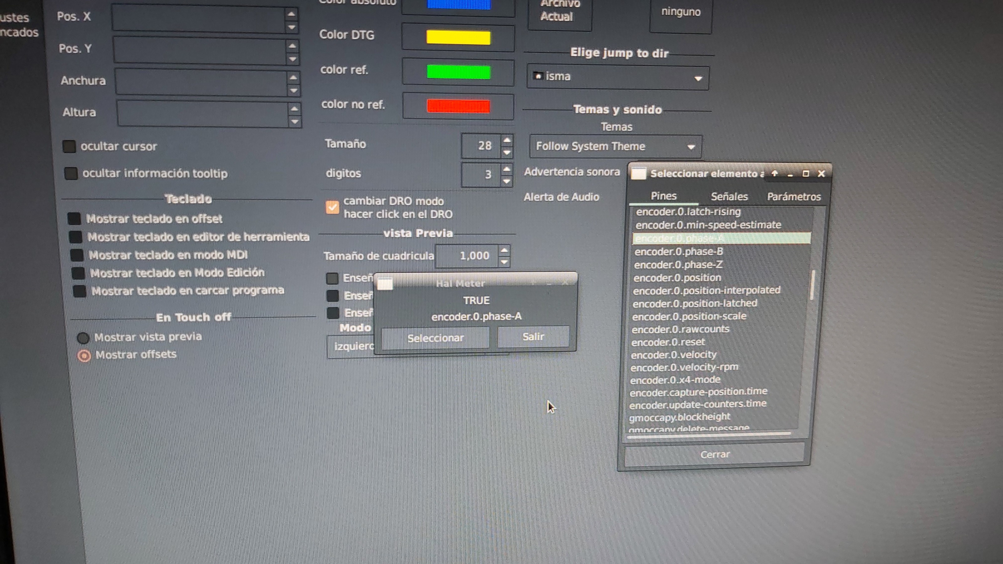

Hello, I am trying to configure an encoder and an index sensor to be able to make a thread on my lathe converted to cnc.
I am very new to linuxcnc, I am having a hard time understanding the linuxcnc environment and I would need a little help to configure it.
I am using a 600prr 2 phase (A - B ) encoder and an inductive proximity sensor as the index sensor.
I have the encoder connected to pin 12 as phase A and the proximity sensor to pin 13 as spindle index.
in gmoccapy it doesn't show anything in rpm. in hal meter it shows as true and false when moved.
forgive my bad english
Thanks. All the best.

Can you verify that the "A" pin (encoder.0.phase-A)
toggles when you rotate the spindle slowly?

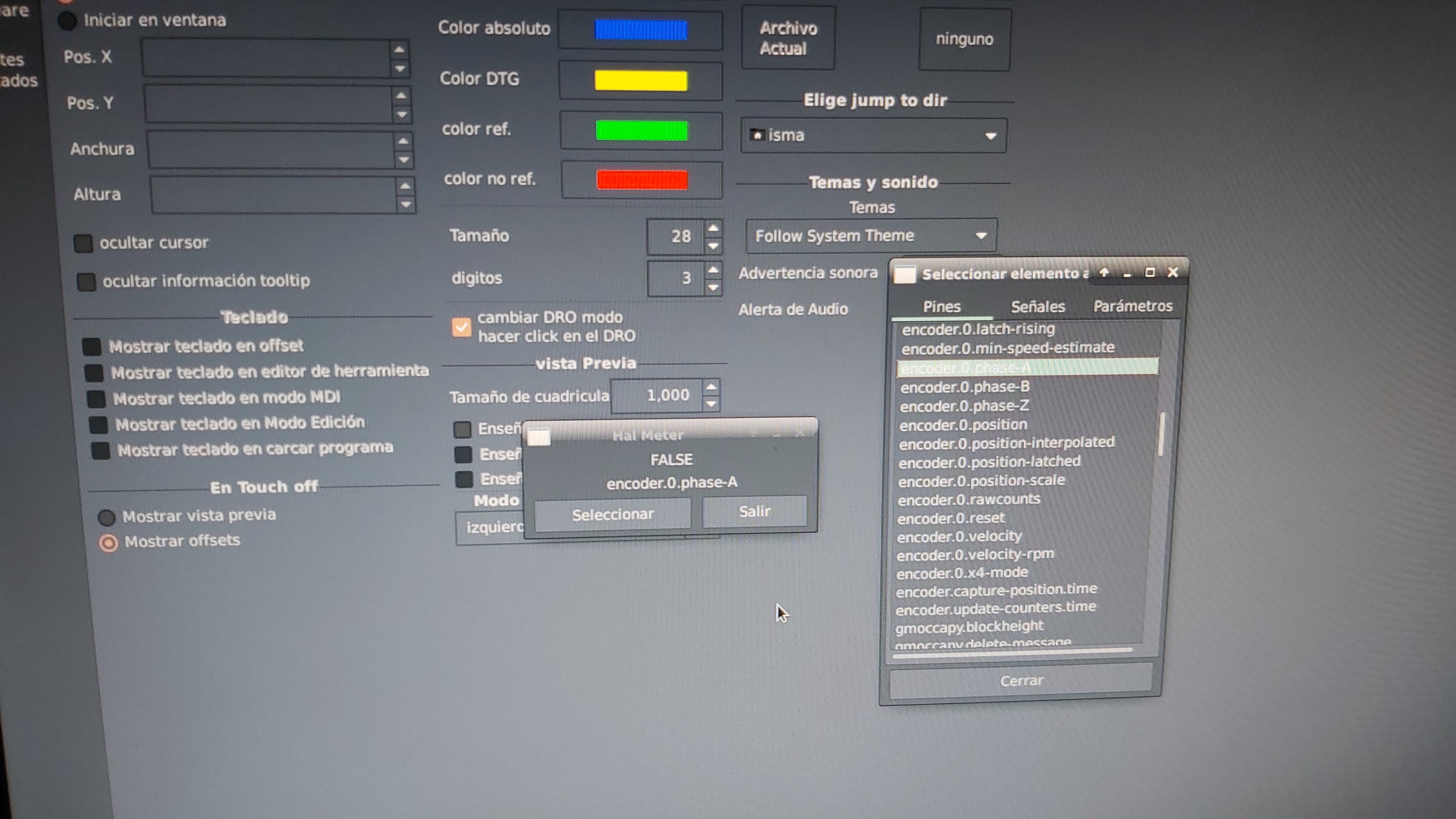

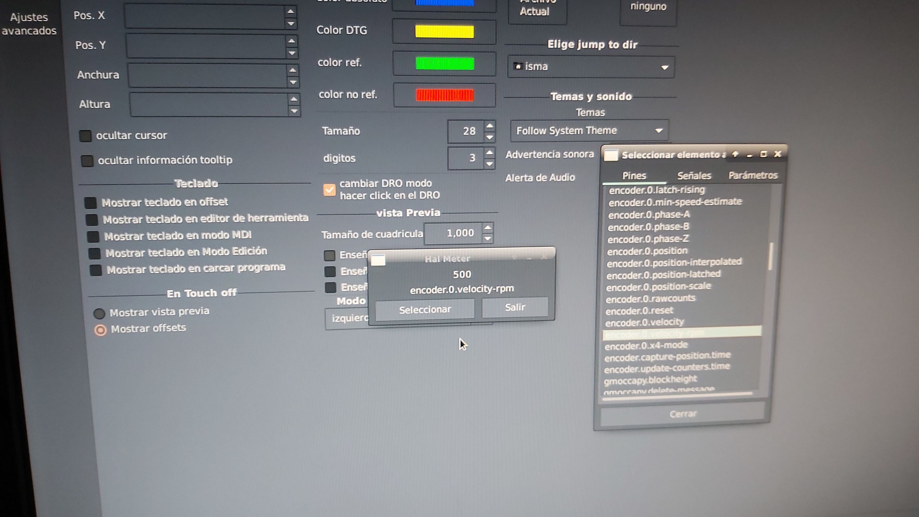

13 Nov 2022 00:43 #256552
by Ismacr63
As you can see in the screenshots, the value changes when I move the spindle slowly. the other catch the spindle was turning.
Replied by Ismacr63 on topic encoder configuration help for threading

OH, OK, I misunderstood, the encoder is working but just not displayed in gmoccapy
looking at:
linuxcnc.org/docs/html/gui/gmoccapy.html#_spindle_feedback_pins
it seems you must connect the pin gmoccapy.spindle_feedback_bar to the spindle RPM signal
in a hal file
looking at:
in a hal file

Yes, these need to be connected in your postgui.hal file with net statements
probably something like
net spindle-at-speed => gmoccapy.spindle_at_speed_led
the gmoccapy.spindle_feedback_bar connection in the postgui.hal file needs
a new signal in the normal hal file:
net spindle-velocity-feedback-rpm encoder.0.velocity-rpm
and then
net spindle-velocity-feedback-rpm => gmoccapy.spindle_feedback_bar
The index connection resets the spindle position to 0 when
