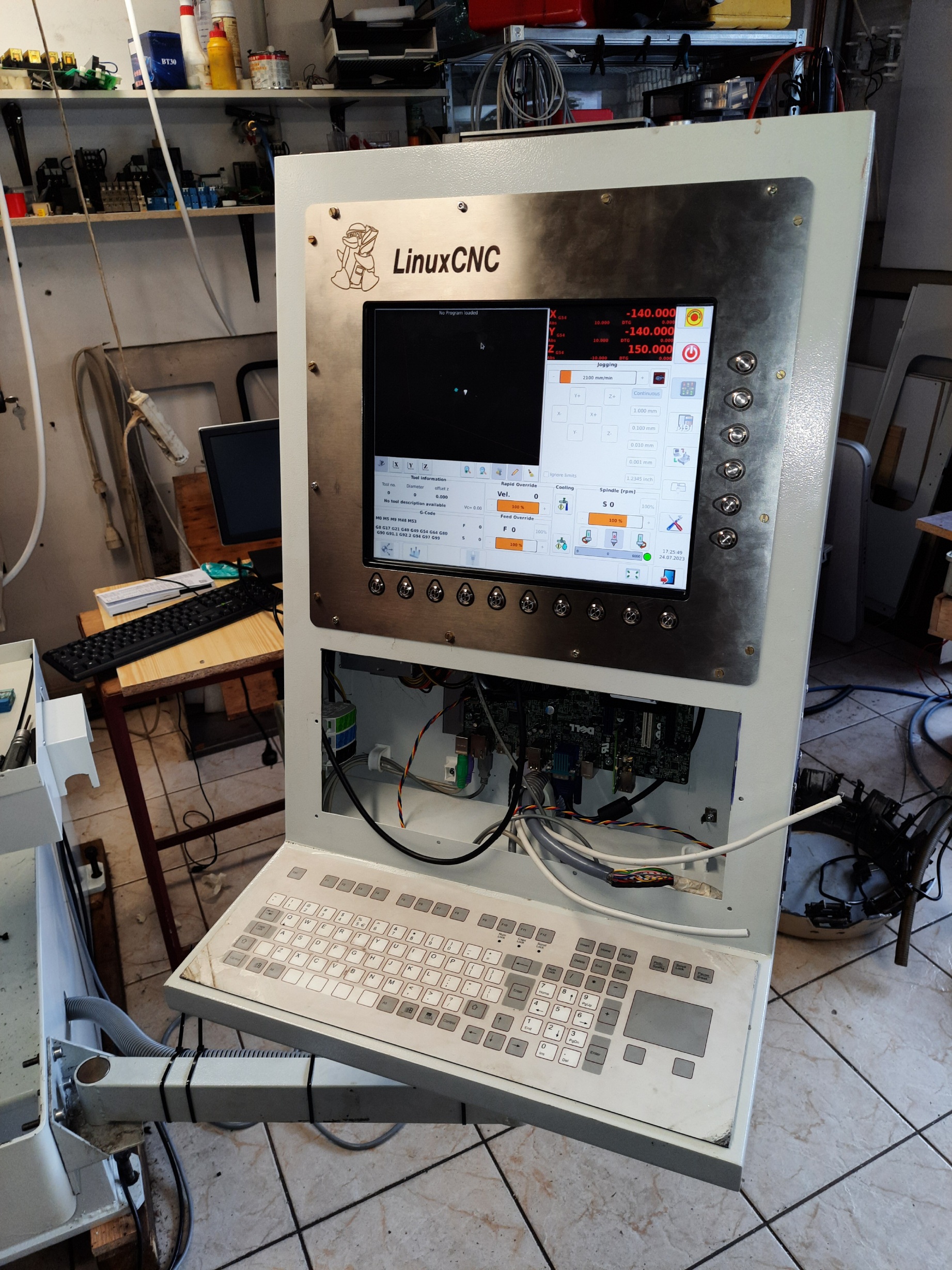

I don't know how to accomplish what you want, but I think that box (#2) is shared with the g-code and MDI displays while in Auto/MDI modes.
If you squeeze down box #2 to get rid of the HMI jog controls you'll not have much real estate to see more than a couple lines of gcode. You OK with it like that?

Not sure if you are aware, but you can change the DRO character/font size in the gmoccapy settings page. Try increasing to 50 or so and see if that helps out.
I've also found that some of the windows/boxes are size-adjustable simply by hovering and dragging the edge of the windows.

If I increase the DRO, the horizontal buttons disappear.

I think this does what you want. It hides the jog buttons but keeps the slider for the jog rate. The documentation is a bit unprecise at this point, I must admit.
EMBED_TAB_NAME = some_name
EMBED_TAB_LOCATION = hbox_jog
EMBED_TAB_COMMAND = hide

You mean the bottom row buttons? Not good.
I hope someone else more familiar with gmoccapy can chime in 'cause I'm out of ideas on how to modify the screen to get you a bigger DRO.
Maybe there's a way to get rid of the spindle on/off buttons in box #6 to make it smaller. Sounds like you want physical buttons for jogging - maybe for spindle control too? If those huge spindle buttons were gone, that'd get you a fair bit of room to shift everything around and get a larger DRO.
