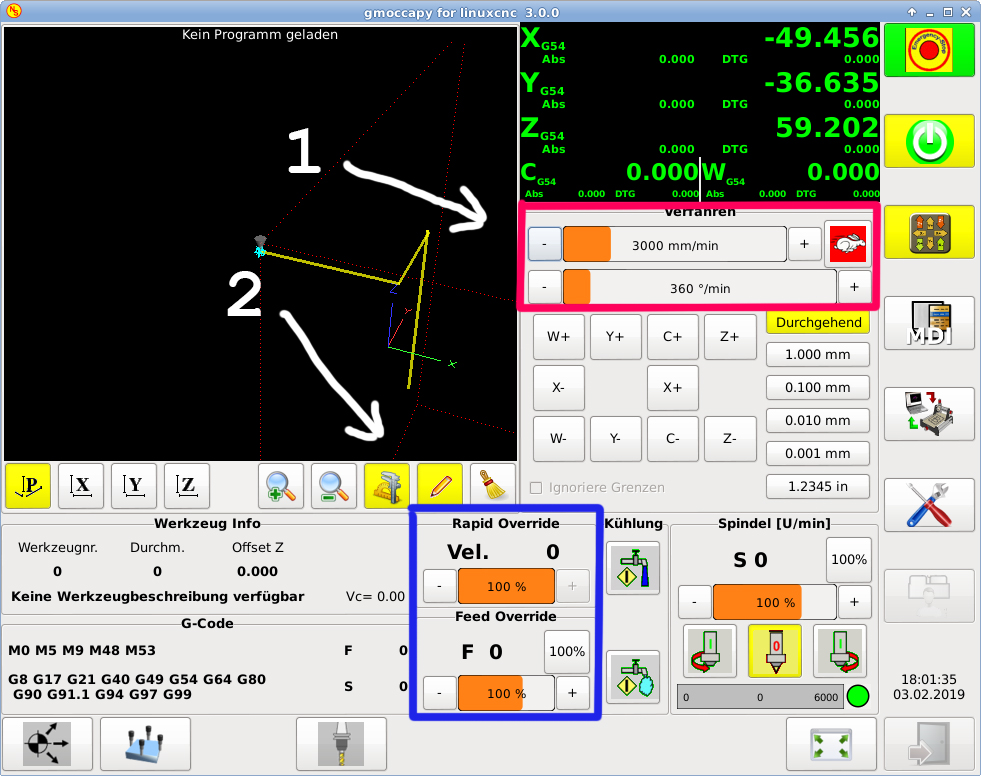

Hello. Please help me with speed settings. I am using a 23 position toggle switch and muxgen to work out its positions. Feed override is changed with this switch. I need to make Feed override and Rapid override change at the same time. The first position of the switch is 1% in Feed override and it is necessary that there should also be 1% in Rapid override.
But that's not all. As I understood in linuxcnc there are 3 independent speeds. G1 - Feed override, G0 - Rapid override and manual movement - jogging.
Is it possible to adjust so that the jogging speed also changes proportionally to the position of the switch? For example, the jogging speed is 2000 mm/min (2 on image) and the switch is in the 10% position (1 on image). 2000/10 = 200 mm/min jogging speed.
You ask, what is all this for? Answer: To minimize the number of touches to the touch panel with dirty hands.
I also want to connect an additional 3 physical buttons to control the selected axis on the MPG. 1. Movement in a positive direction. 2. Movement in the negative direction. 3. Accelerated movement when the button is held down (Rabbit and turtle) Is it possible to implement all this in linuxcnc and gmoccapy gui?
Thx for answer.
Thx for answer.

gmoccapy makes the feed override quite easy as it comes with the necessary input pins. I use a potentiometer to set the override so you will have to provide the required analog values using your 23 position switch.
# --- FEED/SPEED OVERRIDES BY PANEL POTENTIOMETERS ---
# --- POTENTIOMETER FEED OVERRIDE ---
setp gmoccapy.jog.jog-velocity.analog-enable 1
setp gmoccapy.feed.feed-override.analog-enable 1
setp gmoccapy.rapid.rapid-override.analog-enable 1
net poti-feed-scaled => gmoccapy.jog.jog-velocity.direct-value
net poti-feed-scaled => gmoccapy.feed.feed-override.direct-value
net poti-feed-scaled => gmoccapy.rapid.rapid-override.direct-value
As for the jogging buttons, this example will let you also jog before homing the machine. If you don't want that remove the pins starting with 'halui.joint.'
net x-plus <= your_input_pin => halui.axis.x.plus => halui.joint.0.plus
net x-minus <= your_input_pin => halui.axis.x.minus => halui.joint.0.minus
net y-plus <= your_input_pin => halui.axis.y.plus => halui.joint.1.plus
net y-minus <= your_input_pin => halui.axis.y.minus => halui.joint.1.minus
net z-plus <= your_input_pin => halui.axis.z.plus => halui.joint.2.plus
net z-minus <= your_input_pin => halui.axis.z.minus => halui.joint.2.minus

there are a number of halui jogging pins that let you do what you want. the 2 speeds can be done with a mux2 to select jog speed and rapid speed.

use two mux components that use the same switch inputs.
One mux can be used as input for feed overrde.
The other mux can be used as input for rapid override.

Solved the problem with rapid override and feed override synchronization. Added a thread between them. Highlighted in bold.
Now I need to do at least some synchronization with jog speed?
How to make it so that when starting the program, the jog speed is already 3000 mm/min?
Is it possible to link jog speed with this net? --> net feedoverride-incr => halui.feed-override.counts halui.rapid-override.counts
Thx for answer

This is code from jog.hal. All axes work fine, scale changes fine, MPG works fine. But I need to program 3 more physical buttons. For the selected axis to move with jog speed in the positive direction, another in the negative direction.The third button, when pressed, changed from "turtle" to "rabbit". And when it was released, the slow speed returned again. I tried to solve it myself, these are the 3 last lines in the code.
Please help to solve this problem

Will this work?
Replied by Taichi on topic Feed override, Rapid override and Jogging synchronization
net axis-for-plus => halui.jog.selected.plus hm2_5i25.0.7i76.0.3.input-10
net rapid-on => gmoccapy.jog.turtle-jog hm2_5i25.0.7i76.0.3.input-09-not
net axis-for-minus => halui.jog.selected.minus hm2_5i25.0.7i76.0.3.input-08Please Log in or Create an account to join the conversation.

Note that everything that involves pins for gmoccapy gui like:
Will need to be done in a 'postgui' - halfile because the regular hal files load before the gui has been created so none of the gui pins will be found at that stage.

It turned out to be configured as I wanted. It turns out that in lcnc there are no pins with the name "halui.jog.selected.minus" in halshow, but only "halui.axis.selected.minus".
But in order for it to work, you need to set the speed "halui.axis.jog-speed". So I used mult2 to multiply the value from "gmoccapy.spc_jog_lin_vel.value" and the value I got earlier in jog.hal --"halui.feed-override.counts". Thus, at the output, I got the speed that I set on the slider multiplied by the % indicated on the switch. I used a tip from Aciera for a quick move. gmoccapy.jog.turtle-jog in the postgui file.
I also got the problem. When I select the axis "halui.axis.N.select" on the remote control, the value "halui.axis.selected" changes also as required. But when the axis selection switch is turned off, the "halui.axis.selected" setting is always the last, that is, in my case, it is the value "0". This means that the axis numbered 0, that is, the X axis can still be controlled by the physical buttons "halui.axis.selected.minus" and "halui.axis.selected.plus". How can I reset the value of "halui.axis.selected" to "NULL" or something so that the control is disabled?
Thx for help.
