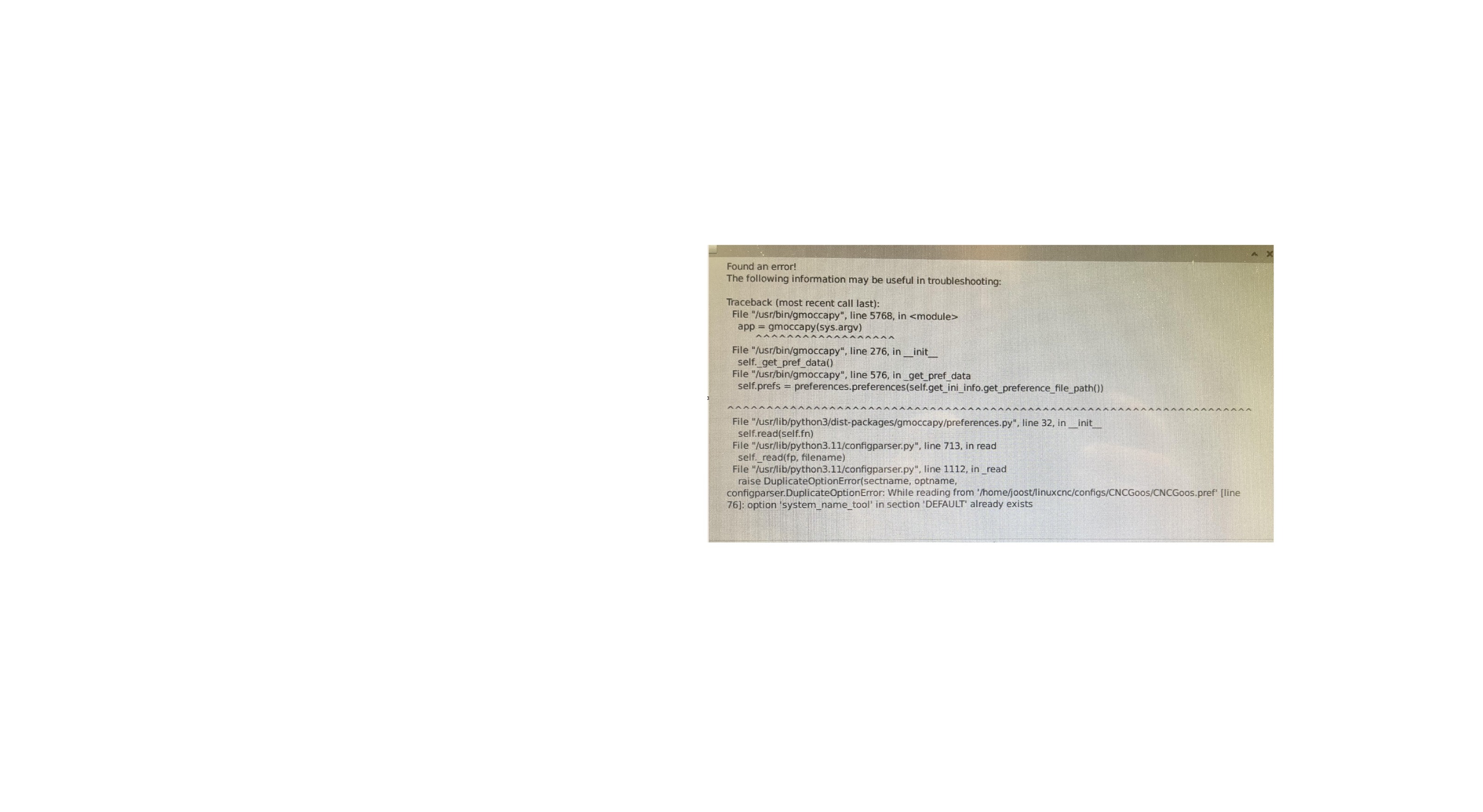

Hello All,
I am just using LCNC 2.9 with GMOCCAPY.
Often i get a error during Start of the program.
The problem is then that de folowing parematers are Duplicate in the Pref file
system_name_Tool = Tool
system_name_G5x = G5x
system_name_Rot = Rot
system_name_G92 = G92
system_name_G54 = G54
system_name_G55 = G55 0 pos vacuumtafel systainer
system_name_G56 = G56
system_name_G57 = G57
system_name_G58 = G58
system_name_G59 = G59 tbv Tool change
system_name_G59.1 = G59.1
system_name_G59.2 = G59.2
system_name_G59.3 = G59.3
Now i am using LCNC 2.9 that is e problem. before in LCNC 2.8.4 thet was not e problem
What can i do to get rid of that problem. now i am deling the second blok of the same parameters.

3 years 2 weeks ago - 3 years 2 weeks ago #283128 by newbynobi
Replied by newbynobi on topic Duplicate settings in Pref File
So an error causes that duplicate settings, what kind of error?
Norbert
Last edit: 3 years 2 weeks ago by newbynobi.

3 years 2 weeks ago #283136 by CNCGOOS
Replied by CNCGOOS on topic Duplicate settings in Pref File
the Added picture is te error during the boot of LCNC
3 years 2 weeks ago #283240 by newbynobi
Thats the error after you got the double entries, I understood that after an error the double entries are created.
This way it will be difficult to find :-(

2 years 11 months ago #284925 by HansU
Replied by HansU on topic Duplicate settings in Pref File
Can you try to figure out in which case  duplicate entries are added to the pref file? Does it happen when you make changes to the setttings or just running a job? Or does is seem to happen more like random?
I tried to reproduce this, but didn't get those duplicate entries.
2 years 7 months ago #297514 by pistrix
Replied by pistrix on topic Duplicate settings in Pref File
I have exactly the same problem but I don't know what causes it. It seems random. So you say that the error causes double entries and not vice versa? I thought it is the opposite: because of the double entries, linuxcnc returns the error. I am confused.
2 years 4 months ago #303324 by neerajbagi
Replied by neerajbagi on topic Duplicate settings in Pref File
I am also facing the same issue. It seems to me that the duplication of entries in .pref file is happening after the completion of a job, and shutting down the software/ system. It is also very random. Sometimes it happens, sometimes it doesn't.
I clearly remember that this error started occurring only after I changed the theme in the settings tab.
