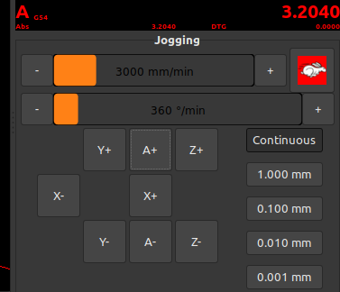

I cannot seem to find the jog keys for the A axis. Where they included recently?
Regards
Marius
www.bluearccnc.com

Sorry I wasn't clear about what I asked. I meant the keyboard hot keys to jog the extended axis like A.
Regards
Marius
www.bluearccnc.com

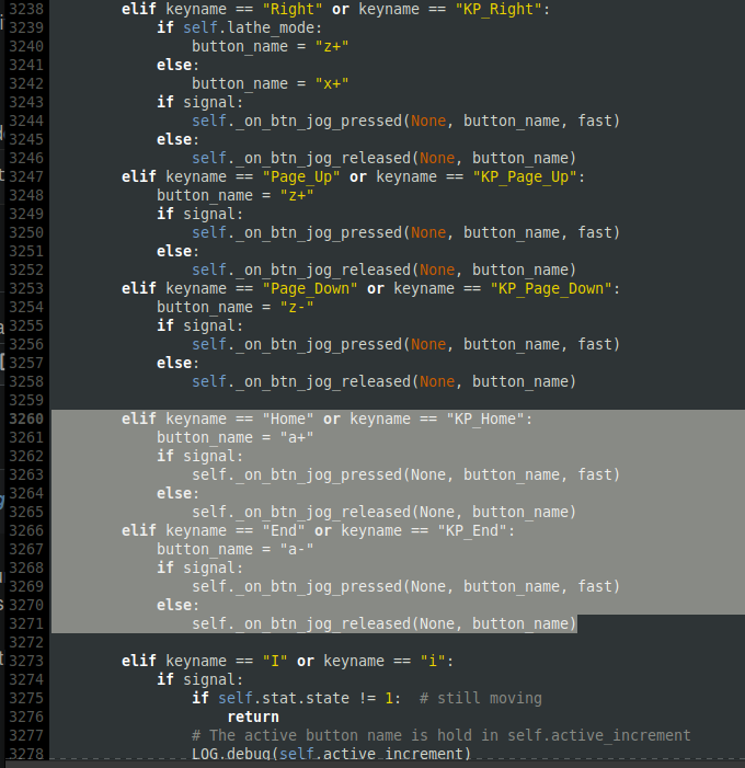

You would likely need to add these to the 'on_key_event' function in 'bin/gmoccapy':
Like this:
elif keyname == "Home" or keyname == "KP_Home":
button_name = "a+"
if signal:
self._on_btn_jog_pressed(None, button_name, fast)
else:
self._on_btn_jog_released(None, button_name)
elif keyname == "End" or keyname == "KP_End":
button_name = "a-"
if signal:
else:
self._on_btn_jog_released(None, button_name)Like this:

Thanks for that info. I have been doing that for years now. It makes it impossible to upgrade or update a machine if you modified the source. I suppose I will just have to do it again.
