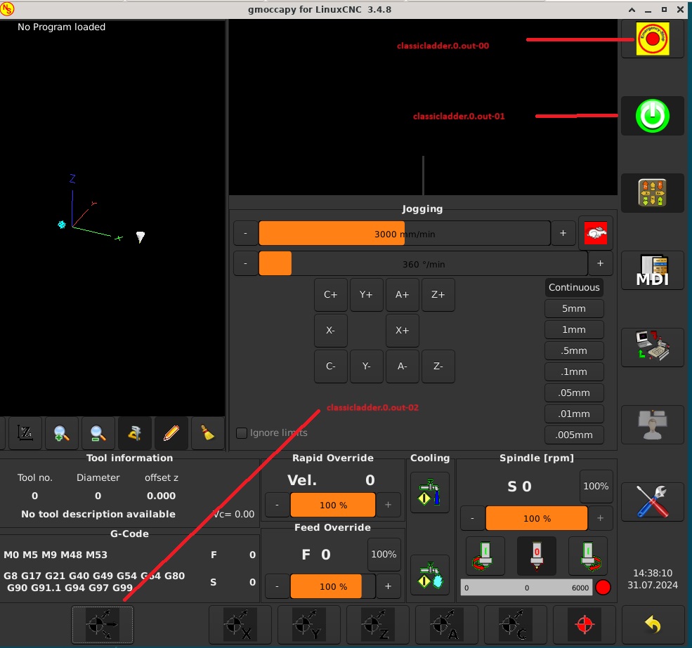

gmoccapy pins
- Moutomation
- Posts: 154
- Thank you received: 11
31 Jul 2024 11:48 #306505
by Moutomation
gmoccapy pins was created by Moutomation
- Posts: 4818
- Thank you received: 2176
31 Jul 2024 11:55 #306508
Replied by Aciera on topic gmoccapy pins
for estop-activate use 'halui.estop.activate'
for estop-reset use 'halui.estop.reset'
for machine-on use 'halui.machine.on'
for machine-off use 'halui.machine.off
for home-button use 'halui.home-all '
for program-start use 'halui.program.run'
Gcode refresh I'm not sure.
linuxcnc.org/docs/html/man/man1/halui.1.html

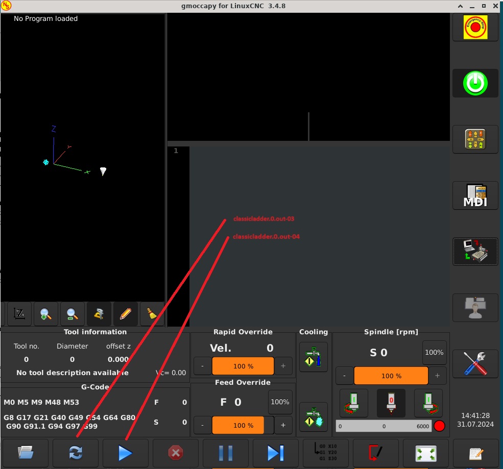

- Moutomation
- Posts: 154
31 Jul 2024 12:14 #306511
by Moutomation
Replied by Moutomation on topic gmoccapy pins
Thanks a lot
Can program refresh be controlled from the classic ladder?

- Moutomation
- Posts: 154
04 Aug 2024 14:38 #306921
by Moutomation
Instead of binding this key to a button, is there a way to refresh the g-code file every few seconds while the g-code is not executing? I want to automatically load the g-code file into linuxcnc continuously. The name of the g-code file is always the same and never changes.
- Posts: 4818
06 Aug 2024 09:32 - 07 Aug 2024 06:33 #307066
Try this:
Save the python code below as 'file-check.py' into a folder named 'python' in your machine config folder and mark as executable.
This user component will create a hal pin 'file-checked.file-changed' and output a pulse if the file is modified:#!/usr/bin/env python3
To load this on startup add this to the [HAL] section of your .ini file:
then add this line to your POSTGUI_HALFILE:
import os
import time
import hal
import linuxcnc
h = hal.component("file-check")
h.newpin("file-changed", hal.HAL_BIT, hal.HAL_OUT)
h.ready()
# create a connection to the status channel
s = linuxcnc.stat()
# this is the file being checked for updates (example looks for 'file.txt' in the config folder)
file_path = 'file.txt'
# length of output puls in milliseconds
pulse_length = 1000
last_modified = os.path.getmtime(file_path)
h['file-changed'] = False
try:
while 1:
s.poll()
# we don't want to reload when program is running
if s.task_mode == 2 and s.state == 1: # ie AUTO-mode and 'RCS_DONE'
current_modified = os.path.getmtime(file_path)
if current_modified != last_modified:
print("File has changed!")
h['file-changed'] = True
timer_start = round(time.time()*1000)
last_modified = current_modified
if h['file-changed'] and timer_start + pulse_length <= round(time.time()*1000):
except KeyboardInterrupt:
raise SystemExitTo load this on startup add this to the [HAL] section of your .ini file:
HALCMD = loadusr -W ./python/file-check.pythen add this line to your POSTGUI_HALFILE:
net file-reload file-check.file-changed gmoccapy.h-button.button-1
Last edit: 07 Aug 2024 06:33 by Aciera. Reason: add lost hashbang in the code
The following user(s) said Thank You: Moutomation
- Moutomation
- Posts: 154
06 Aug 2024 18:10 #307113
by Moutomation
You are great, thank you very much. I will try to do it tomorrow.
- Moutomation
- Posts: 154
07 Aug 2024 06:26 #307144
by Moutomation
Hello,
I think I'm making a mistake somewhere
The file.txt file is in the config folder, but I think it cannot find this file.
./python/file-check.py: 1: import: not found
./python/file-check.py: 2: import: not found
./python/file-check.py: 3: import: not found
./python/file-check.py: 4: import: not found
./python/file-check.py: 6: Syntax error: "(" unexpected
<commandline>:0: waitpid failed ./python/file-check.py file-check
<commandline>:0: ./python/file-check.py exited without becoming ready
- Posts: 4818
07 Aug 2024 06:36 #307146
Seems likeI lost the hashbang in the first line of the python code in my last post.
I just fixed that, so copy/paste the fixtd python code above and try again.
- Posts: 4818
07 Aug 2024 06:51 #307148
Note, for the gcode to reload you need to switch to the 'AUTO' mode screen in gmoccapy.
Moderators: newbynobi, HansU
