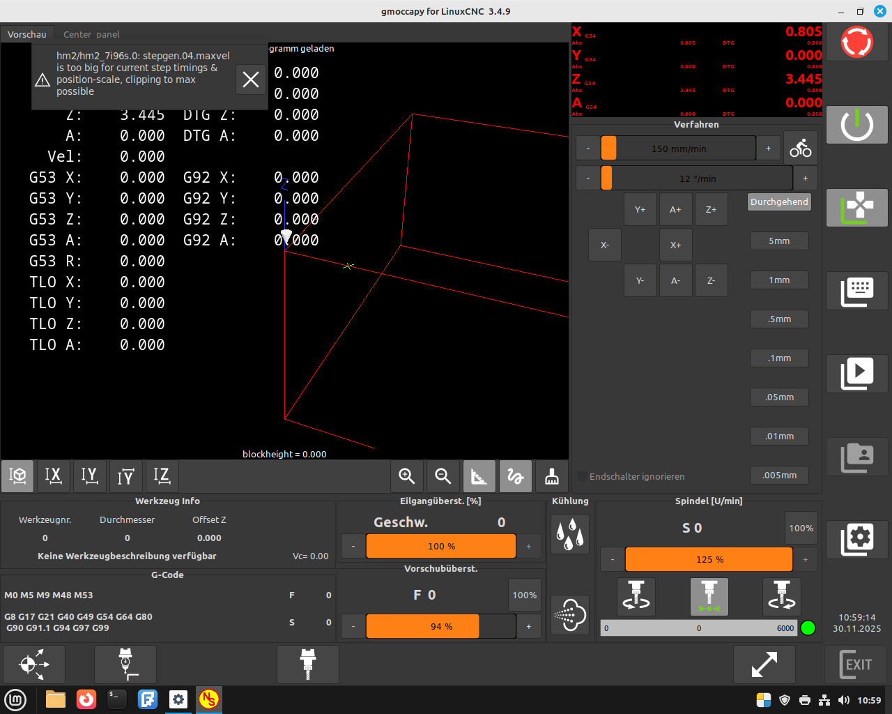

  I have a problem with the stepgen: the max velocity is too high. Where and which value do I need to adjust? My steps with the Mesa 7i96 are 10,000 steps for the spindle.
The second problem concerns the MVO rotary encoder. The spindle and the normal feed work, but the rapid-feed encoder does not. Even when I swap the inputs for feed and spindle, it still doesn’t work. It seems to be an issue with the GUI/interface? Where can I start looking to solve this?

The "Maxvel is to high" error means that the stepgen cannot physically generate
the  requested step rate with the current steplength and stepspace parameters.
Options are to:
Lower the steps per turn on the spindle drive
Lower the spindle maximum RPM
Lower the values of the step length and step space parameters
(as long as they still meet the drives minimum width specifications)
The maximum RPM will be 60/(steps per turn(step_length+step_space))
So for example at 10000 steps per turn and 5000 ns (.000005 seconds) for step length
and step space, the maximum RPM would be 600...

I was able to solve the error with maxvel too big by changing the steps per revolution to 2500 in the servo controller. Now I just have to solve the problem with the MVO.
