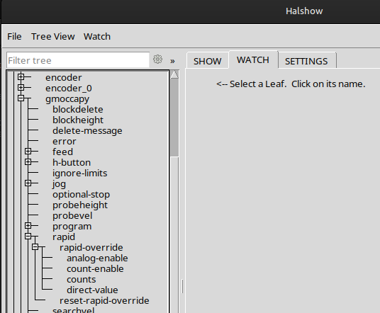

I've spent several hours trying to get rapid override working. I happened to read about the change in the designation from MVO to RO. The Mesa Config program doesn't recognize this yet.
Then I noticed that the manual has the wrong name.
Instead of rapid.rapid-override, it should be rapid-override.
I have now entered the following manually and it finally seems to be working.
# ---max Geschwindigkeit Neufestsetzungs-Signale an Mesa Encoder - mpg (rapid override signals to mesa encoder - mpg)---
net ro-count <= [HMOT](CARD0).7i73.0.0.enc3.count
# verbinde max Geschwindigkeit Neufestetzung Inkrement - MPG (connect rapid override increments - MPG)
setp halui.rapid-override.direct-value false
setp halui.rapid-override.scale 0.01
setp halui.rapid-override.count-enable true
net ro-count => halui.rapid-override.counts

18 Dec 2025 02:23 #340264
Replied by PCW on topic MVO to RO
What manual is this in and what LinuxCNC verison?
(the current halui man page does not have this error)

18 Dec 2025 06:49 #340267
by gravedigger
Replied by gravedigger on topic MVO to RO
To connect encoders, the following pins are exported:

18 Dec 2025 08:39 - 18 Dec 2025 09:01 #340272
Replied by Aciera on topic MVO to RO
Seems you are looking at 'gmoccapy' documentation for using 'halui' pins.
Halui documentation is here:
linuxcnc.org/docs/html/man/man1/halui.1.html#Rapid%20Override
However you should really be using the pins provided by gmoccapy for this purpose.
If unsure comment all lines in your hal files that give errors and use the 'Halshow' tool on the Settings page of Gmoccpy.
Using 2.9.7 I get this (which seems to agree with the documentation for Gmoccapy):
