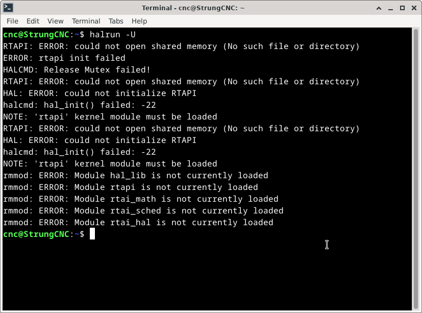

Hi i'm trying to open a sim config on 12 inch monitor with 1024x768 at 4:3 but gmoccapy gives and error with every sim config.
I tried even the 800x600 but the same error.
I tried axis and it works but the windows is bigger than the display.
The system is debian 12 si linux cnc 2.9.3 and rtai kernel 5.4.258
btw why the forum gives me and error when i try to put the code ?(You have too many links in your message, please decrease them! )
I uploaded the error code.

Mayby some GTK, GDK, Python3 package is missing.

Edit: i ran the command halrun -U
I think the rtapi module is not loaded
