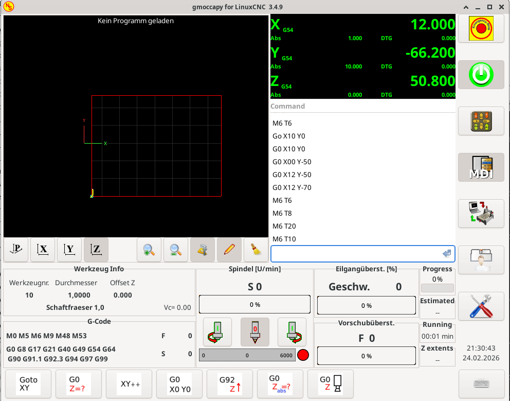

I don't know what's wrong with your enter button, but normally it should work with the enter button:
And so IMHO it does not really make sense to have a hardware button to send MDI commands which you need to type with the keyboard.
How is the behaviour on your machine different from that I have shown?
