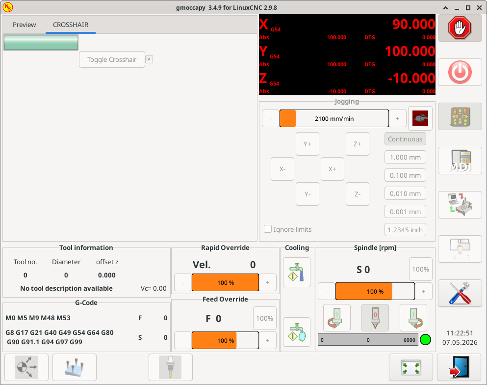

Several errors.
1. A typo. You wrote "EMBED_TAB_HAME = CROSSHAIR" instead of "EMBED_TAB_NAME = CROSSHAIR". Unfortunately you don't get an error because the interpreter just thinks "this value is not for me".
2. you need to define where the VCP should be shown like Aciera mentioned, e.g.
Then you get a meaningful error message
This points out that you used an old glade editor. Saving it with a up-to-date Glade 3 editor (3.40 e.g.) removes this and other obsolete properties.
Then the VCP is displayed:
Further you have a handler "on-changed" defined in your glade (ui) file, but no python file where this handler is defined
EMBED_TAB_LOCATION = ntb_previewThen you get a meaningful error message
gtk-builder-error-quark: crosshair-panel.ui:12:34 Invalid property: HAL_Table.n-rows (11)This points out that you used an old glade editor. Saving it with a up-to-date Glade 3 editor (3.40 e.g.) removes this and other obsolete properties.
AttributeError: Handler on-changed not foundAttachments:

I misspoke. The documentation indicates that if the gladevcp is launched without specifying -x {pid} the panel would be floating. I interpreted that as EMBED_LOCATION was not required. Subsequent testing determined that even if the panel is floating, EMBED_LOCATION must still be defined for the panel to launch correctl.

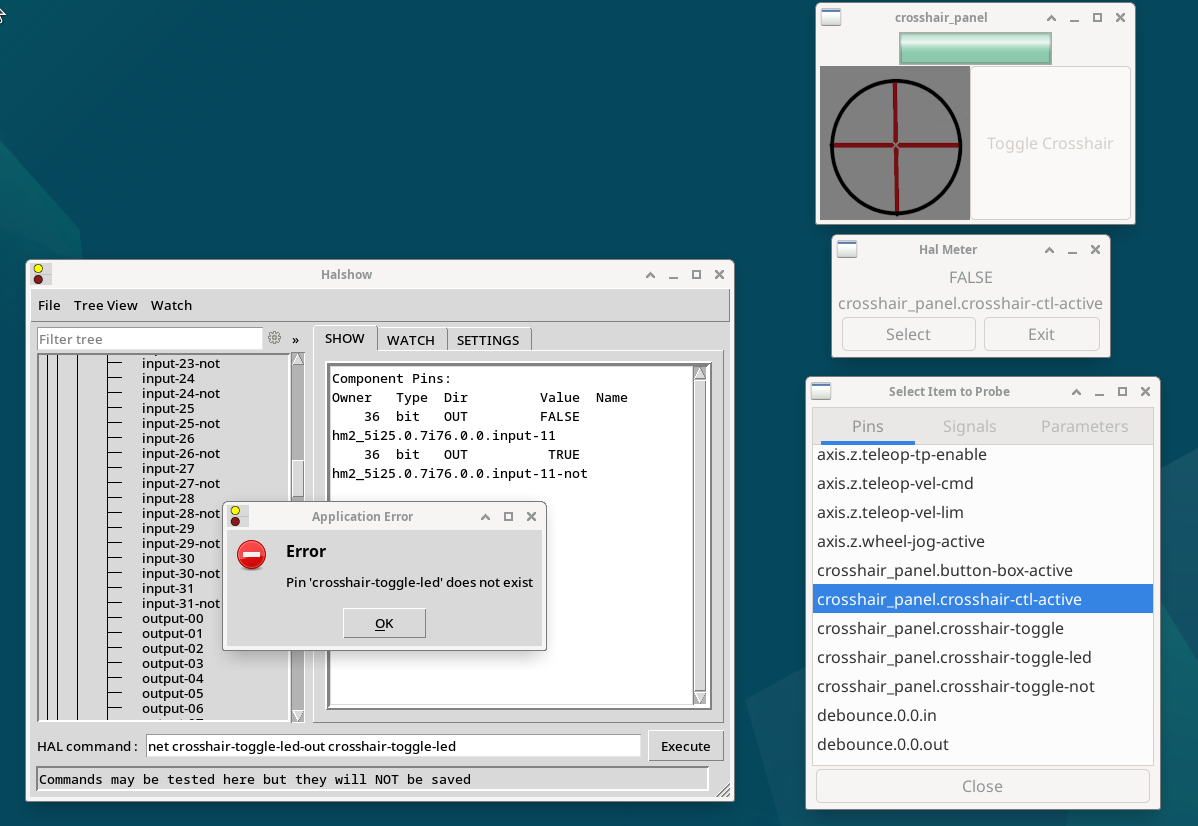

Fixing the my misspelling of EMBED_TAB_NAME, fixed the launch issue. However, I am now struggling with connecting up the panel to HAL.
During the first investigation I discovered that GMOCCAPY does not toggle the motion.machine-is-on signal as with AXIS. A bit of probing with halmeter I was able to determine that halui.machine-is-on is toggled by GMOCCAPY when the machine is on. I edited my crosshair_panel.hal file to use the halui.machine-is-on, but the panel did no respond.
I've done a bit more testing and discovered that halmeter sees the glade pins as expected, however, halscope does not. Therefore, attempting to manually connect the pins via halscope results in a Pin 'xxx' does not exist error.
At this point I'm lost as to why halscope does not see the panel pins and therefore cannot connect them properly.
Any help would be appreciated.
