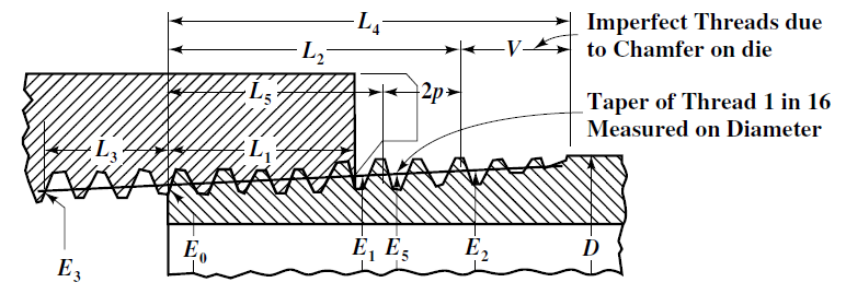

Here's a routine for pipe threading. I'm kind of lazy, so I wrote it where ordinarily all you have to input is the nominal pipe size to use it. Everything else should be OK as is. You can also input the actual pipe size and TPI from Machinery's handbook if you want. For instance, 1/2" pipe is 0.840 OD and 14 TPI.
A few notes:
- the taper on a pipe is 3/4" per foot. For a 1/2" pipe, that's only about 0.030" in diameter change over about 1/2". So it's really important to be accurate when setting up your lathe, or the thread won't be right. There's an input parameter for Tip Radius. If you're having trouble with loose fits, increase this a bit. It makes a big difference, since it makes the cut 2 x Tip Radius larger.

The pipe threading subroutine had a variable to decrement the cut taken that I didn't like that much. It worked OK, but took a lot of fiddling setting the initial cut, minimum cut, and decrement percentage to get a good result. Because of the taper, it was not readily apparent what depth of cut was being made, unless it was so large that it bogged down the lathe. I rewrote it to be automatic, and I think that it works much better now. It now scales the initial cut to the minimum cut based on the percentage of total thread depth that has been taken. Here's the latest version.

I found a small bug in one of the calculations. It was one of those radius/diameter things. Here's the corrected version
Before the correction, the thread was cut slightly too deep. This version makes better fitting threads.

minor error in the above posted subroutine:
o340 if [#<_OutsideDiameter> EQ 2.000]
#<_OutsideDiameter> = 1.375
#<_TPI> = 11.5
o340 endif
outside diameter should be 2.375 not 1.375
