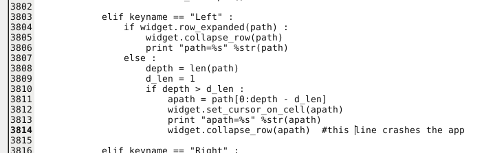

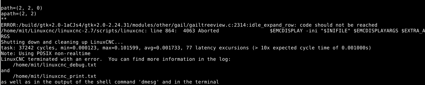

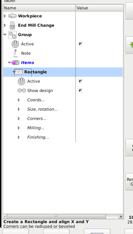

Collapsing a tree with "left" key crashes NativeCAM with this error:
It only crashes when current selection is any kind of "group" feature (standard group, circular or rect array).
ERROR:/build/gtk+2.0-ABXlu1/gtk+2.0-2.24.32/modules/other/gail/gailtreeview.c:2313:idle_expand_row: code should not be reachedIt only crashes when current selection is any kind of "group" feature (standard group, circular or rect array).

Thanks for showing how to reproduce this...
The line that crashes the app does not need to be there since the row is NOT expanded and the first 'if' statement is not executed.
Remove it.
I corrected for a future release.
Regards
Fern
Remove it.
Regards
Fern

30 Dec 2019 17:16 #153555
by FernV
Replied by FernV on topic Bug in ncam.py
I think this is even better, try it
Fern
elif keyname == "Left" :
if not widget.row_expanded(path) and len(path) > 1 :
widget.set_cursor_on_cell(path[0:len(path) - 1])
widget.collapse_row(path)Fern
