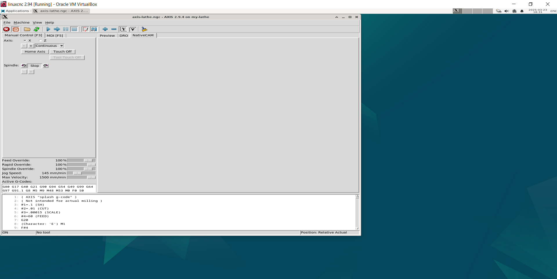

- Becksvill
- Posts: 224
- Thank you received: 115
23 Mar 2025 03:46 #324610
by Becksvill
Replied by Becksvill on topic NativeCam on LinuxCNC 2.9.3
hey Giovanni
did you use virtual box for your VM
i am about to try your guide again using virtual box and a stock standard linuxcnc iso 2.93 install
just thinking i could just grab your vm file and work back from there if you used virtual box
cheers
Andrew
cheers
Andrew
- Becksvill
- Posts: 224
23 Mar 2025 05:31 - 23 Mar 2025 05:34 #324619
by Becksvill
Last edit: 23 Mar 2025 05:34 by Becksvill. Reason: fixing photos
- HansU
- Posts: 723
- Thank you received: 217
23 Mar 2025 08:15 #324636
by HansU
Replied by HansU on topic NativeCam on LinuxCNC 2.9.3
Please run LinuxCNC from the command line, then we will probably see what the error is
