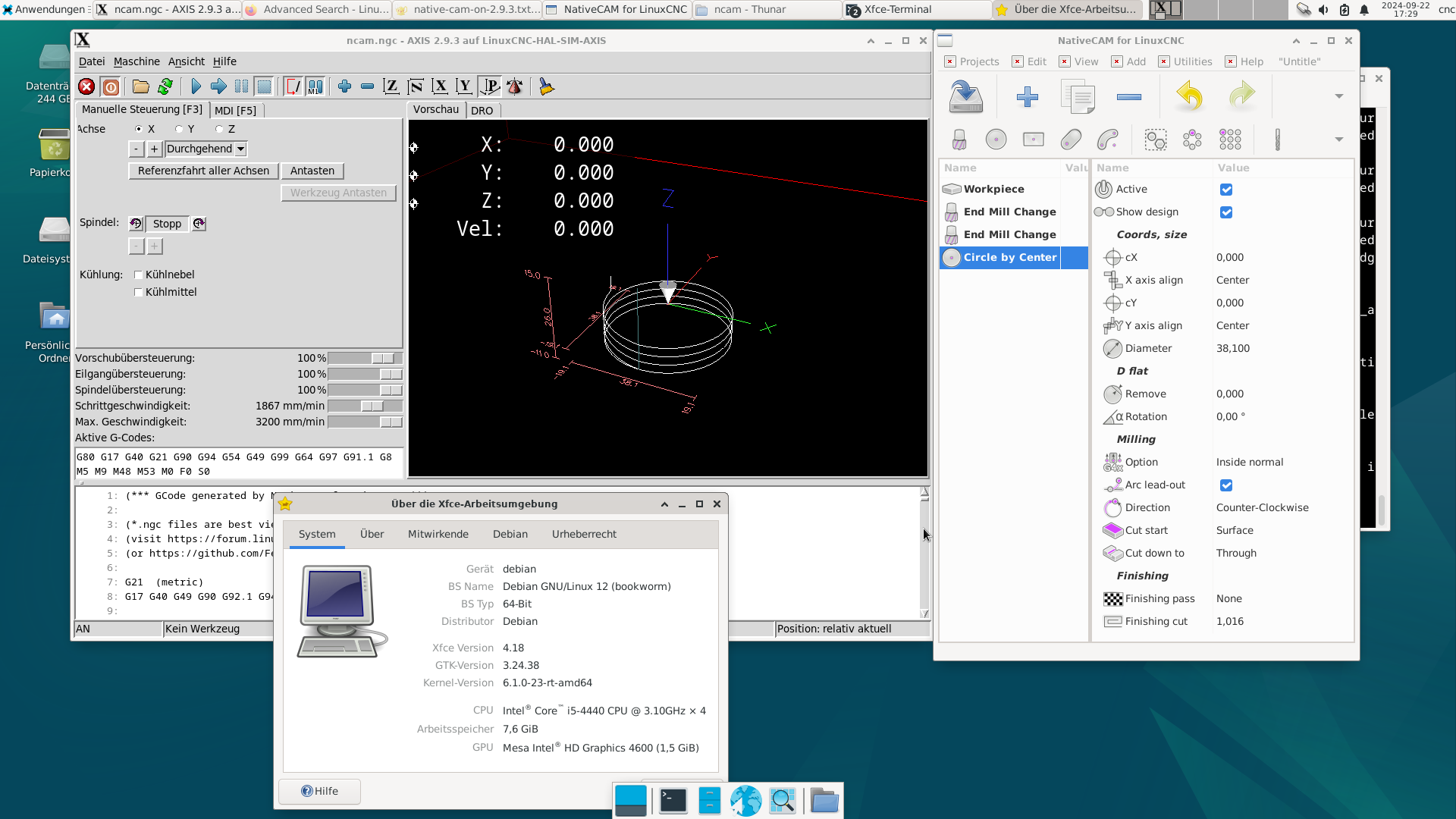

29 Sep 2024 09:34 #311017
by Giovanni
Replied by Giovanni on topic NativeCam on LinuxCNC 2.9.3
Here is a more stable version (in my opinion).
But the calculation problem is still there (on my computer).

30 Sep 2024 17:22 #311080
by freemoore
Replied by freemoore on topic NativeCam on LinuxCNC 2.9.3
Hello all,
It's good to see you working on NativeCAM, I use it all the time and have got to the point where I need to update to lcnc 2.9.x and the lack of ncam is the main problem.
I followed juergen-home's instructions with a couple of changes:
step 3. copied to /home/freemoore/linuxcnc/ncam/
step 4. open console in /home/freemoore/linuxcnc/ncam/NativeCAM-master
step 5. sudo bash ncam_debsetup.txt
python3 ncam.py --ini=/home/freemoore/linuxcnc/configs/sim.axis.vismach.5axis.table-rotary-tilting/xyzbc-trt.ini --catalog=mill
After this I have run each further step down to 14 and reproduced the errors and results in Juergen's post, but without getting tool library to appear in ncam.
Next I copied Giovanni's ncam.py from above in place of the one in Bogdan's download.
I still don't have a tool library, but this is outputting a program to the simulated 5-axis machine config of lcnc that I've set it up with here. And the program is running OK.
Not sure I know what would be useful to you but I'm happy to test new versions of your code here!
great to see the familiar ncam on a 2.9 installation, it gives me hope
cheers, Andy
cheers, Andy
